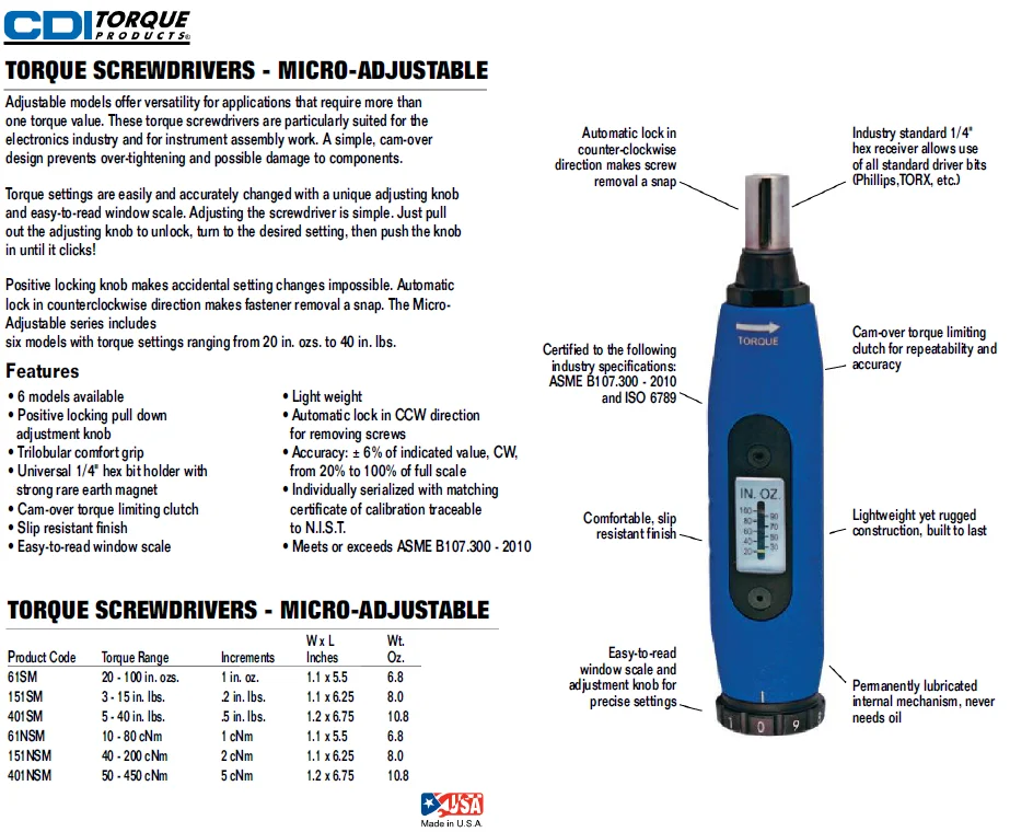

That one is close to meeting your torque range needs and is relatively inexpensive. It's range is 15-70 in-lb. That one seems to be only available through Brownell's, although they show a metric-only version in their catalog (TLA28NM). Here's a snip from their current catalog showing current adjustable torque screwdriver offerings:

Wow I just looked at the price of the 410SM. $428 I guess there will not be one in my toolbox anytime soon.
You didn't look in the right place (or, if you did look for 410SM, who knows what you found - it's a 401SM):
https://www.amazon.com/dp/B001F7VJIO/?tag=wranglerorg-20
Still not cheap, but quality torque wrenches cost more...
Also, the one I recommended from Brownell's is about $50.
Hope that helps!
Very helpful, thanks for the post. I might give one of the CDI micro adjustable ones a shot. Might end trying the 3-15inlb one. I was doing some testing with a small torque wrench at work and I was probably overestimating how much torque I thought I was using. Guess you can't get too much with a thumb on the short end of a 2mm Allen key lol.
I wish the 6% accuracy was a bit better, but that'll probably be fine. I probably don't so much as need accuracy as I do repeatability, even if it repeats slightly off.
I found a fancy digital one with +/- .5%, but it was $800...
Going to keep looking for a bit, but I've had good experiences with CDI in the past, and they're catalog even shows someone torquing an insert screw in a face mill, perfect lol.

Yes 401SM 5-50. I went to the web site and used it to go to their local dealer. Probably full list price. Very niche tool and thankfully I will never need one.
