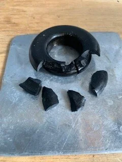

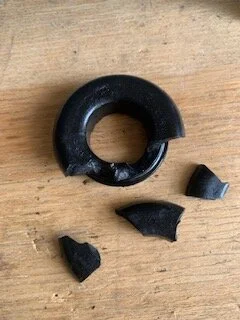

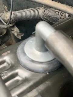

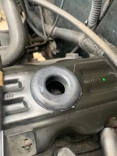

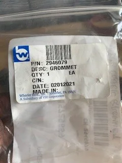

Just did that job a couple days ago...
You do not need to pull the valve cover...
Use an exacto knife or similar thin blade, cut the grommet, lubricate the inside area where the PVC fitting is inserted and rock the fitting gently and it will come out. Remove the grommet, clean the surface, install the new grommet, apply a little oil or grease and insert the PVC fittings. The one with the orifice goes into the rear of the valve cover.
View attachment 272910View attachment 272911View attachment 272912View attachment 272913View attachment 272914View attachment 272916
With a renewed confidence, I attacked the PCV again and managed to coax it out. Thanks, and thanks to all who responded.
