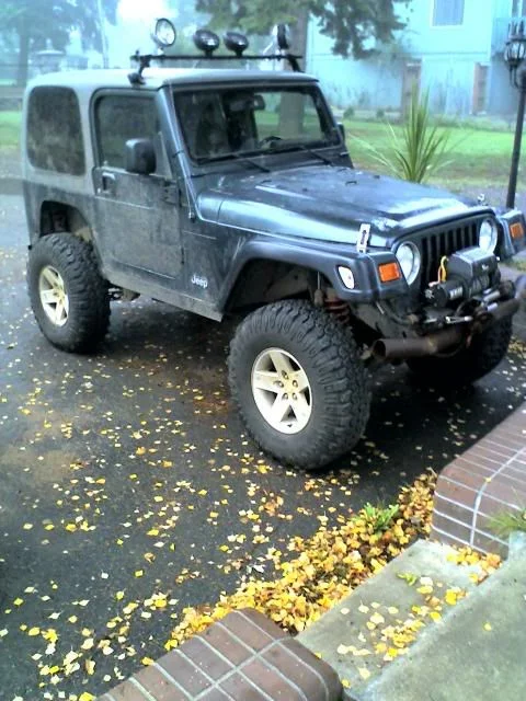

Dave Kishpaugh from Jeepwest has tried his hand at this in the past. Ignore the tires, just look at the fenders in the photo below.
Ill be doing a DIY highline here in the future. I fully plan to cut, splice and have a body shop weld the fenders and repaint. I ran the MC fenders on my previous and while is nice, I love the OEM Highline look. Something like what this guy did
