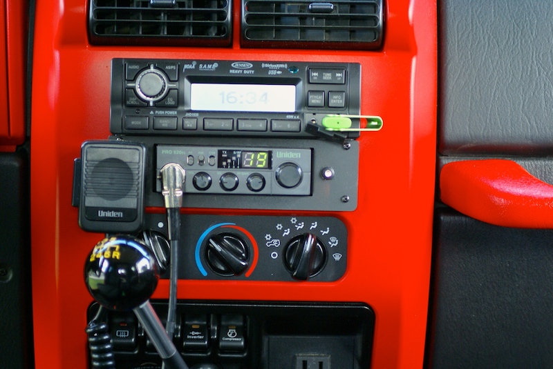

Jensen "rugged". A good quality pot will last for many years, but I think these have a digital. In any event, very rugged, bombproof car stereo. Available with and without a CD player. Mine doesn't do bluetooth, but they make them that do.
Thanks. Yes it’s looking like Jensen has “heavy duty” models. A little pricey, but should hold up a lot better. Some even use button volume controls rather than a failure-prone knob. High chance I get one of these
I personally detest button volume controls (and tuning!), but even those beat a touch screen.
Ok - I just went out and checked mine - it *IS* a rotary controller, not a pot, so it should be GTG.
