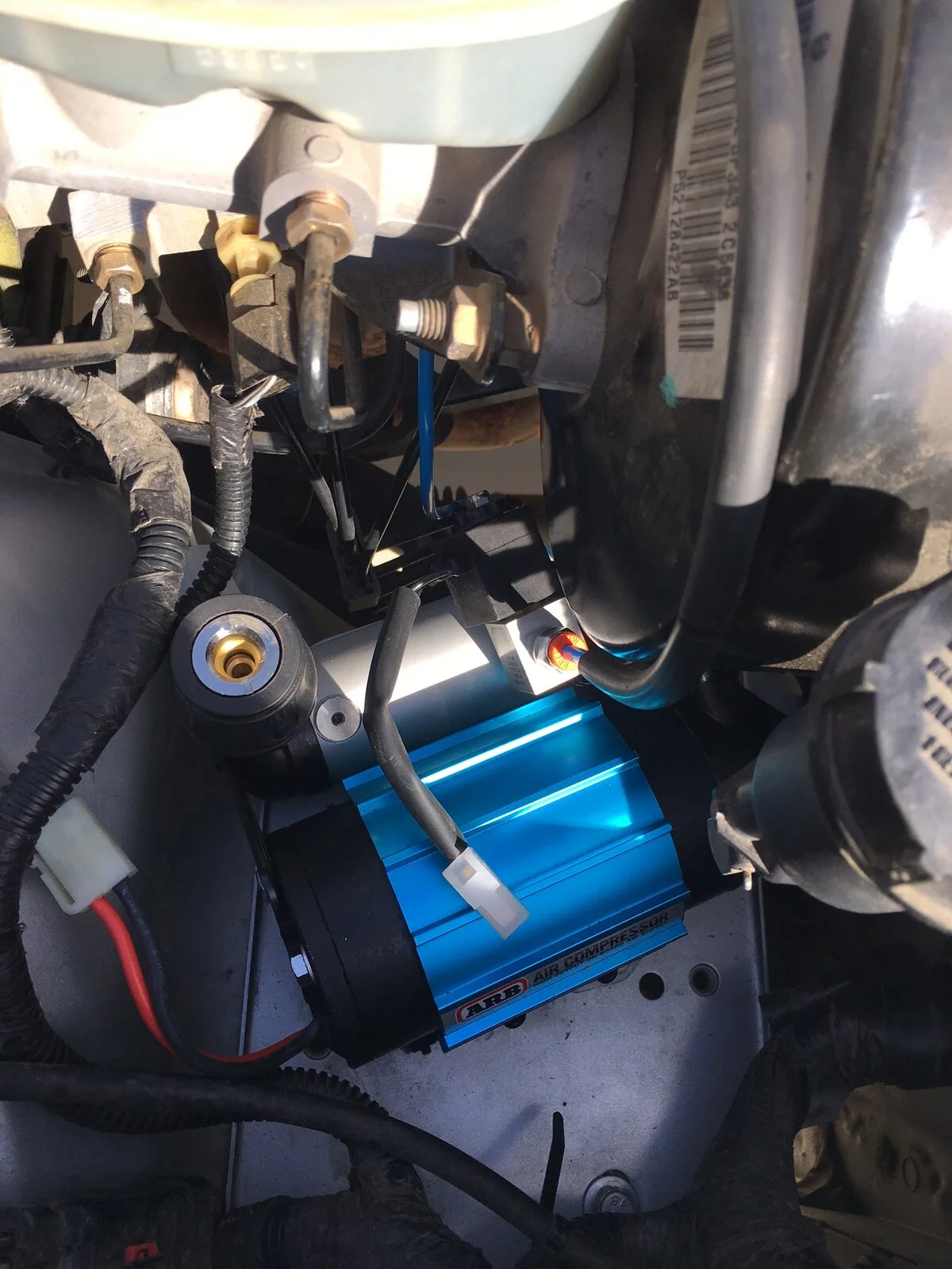

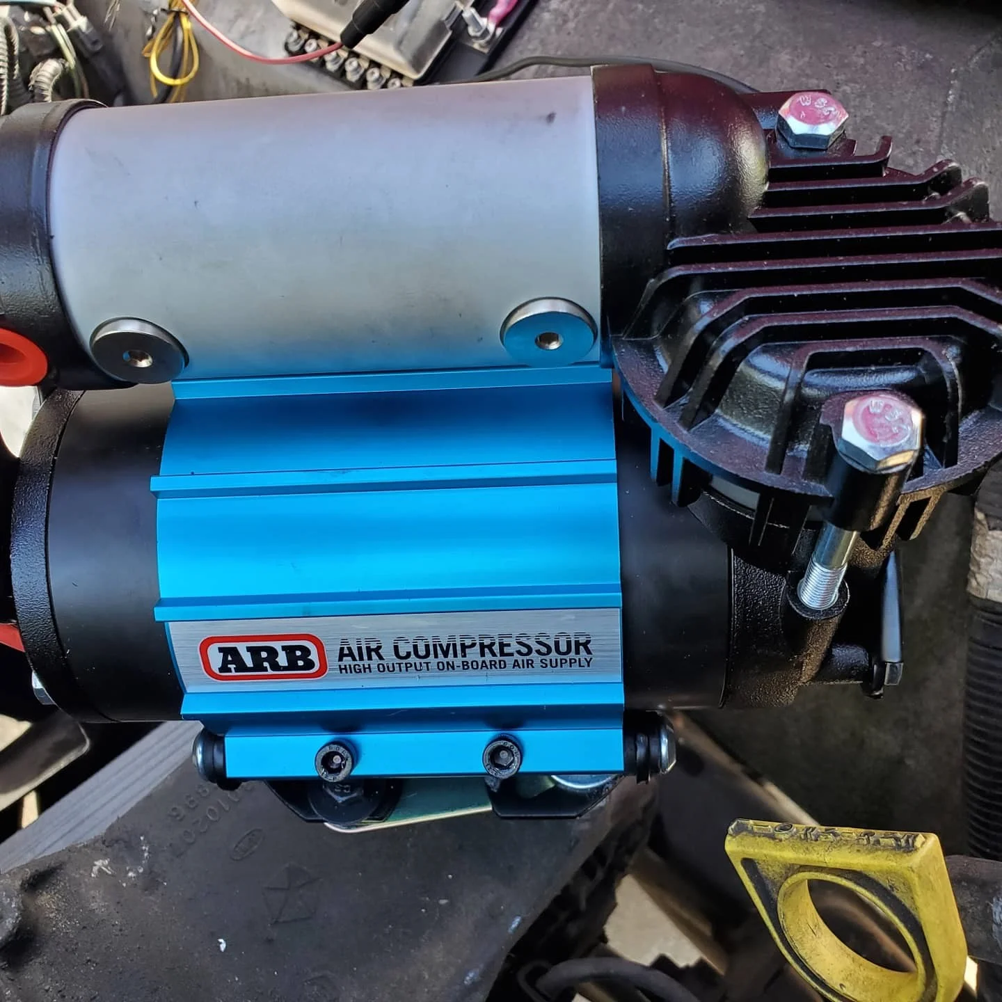

A lot of people use the Viair. However, I wanted something in the Jeep at all times. Space is limited in a TJ of course. It’s also there for my rear locker. I really like the ARB. It’s not a speed demon. But, I have no complaints with its speed. It’s about 5 pounds a minute. I have the same brand, size and model tire as you. I installed it on the tray that would have been for antilock brakes if I had them. I’m very happy with it.

I like my ARB. Needed something for my rear locker anyway so decided to wire it up for trail duty as well.

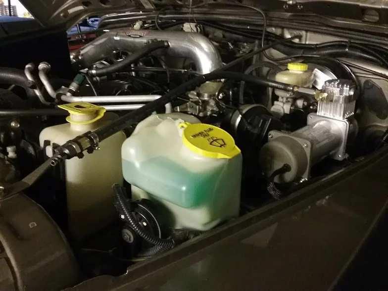

I have a Viair 400H mounted in my LJ:

https://wranglertjforum.com/threads/how-to-simple-onboard-air-for-your-tj-viair-400h.10235/

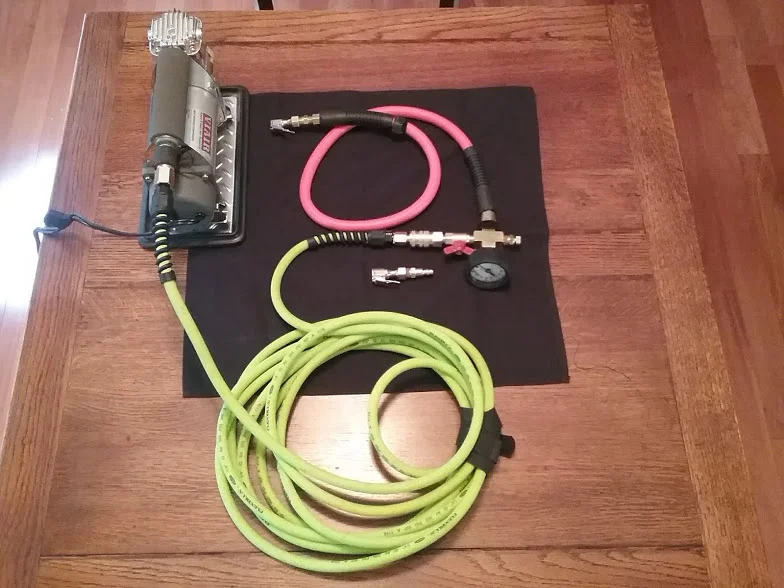

I also own a Viair 400P portable kit that I have used for several years on other rigs.

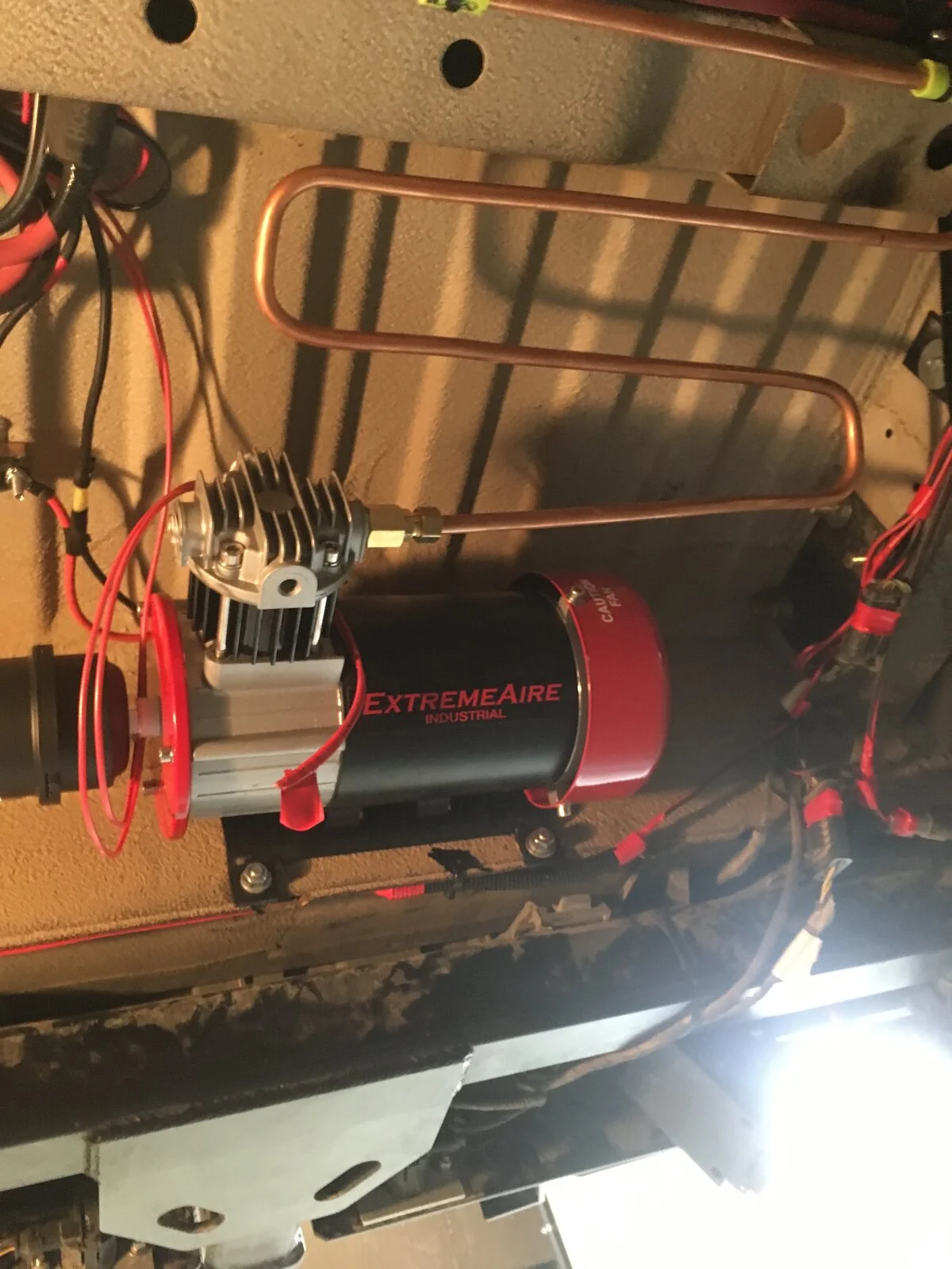

If one has the room, and the budget, the ExtremeAire High Output is also a good unit. I have one hard mounted underneath my Sprinter.
https://www.extremeoutback.com/product/extremeaire-high-output-12-volt-compressor/
