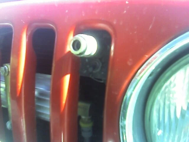

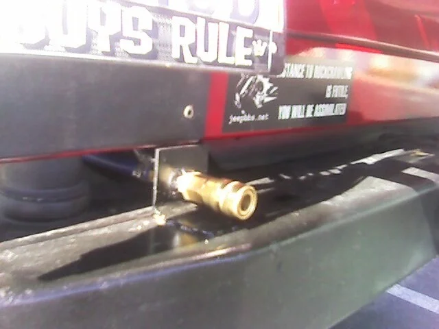

This is where I installed my OBA's quick disconnects on my previous TJ, they worked well in those locations. That's my OBA system's on-off switch under the quick connect in the first photo.
Reactions: tomtaylz and Bogman
