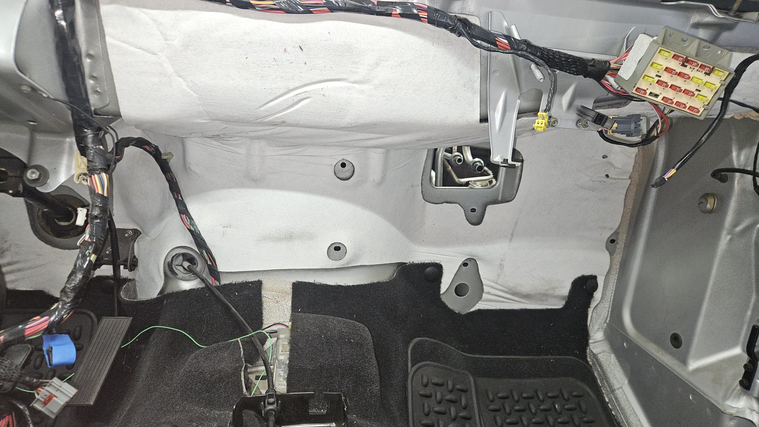

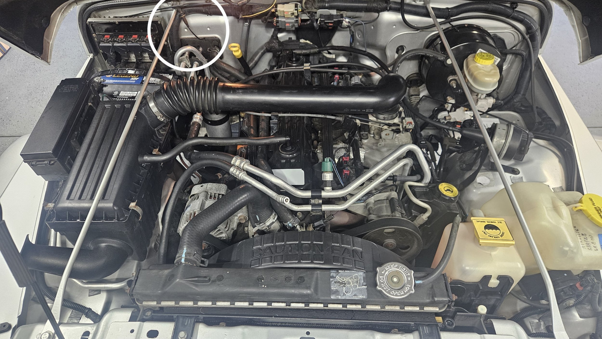

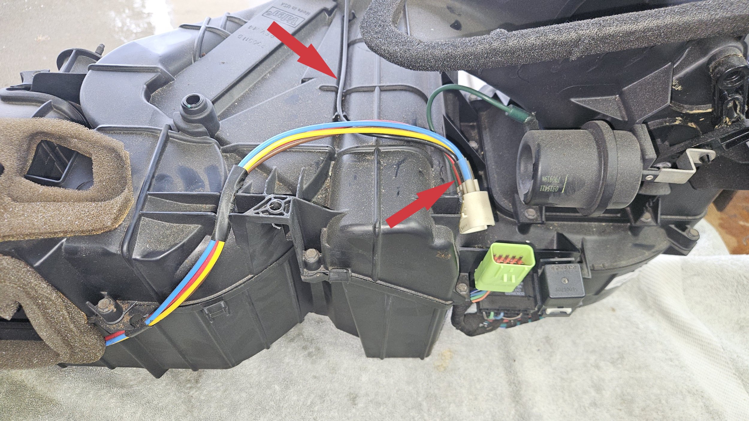

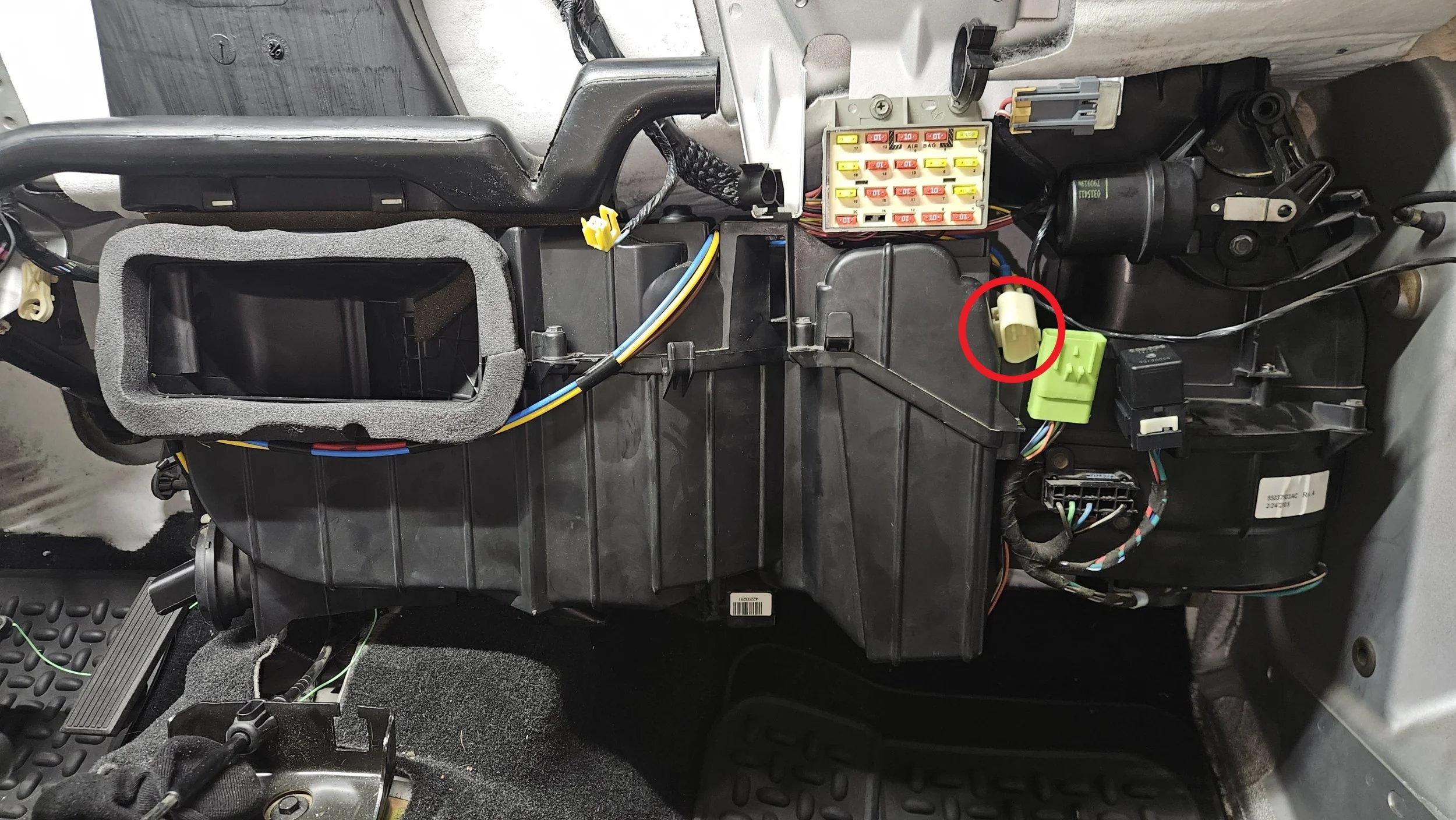

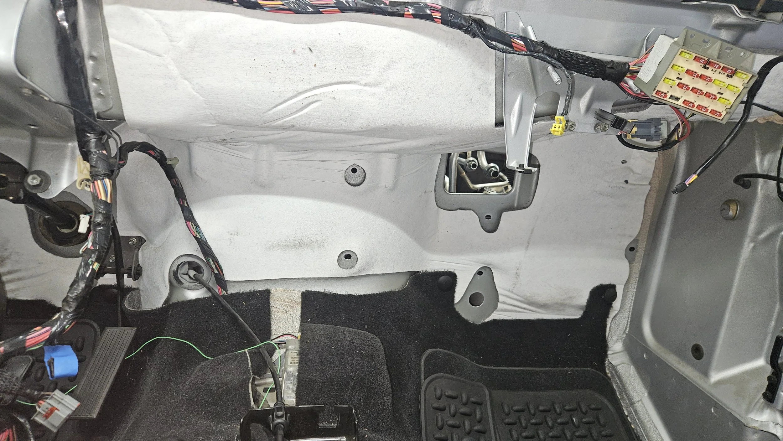

I cant reach the hole in the firewall from inside with the dash in. I can get my finger on the line just cant get a grip on it. I plugged the broke line from the T under the hood with electricle tape. Everything seems fine except ac and heat only blow out the defrost. If it dont stumble, grumble or stall I'm good with it for know.
could you fish a coat hanger in there and tape the new rubber hose to it and pull it through ?
