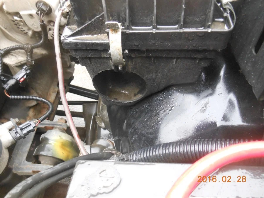

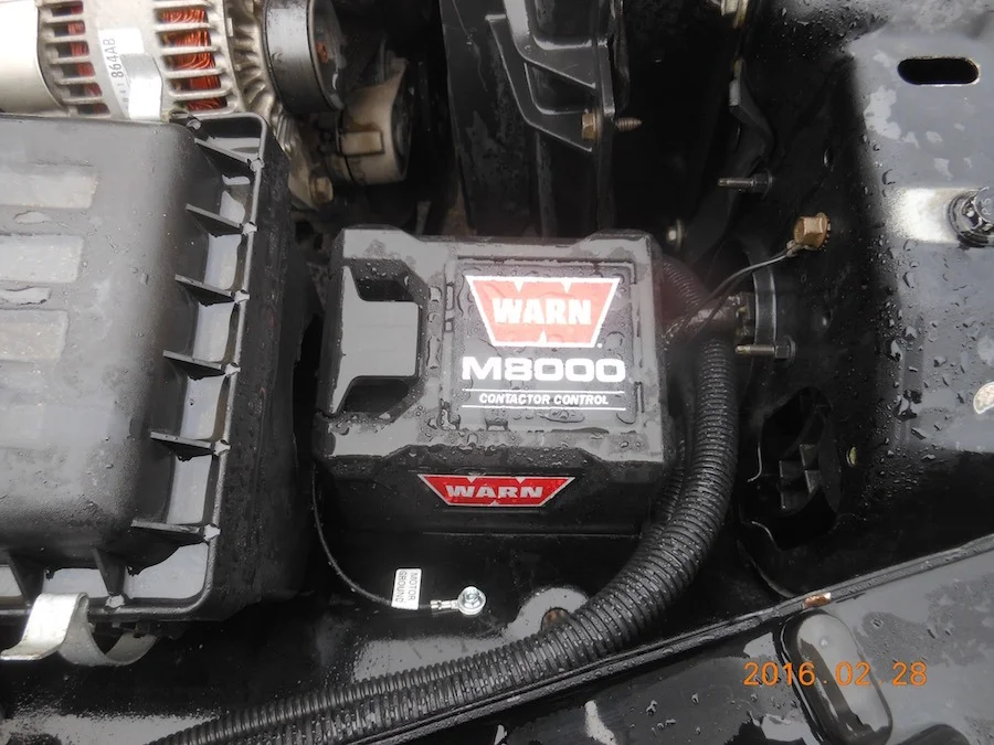

I needed space for my winch solenoid. I just cut a hole in the box back without moving it. Still have to add a bit of plumbing.
