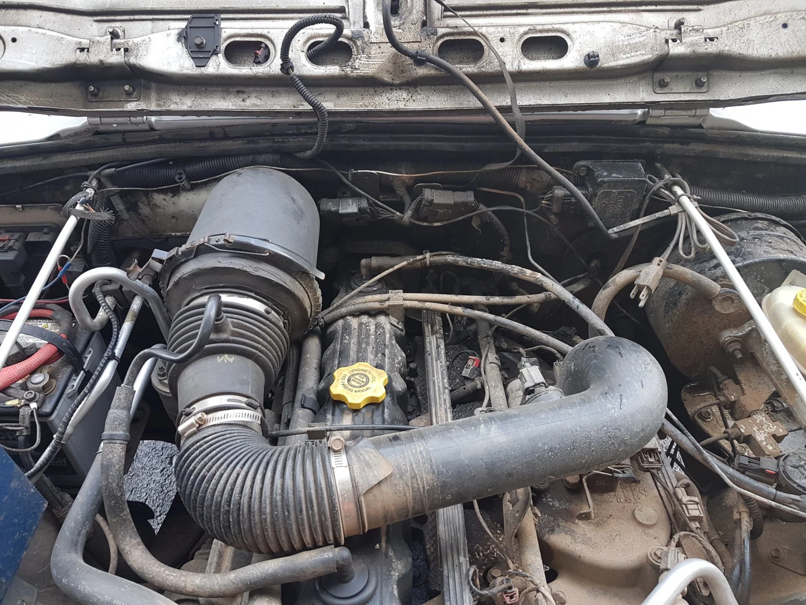

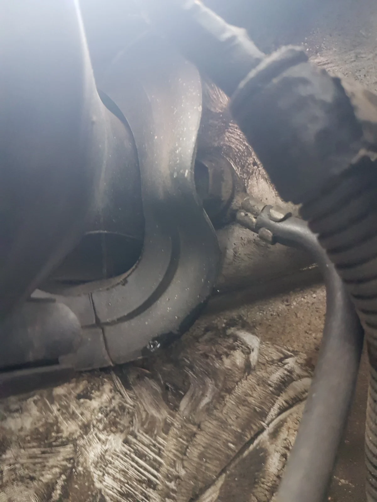

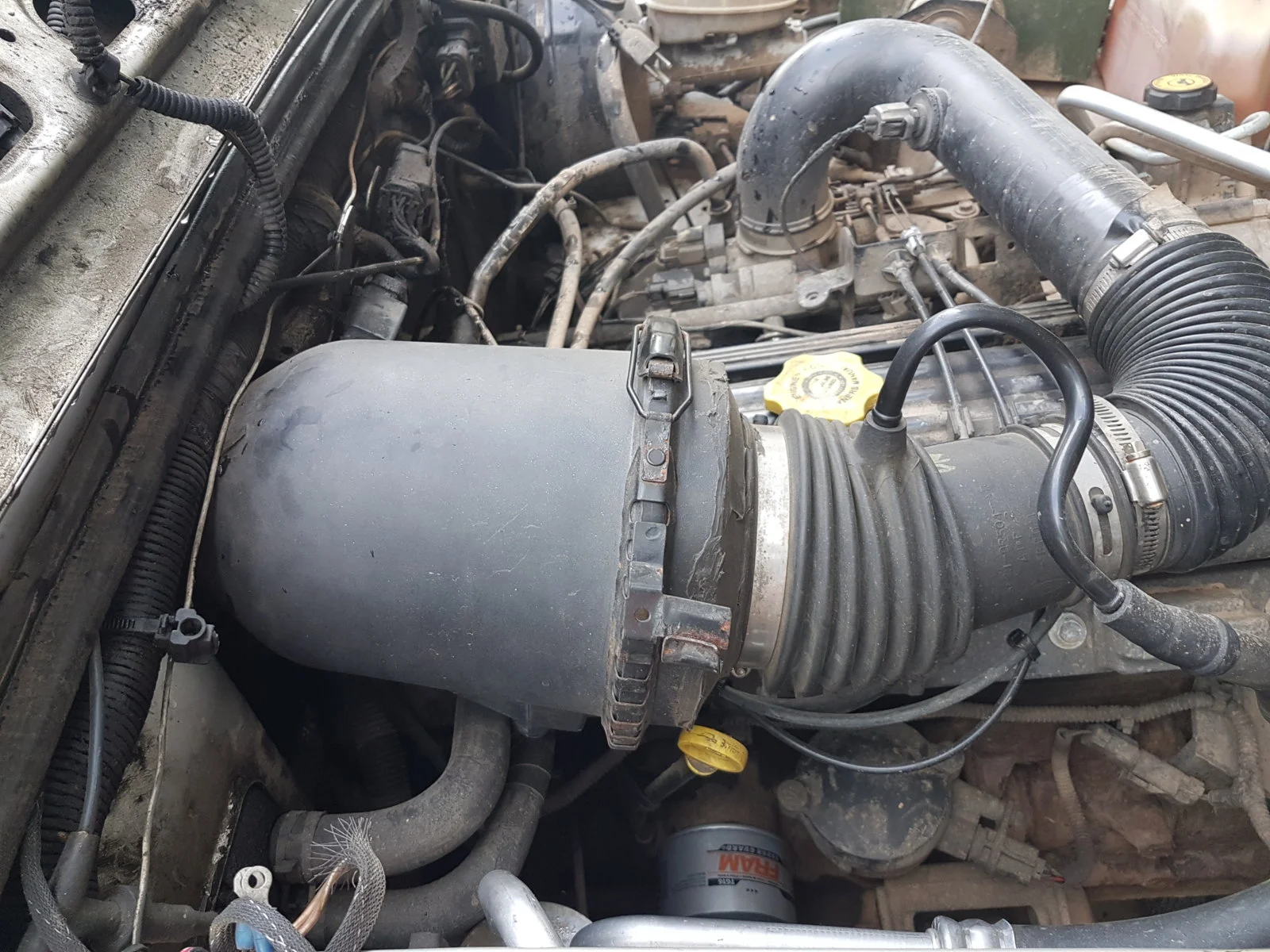

Google Ford Windstar cowl intake. That's what I have on my Jeep, and you can see it in my build thread. I'd link to it, but too hard on my phone.

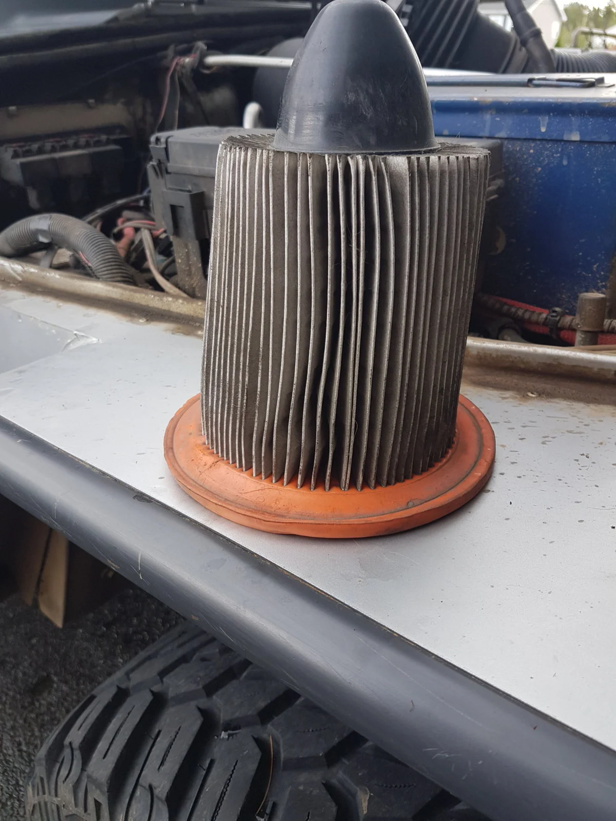

Yep, time for a new filter I think.

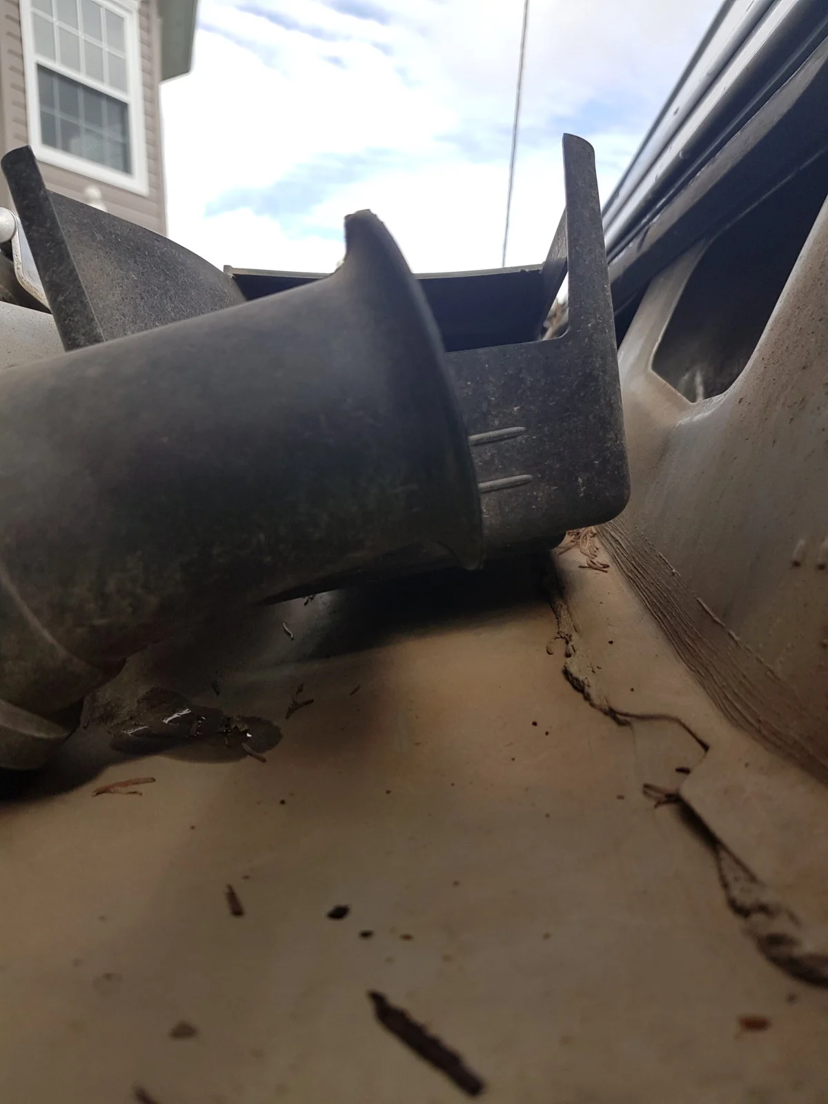

The left side where it goes through the firewall.
The right side where it goes through the firewall.

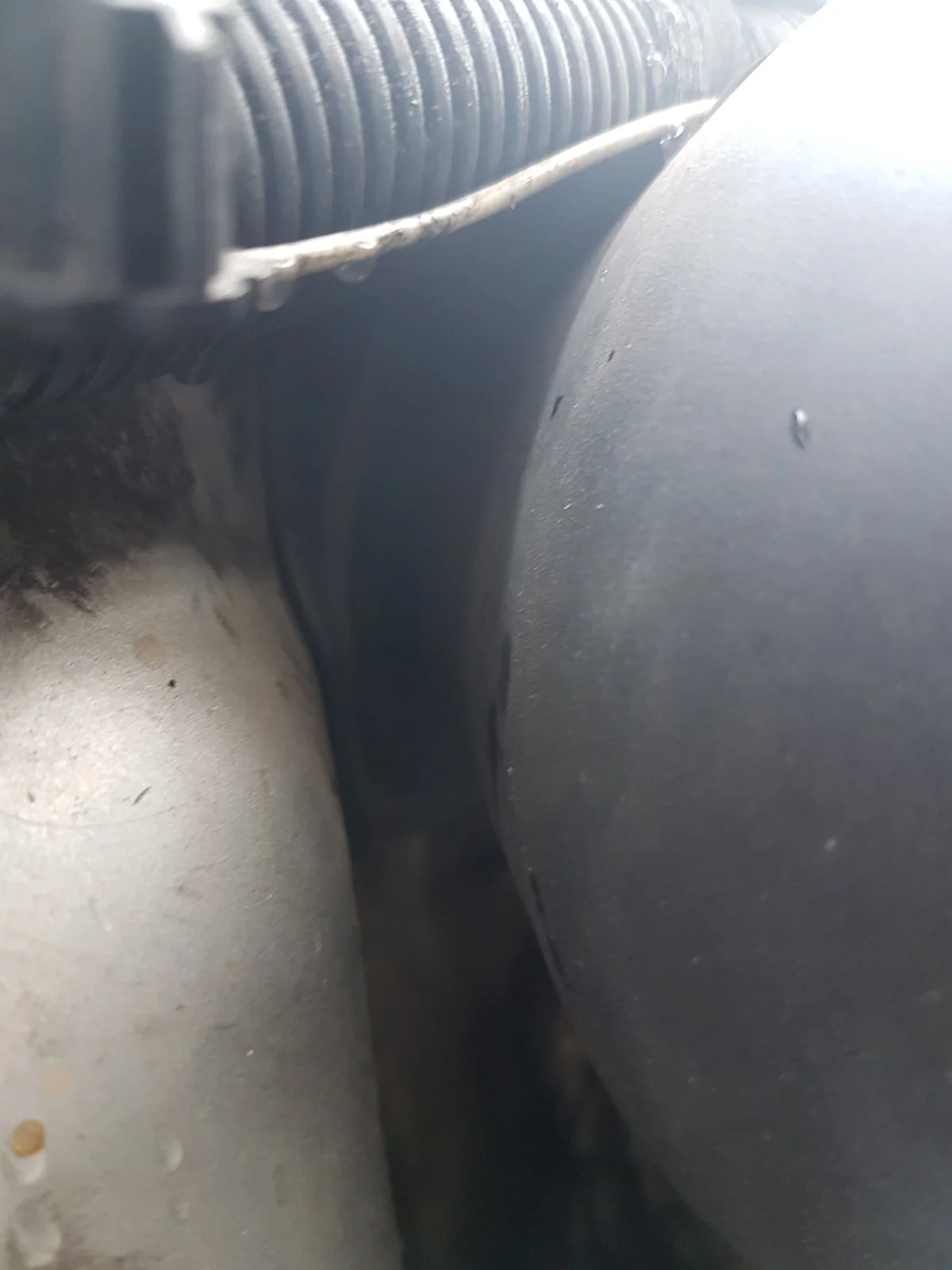

The whole thing.

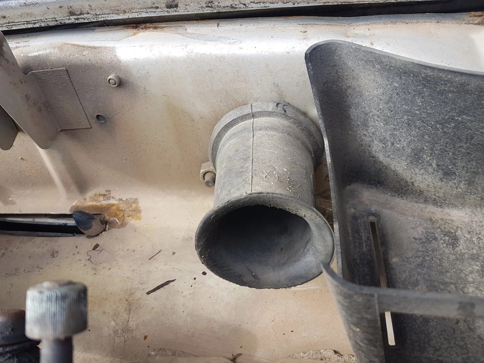

Where the cone goes through the firewall and into the cowl. There's a good distance between the bottom of the cone, and the bottom of the cowl.

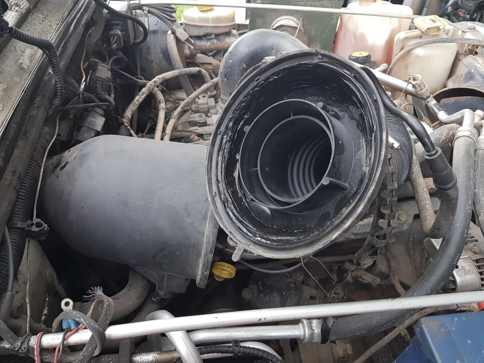

Where the filter goes.
Another look at the cone.
In case you're wondering if the cowl drain can keep up with draining water.
