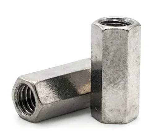

I assume there aren't any options that adjustable but that don't disconnect. Like the JKS rear links...
Make your own out of stock ones.
