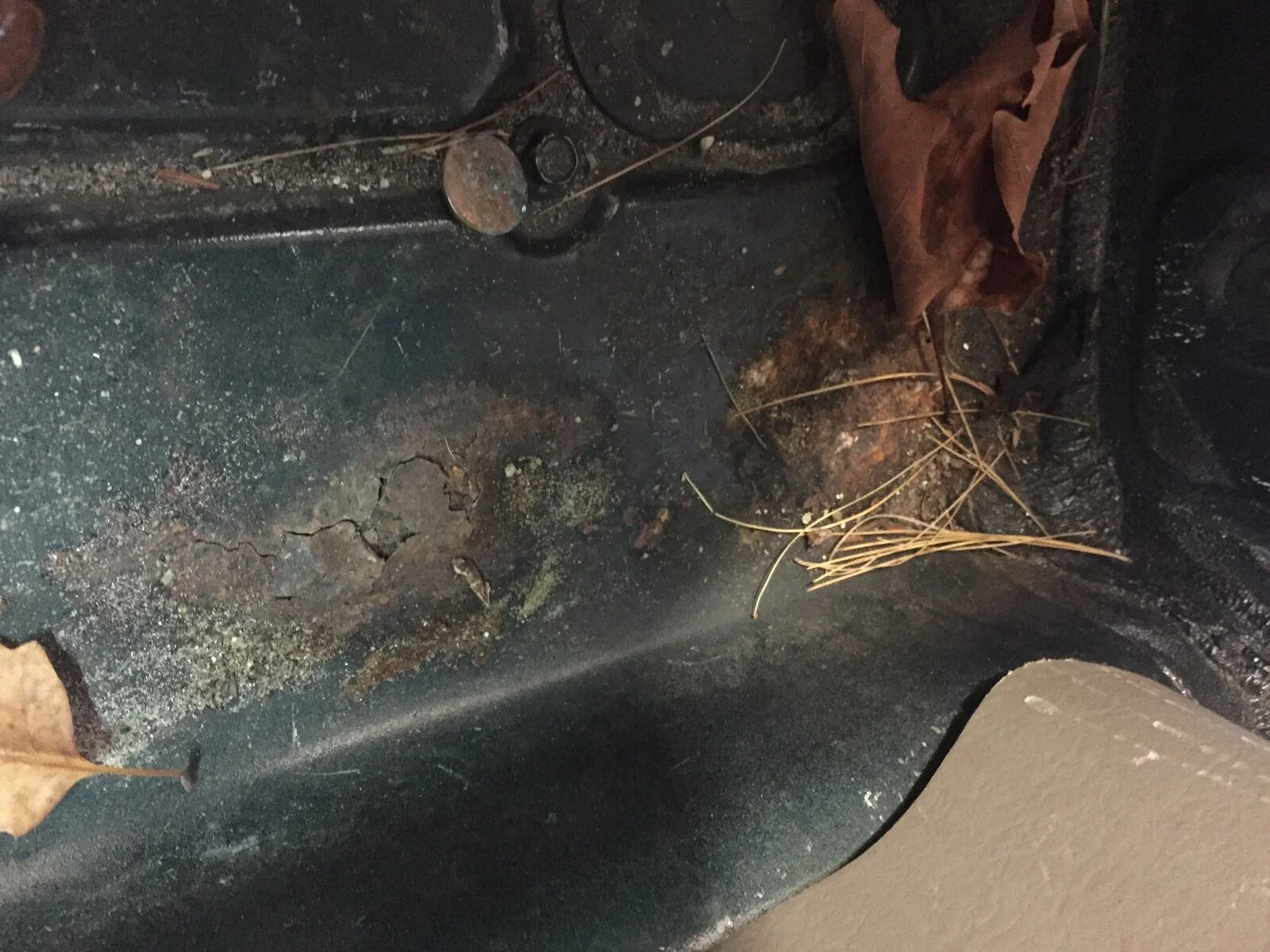

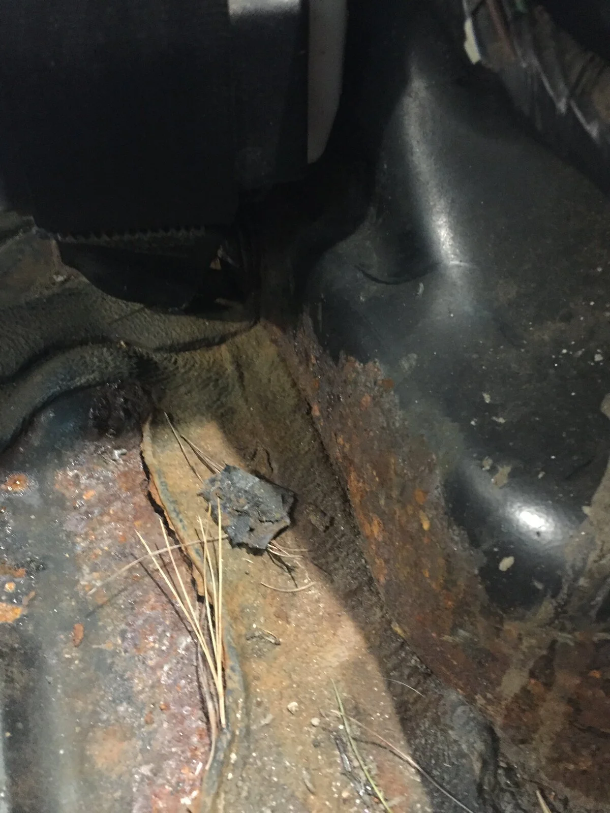

Fronts are junk but the rear is good other than a couple of spots, I’ll just do small patches there.
Ordered floor pans, but they weren’t OEM design and are useless!
Reordered the OEM style and once they come in I’ll weld em up.

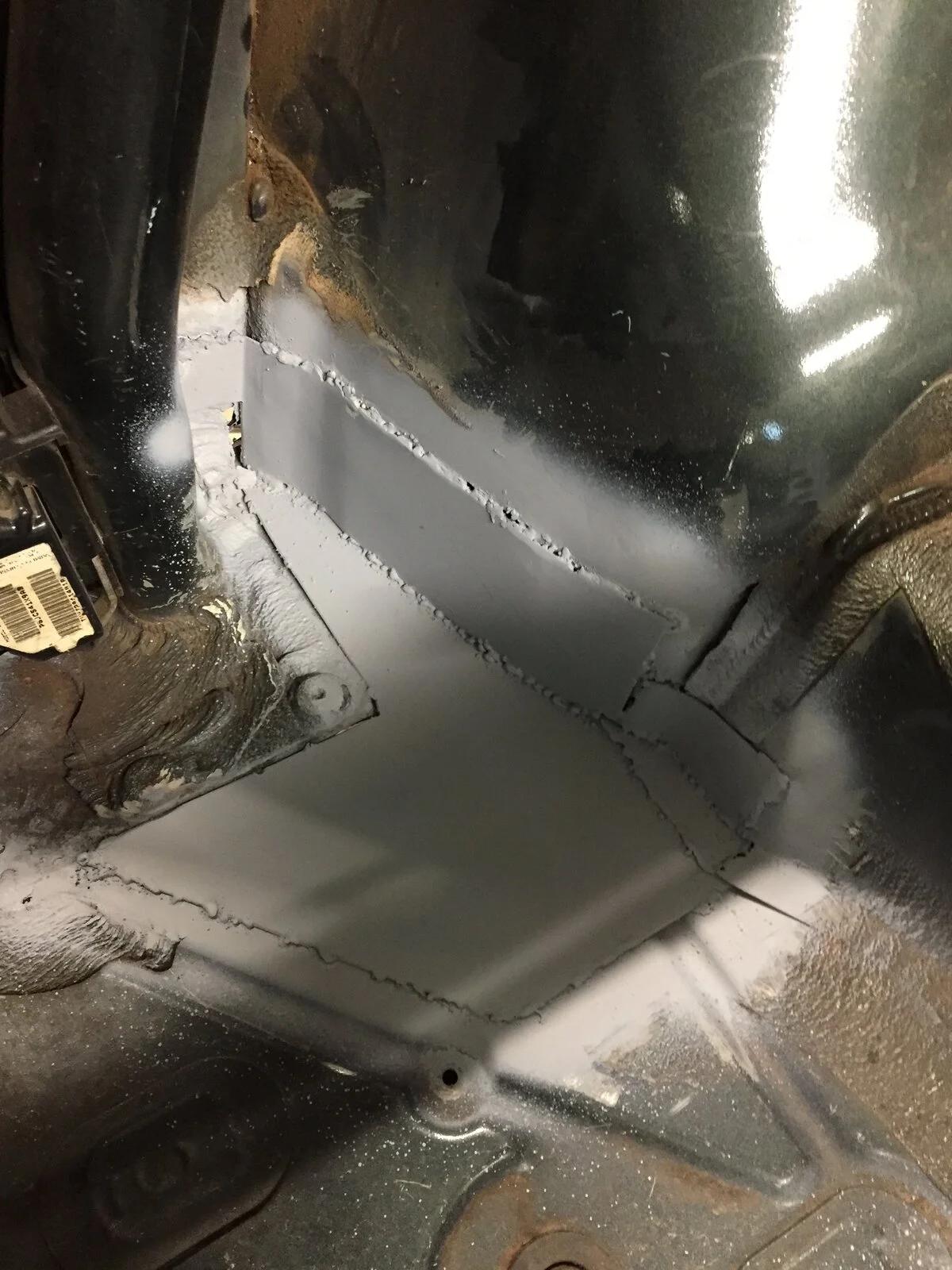

Had to patch one small 9” section of the passenger torque box, but overall not bad so far...

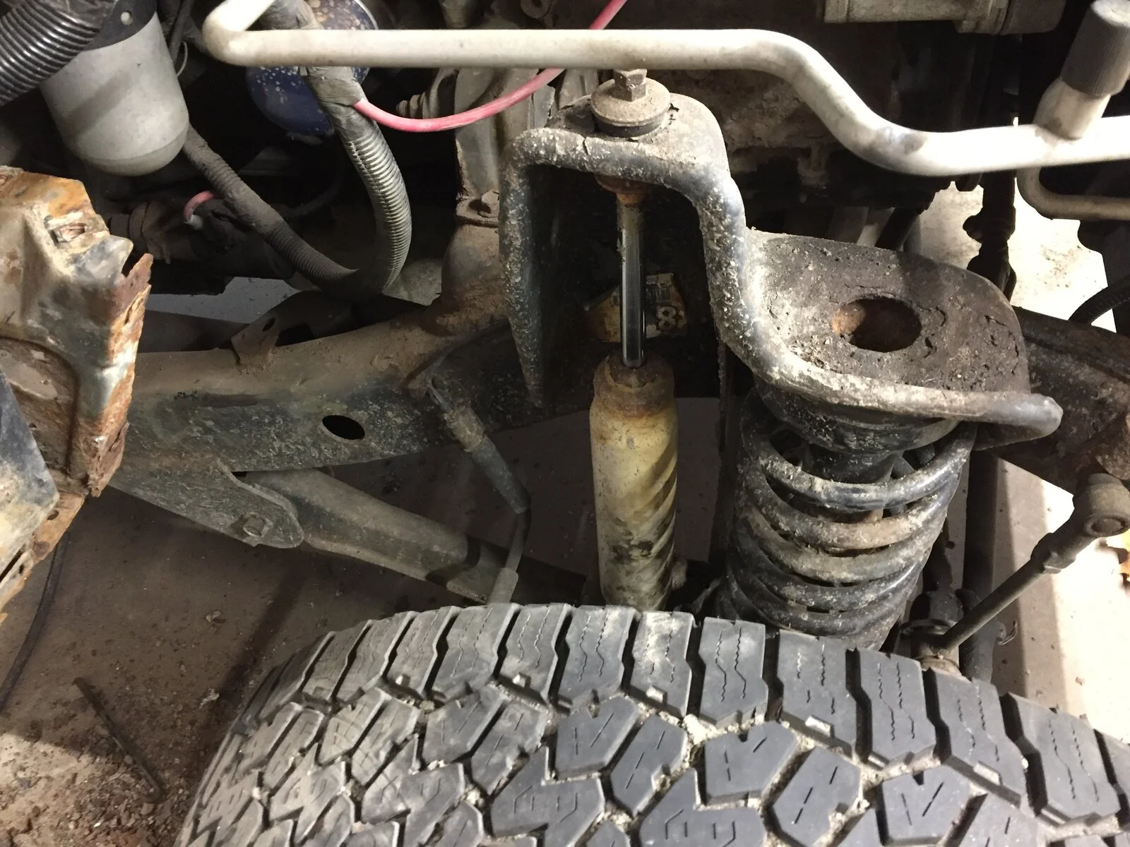

Luckily, the frame is solid and only a bit of surface rust... it was taken pretty good care of thankfully!

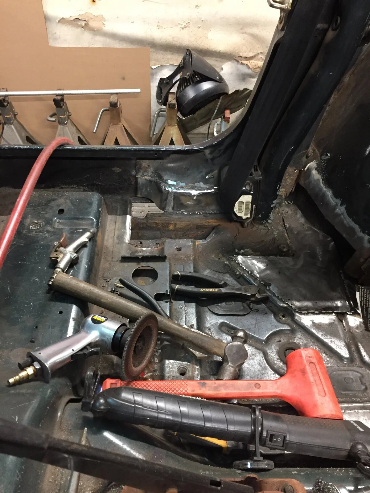

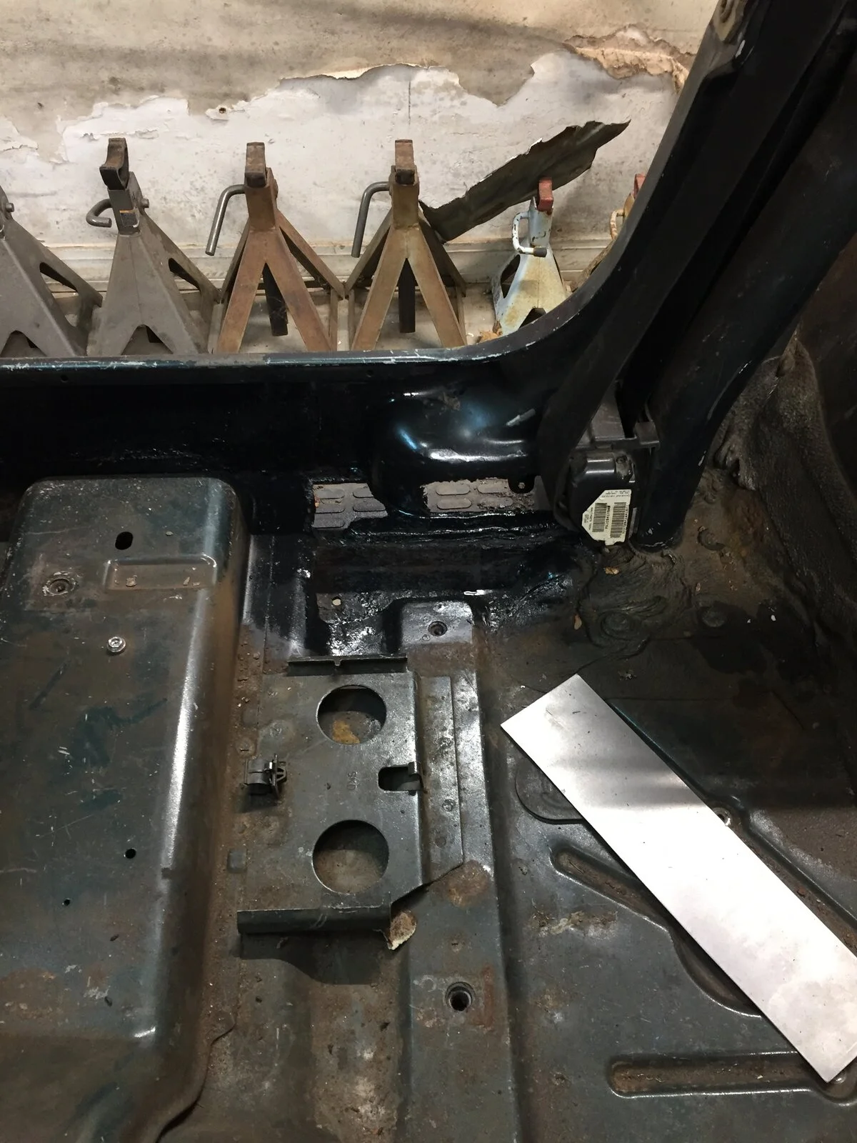

Im almost done with the passenger side of bodywork LOL

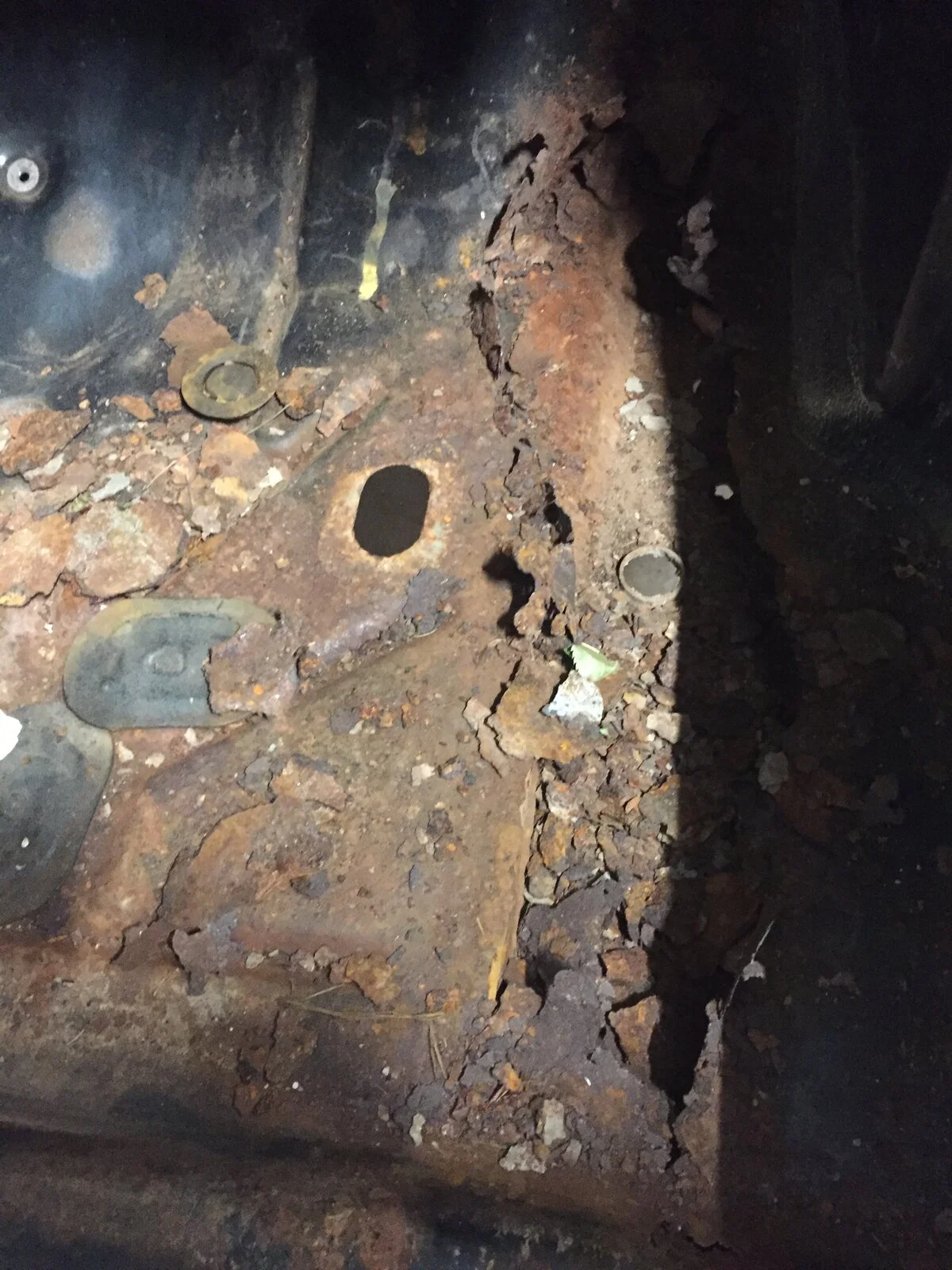

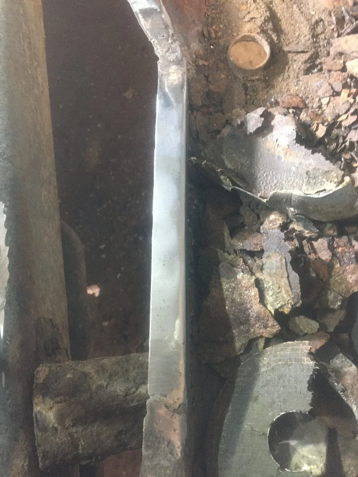

got all of the oddball patches done on the rear floor, which was a can of worms... as soon as I thought I had all the rot, more popped up.
Think the seam sealer did more harm to than good!
A couple of small gaps I’ll fill in, but even thought the welds are FUGLY they are strong.
Got my passenger rocker done as well.
Just gotta get the front pan in and I’m done with this side!

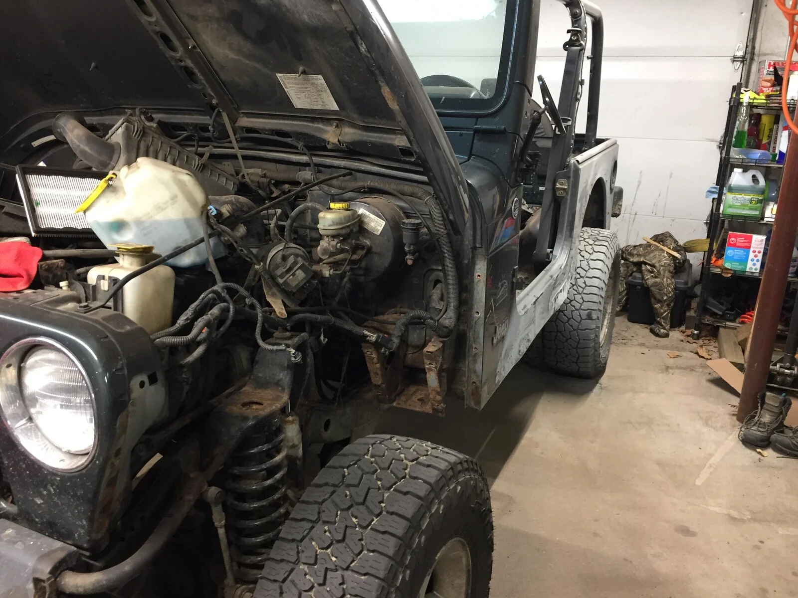

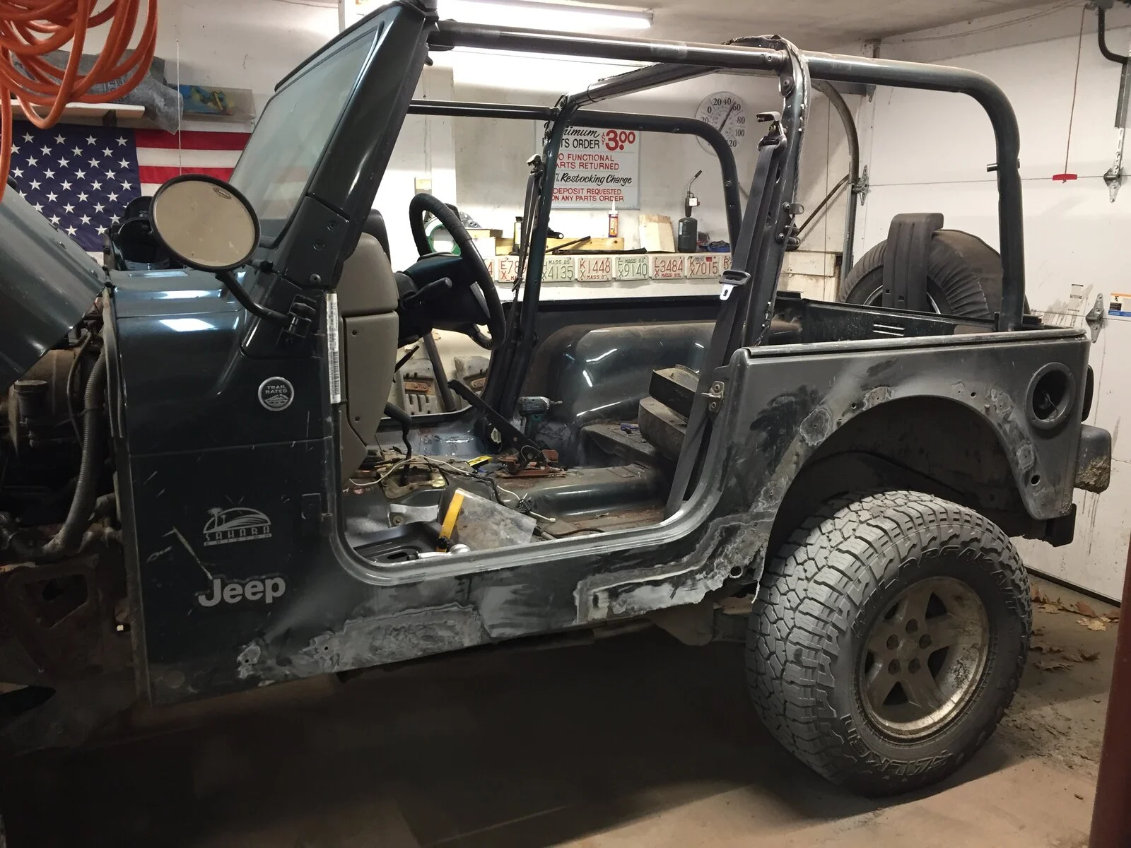

Old ratty fenders came off yesterday, only broke 2 bolts! Hahahaaa
Front of the frame looks awesome, very little surface rust and NO rot 👍🏻
Moving right along 😃

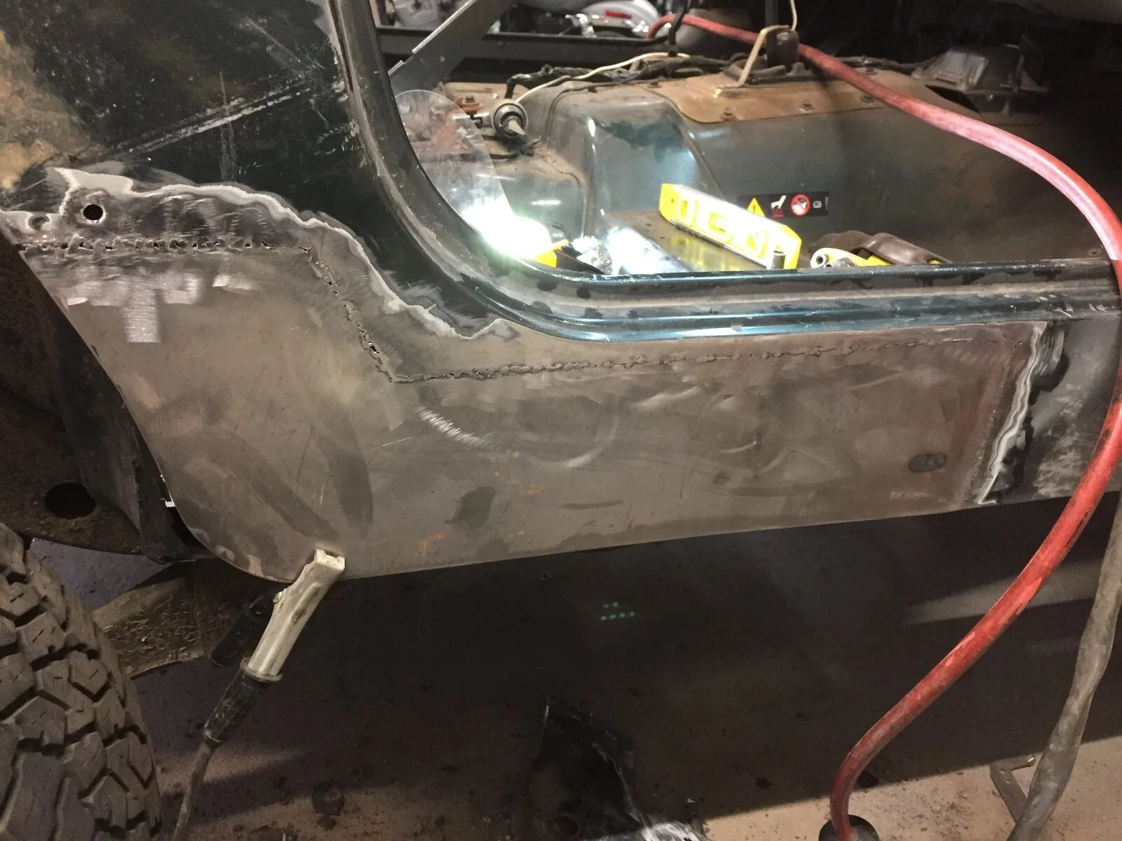

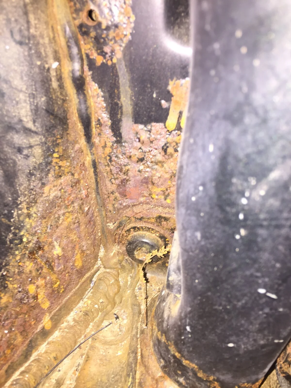

So same rot on the rocker as the passenger side, maybe a little more LOL!
Some idiot just bondo’d over it long ago instead of cutting it out... arghhh
I’ll get that done and then on to the passenger middle body mount patch, then some wire wheeling, painting and back together for final interior/exterior color.
