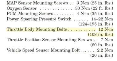

A few days ago, we went through some “deep” puddles (probably came up to the sliders) and after that I’ve been having a high idle (anywhere from 1,500-2,250) and I can’t figure out why it’s still persisting. I did a lot of searching on the forums and I took my entire throttle body assembly off and cleaned it including the IAC. They were both filthy so they definitely needed a cleaning. I even took the TPS off and cleaned everything out of there but it wasn’t dirty, especially in comparison to the IAC/TB. After cleaning the IAC out I left the intake off and did what @Jerry Bransford recommends and sprayed throttle body cleaner into the IAC inlet as well to ensure it was properly cleaned out. I couldn’t disassemble the entire IAC housing so I figured I’d go that route instead.
