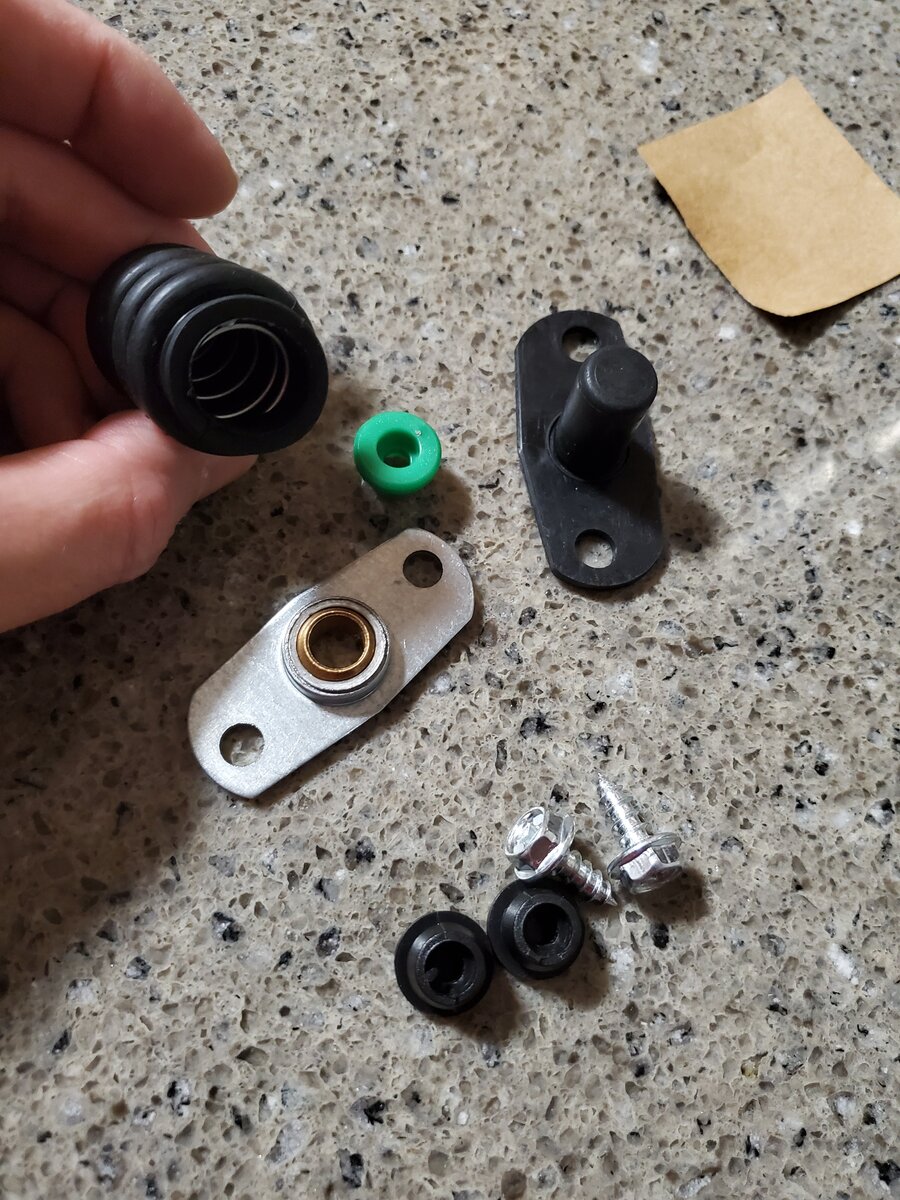

My back still hasn't fully come around, but I got the parts in.
Still haven't seen the parts that these are intended to replace, but I'm hoping now that I can get away with doing the same.
I see now why the price of them is only $13.

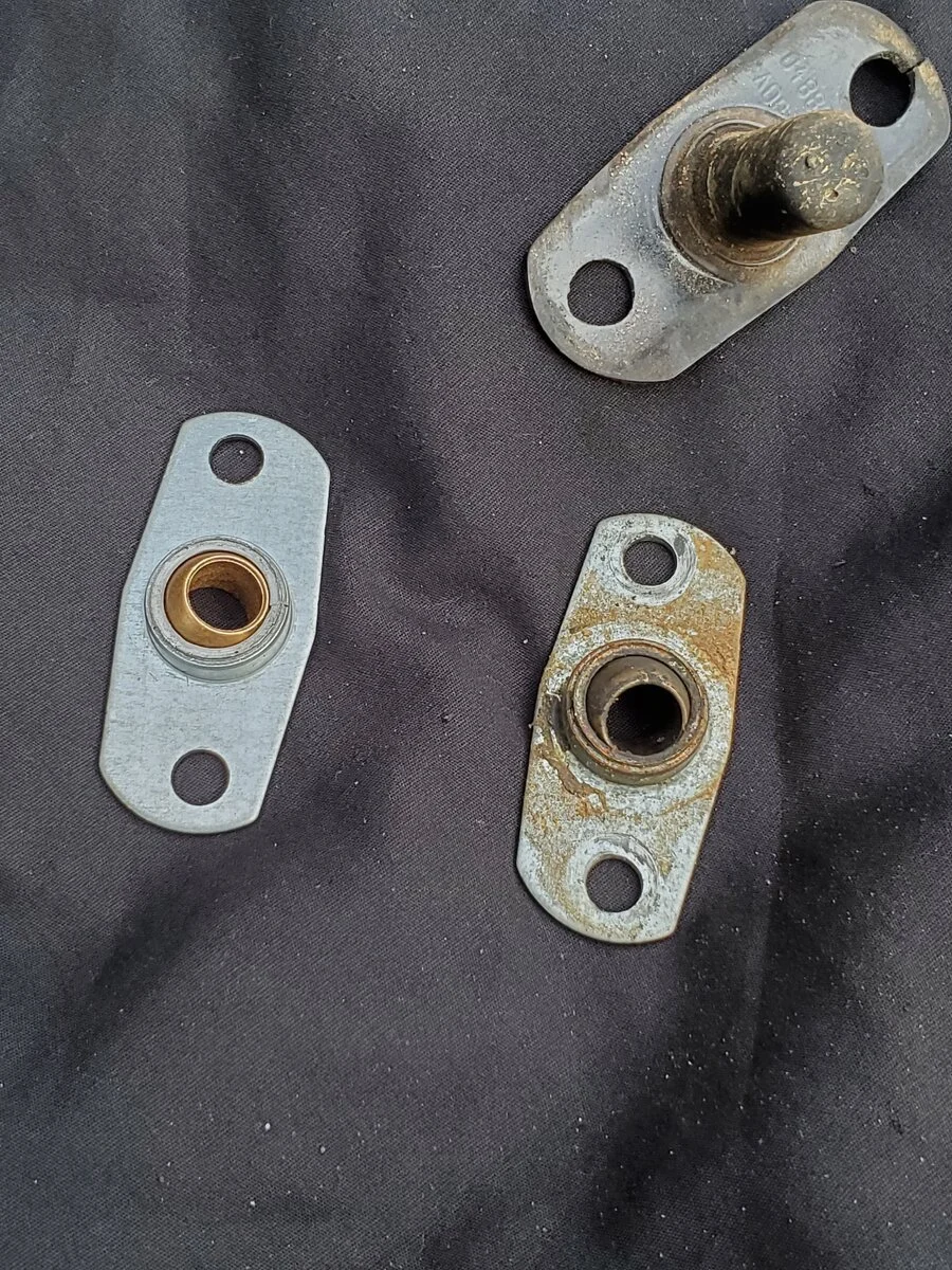

Finally able to get my eyes on the parts. I feel like this is definitely what has been causing the tapping sound.
It's a little hard to hear in the video, but its there. Sounds just like what I've been hearing. Looks as if mine is a worn copper bushing also.

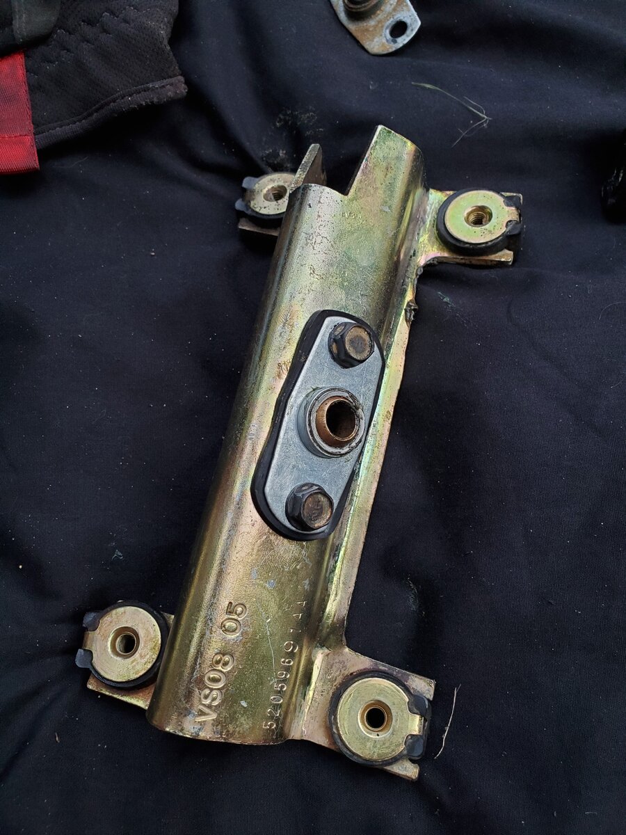

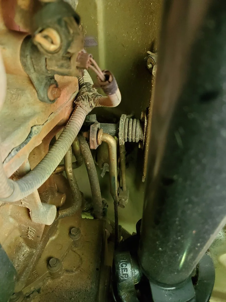

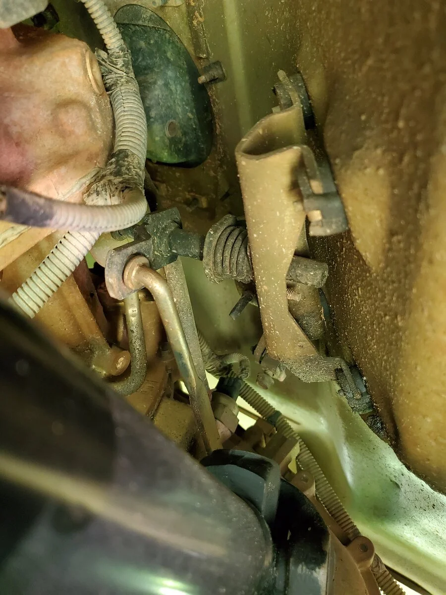

For anyone who's interested, here's some pictures.
I suppose it may be this be this bushing here, but it sounds more like it's going to be the copper bushing.
I ended up doing the same with not replacing the plastic grommets. Had I known what I know now, I would have replaced it all years ago when I dropped the pan to replace the trans mount.
The old bushing did have a little movement though, causing a faint clicking sound when pushed from side to side.
Definitely not the hardest job, but their location makes it awkward and time consuming. I need to look and see how those plastic grommets are being replaced. I attempted to pop loose the closest, but it wasn't coming loose without a fight. Again, really awkward.

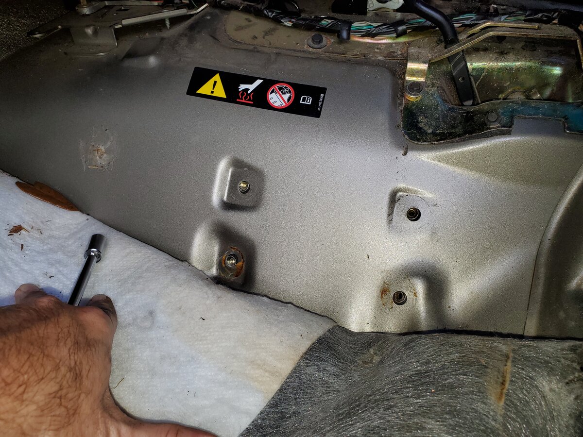

Funny you mention that. It didn't go as smoothly as it seems. As ashamed as I am to admit it, I didn't discover the bolts in the floor pan until AFTER I spent 15 minutes or so laying under the jeep, cursing and fumbling with the two small bolts until I got them out.
That was 15 minutes not adding in the time spent going inside to flush a grain of sand from my eye.:LOL:
I did have safely glasses on, but it was hard to see through the 2" hole in the skid pan while peering through fogged up lenses.
