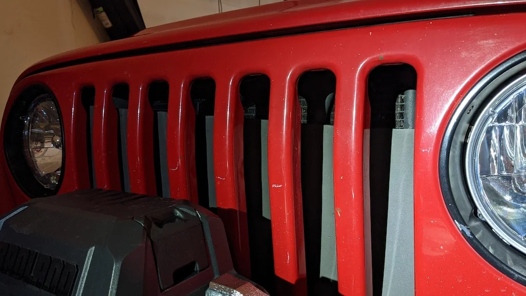

You don't need no heater core flush... trim a foam floor pad and put it in front of your radiator. Bam. Heat.

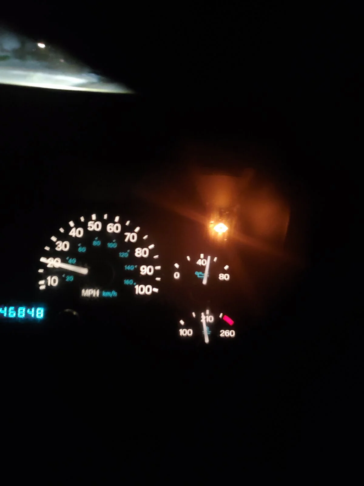

But I still noticed I am below 210 on temp, even lower than before I changed the thermostat. When the problem first started, the needle was barely touching the 210 marker when driving. Less when stop.
Is this anything I need to be concerned about? Previously, used to be rock solid 210 before I had the heating issue, but now it seems to hang here when driving and stopped.
Different brand thermostats work differently. I recently swapped mine back and forth and the change was obvious. I wouldn't worry much about a wagging needle
My 2000 Sahara used to sit just below the middle of the gauge. Engine ran fine via OBD and the heater was unbearably hot. When they switched to the newer style gauges (PCI bus) everything pretty much went to dummy gauges. I think the odler models like yours (97-00) actually fluctuated with the temp. I could always tell when the thermostat opened. Check it with OBD if you’re worried.
