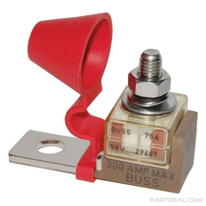

Why couldn't you use this in place of the fusible link; they come in 30-300A ratings.
You can if it is designed correctly by someone who knows what they are doing. The problem is the regulator takes a few seconds to get the alternator leveled out to the correct amperage. You can hear that sometimes on start up when the belt squeals. That is a high load at the alternator pulley which can also be an amperage spike which can take out a fuse.
Is the alternator installed in the 01 TJ 4.0L any different than the one in the '98 XJ 4.0L ?
Almost 20 years ago I replaced the stock alternator in a '98 XJ with a 137A from a '98 GC, built a set of 2 Ga fine stranded +/- cables and fusion connectors with a 6 Ga charge wire and a 125A 32V bus fuse installed inline to the PDC. This setup worked so well there were numerous members on NAXJA that copied my setup.
This fuse is of a similar design; so I was just wondering.
