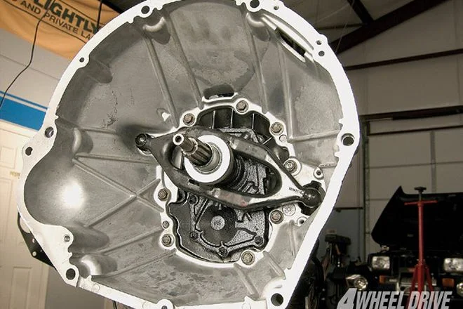

Where are the "dowels" located? There no rust or corrosion anywhere on my Jeep, I'm pretty sure that it is just binding on the shaft - but again, I would like to know where the "guide pins" are located ... i don't see any signs from the bottom third of the separation between the transmission and bell housing plate, are they half way up, or on top somewhere?

Ok then do you see where those dowel/sleeves go? I know this bell looks slightly different than yours, but the dowels sleeves will be pretty close to the same place. The main bellhousing bolts on the sides is where the sleeves are. You can see how the hole is bigger then gets smaller halfway. That is where they are. wiggle it up and down not side to side. On either side try and hammer a screw drive in. Don't necessarily pry just getting it started will actually start prying it. Also if it is hanging, I know this sounds weird, but jack up the transmission to take some pressure off and wiggle it up and down. Use some of those muscles sir you got this!
