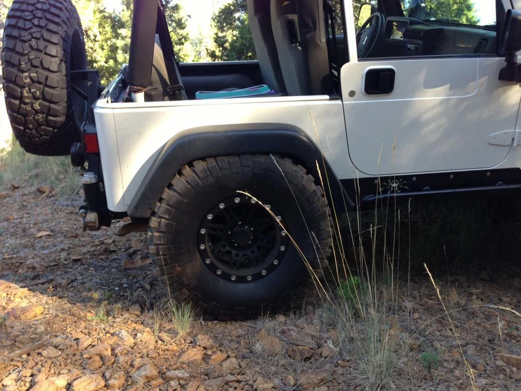

I know you want to run 33's this picture is mine with a 4" lift with 35's. Now I know that 35's are a step up from 33's but just to give you an idea how much more than a 4" kit it requires to run 35's. This 4" lift would have been perfect for 33's. Also since mine is a Rubicon it comes standard with wider fender flares than other TJ's
