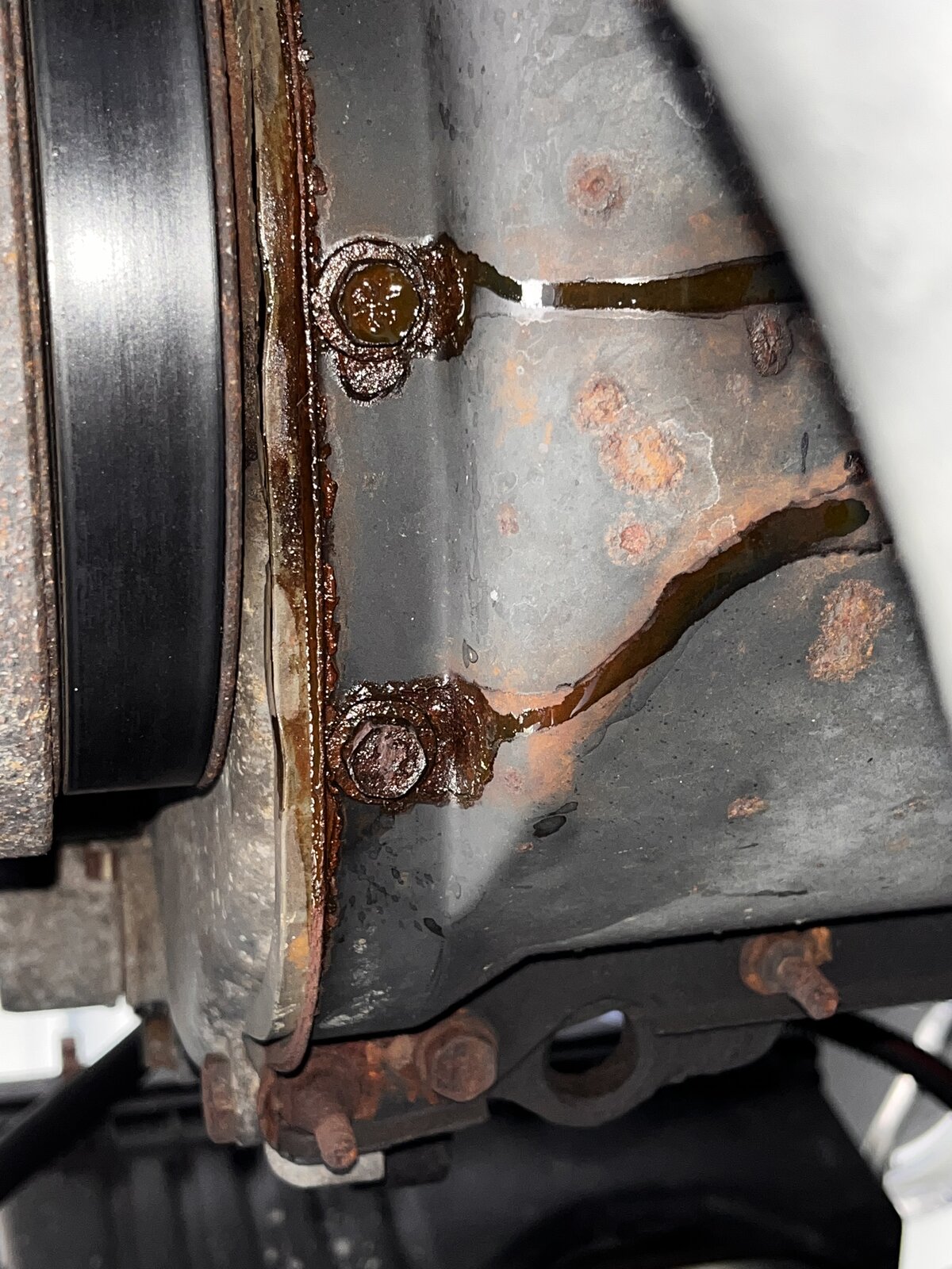

Ok guys. Front of oil pan, antifreeze leak. Left quite a mess earlier. Thoughts?
Water pump?
You guys are always amazing at this stuff.
Thanks
If it's dripping from a hidden location behind the pulley on the water pump that's pretty much guaranteed to be from the water pump that is about to go out. When the water pump's bushing starts leaking through its weep hole it's time to replace the pump. Avoid store-brand replacements, even if it comes with a lifetime warranty, try to find a Mopar replacement.

Yeah I’ll definitely go with mopar. Just wanted to double check if my theory of water pump was accurate.

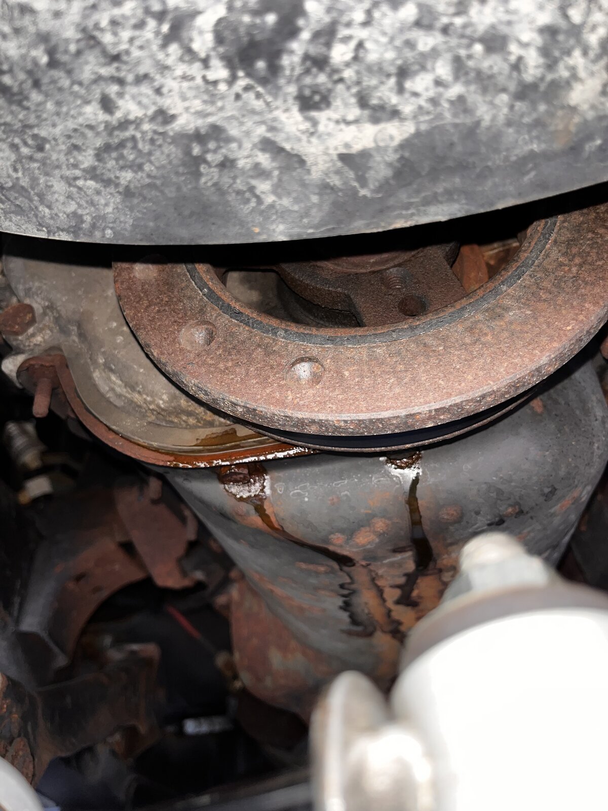

Super helpful posts and pictures. Thank you! I have the same issue and if I tear into it are there other things I should do while I have a part timing belt, etc?
There is no timing belt, but if the serpentine fan belt is old then yes, replace it while doing the water pump. Same goes for the radiator hoses.
