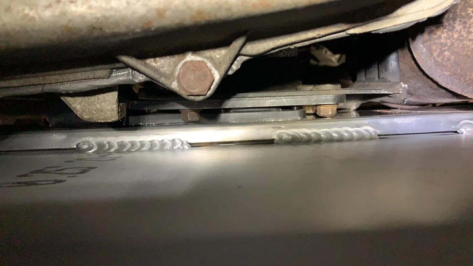

Things get incredibly tight once that belly pan goes on. I dont think we could have stuffed everything up there with out it. Also it helps bring the tcase back down a little lower towards the belly pan to help with pinion angle.

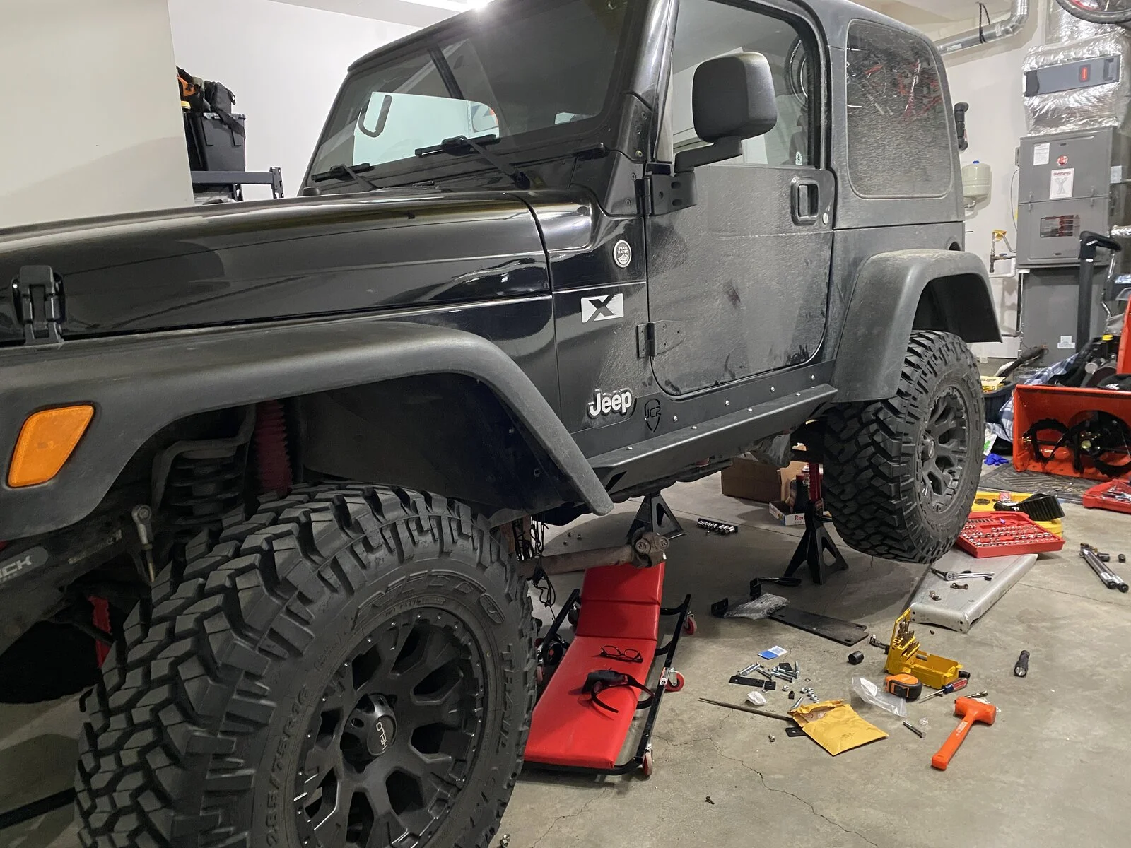

I have the extra clearance tc skid with LO PRO trans mount. My JB SS SYE is arriving tomorrow.Tom Wood driveshaft Monday. Currently have 2” spring lift, 1/2” body lift,1” MML. Don’t know when my SAVVY control arms are coming. I can drive it right now the way it is with just a little vibration but I’m not for fear of drive line damage.l did add some hard 1/8”rubber between the two half’s of the LO PRO. I don’t seem to have the idle vibes associated with this mount. But I only have a few road miles on it.I don’t know if that is making a difference or it will hold up as I just used silicone to glue the rubber to the LO PRO
Okay,I was wrong, when I got home Friday I started the Jeep. I do have vibes coming through the tub.I guess I thought I didn’t because the shifter wasn’t vibrating

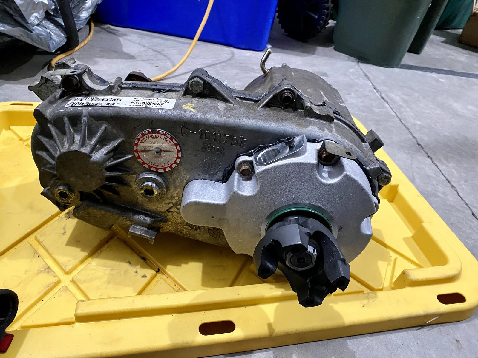

I'm going to wait and see how the JB SS SYE kit, RockJock Adjustable rear trac bar/housing bracket, UCF Ultra High Clearance TC plate and UCF LowPro Trans mount install goes to see if anything else is needed. I'll call Tom Wood's tomorrow and see if they have any advice on the DC rear driveshaft needed, so I can get that rolling my way also.
