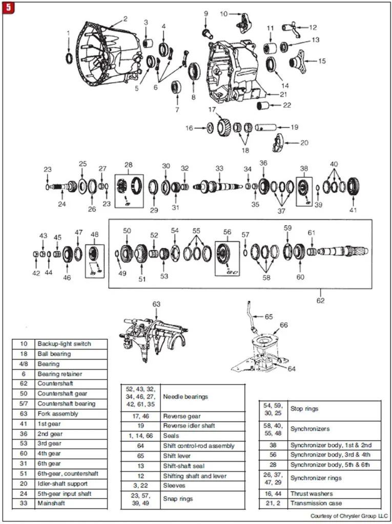

A friend of mine has a transmission that he got out of a wrecked JK that only had 4k miles on it. I know the bellhousings are different and a 3.6 transmission won't bolt up to a 4.0.
I looking to see if anyone can confirm if the internals are the same.
I was entertaining the idea that I could just swap the internals over into my LJ.
