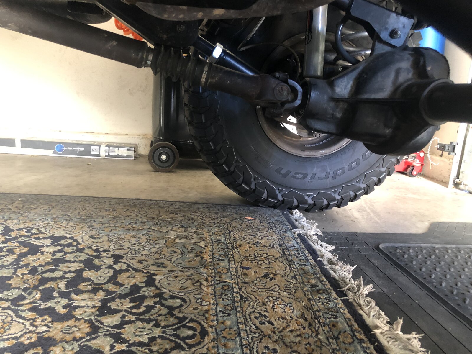

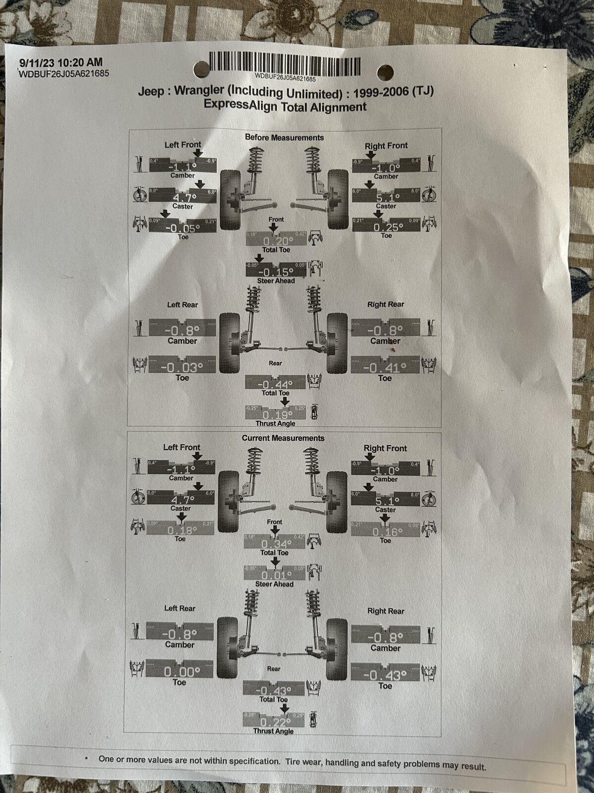

Yet another wheel alignment ! Any suggestions for rear thrust angle and toe in? RC 6” and 35s . Don’t hate on my lift just make some knowledgeable recommendations please.
The thrust angle is due to you right rear toe.... probably not enough to adversely effect your vehicle.... This angle is not adjustable so I would drive and enjoy it

Yep...thinking that corner slid into a curb at some point and bent the housing. Ive driven worse thrust angles without noticing it but it wasnt all in one tire, it was the whole housing being put of whack due to control arm setup. This one might see some accelerated tire wear in that corner.
