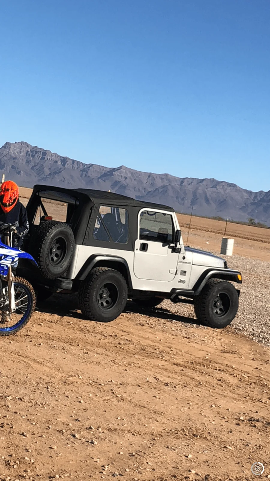

First post hopefully this goes well lol I've been reading on here non stop for about 2 months now. Cant seem to find exactly what I need for all of my build. I have a stock 2000 se trying to buy all of my parts now so when im back from deployment ill be ready to get to work. I have so many questions but my main one would be the lift. Im willing to pay for quality but some are crazy expensive. I want a 3 in suspension lift for 33's. ive been looking at the teraflex lift but for 3 inches would I need upper and lower control arms? most people seem to go back and forth just wondering about that lift specifically or any other options. Also I just ordered a JCR Offroad dagger front stinger and plan on ordering a warn vr8-s gen ll winch tomorrow, would having that up front make it sit lower than the rear? Maybe I should get spacers too? It comes with quick disconnects too but I was wanting to get a anti rock im thinking ill be alright with either. And im regearing, armor all the way around, maybe 1 in body lift, lunchbox locker in the front, bolt in roll cage, and a bunch of smaller things. Any tips for a guy just starting a build would be appreciated!! Thanks ahead of time!! Picture for a little before action
