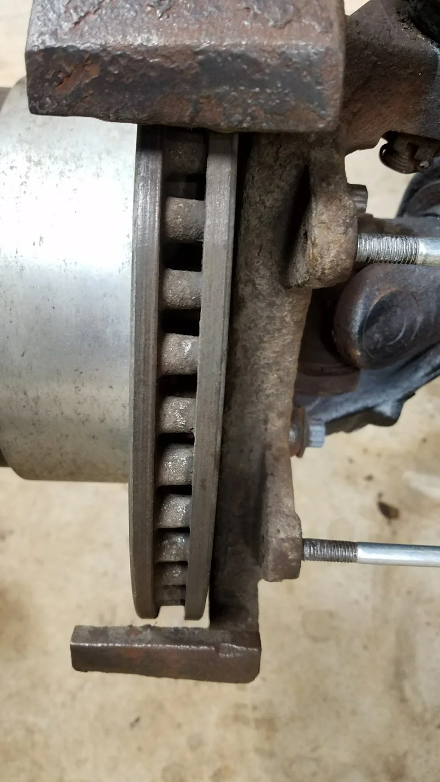

Any way to salvage these steering knuckles?
Mike_H
autos are better - WRWD508
Feb 28, 2017
11,737
Grand Rapids, MI, United States

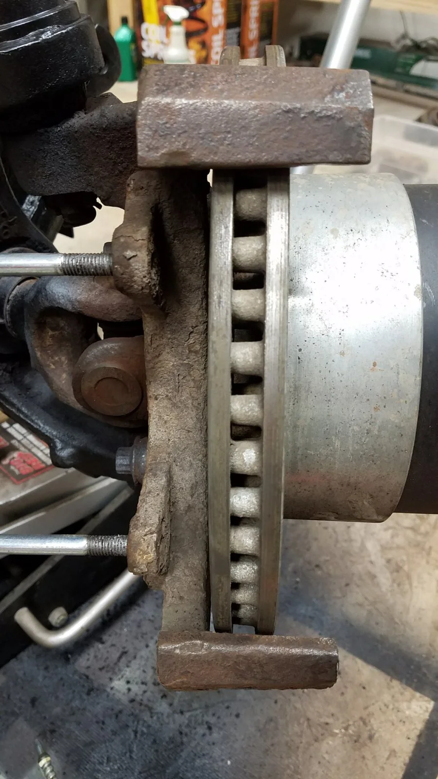

Examining the front end of my jeep while its all torn apart, and I see this...It appears to me that both of my knuckles have worn where the pads seat and are supposed to move. Unfortunately, an upgrade to a BMB kit isn't in the cards right now. I have been looking at the U-pull-its around me, and I can find them, but I'm afraid of only finding them in the same shape as what I have. Don't really want to drop coin on new ones (120 bucks a pop) cuz at that point, well, I'll figure out how to get BMB brakes.
@mrblaine, @Chris, @JamesAndTheSahara, @JMT, @bobthetj03...any way to salvage these, or know of a place to get decent used ones? All you guys live in the great areas of this country that are unsalted...maybe a local pick and pull or yard you know of would ship to me?
As far as welding them... aren't they cast? I'm no welder...I can stick two parts together with reasonable confidence that they won't come apart, but welding on to cast doesn't appear easy to do.
The internet is rife with cast ferrous materials mythology. First is not all cast ferrous are the same. Some of it is very much able to be welded and some of it will not take a weld no matter what you do so to lump all cast ferrous alloys under the "cast iron" title is not very accurate. The factory knuckles are on the lower end of a decent nodular iron composition and as such will take a mig weld with no issue and very little prep. Just get a knotted wire brush on a grinder after the areas you want to weld and get all of the rust removed down to clean shiny metal. After that, you can weld it up but be aware that the higher carbon content will migrate into the mig welds making them just slightly harder than you can possibly imagine.
When you go to take the weld down to the final shape, you need to use a good hard grinding disk that is flat and have a new brake pad on hand to use as a guide for fitment. The pad has a u-shaped groove on one end and that needs to be able to slide across both sliders with no resistance but not be loose enough to rattle. The good news is after welding, the new areas will be much harder than the original iron alloy and will never wear. Then use the pad as a guide to check distance between the two sliders. It again, needs to slide from side to side between both of them without too much slop.
