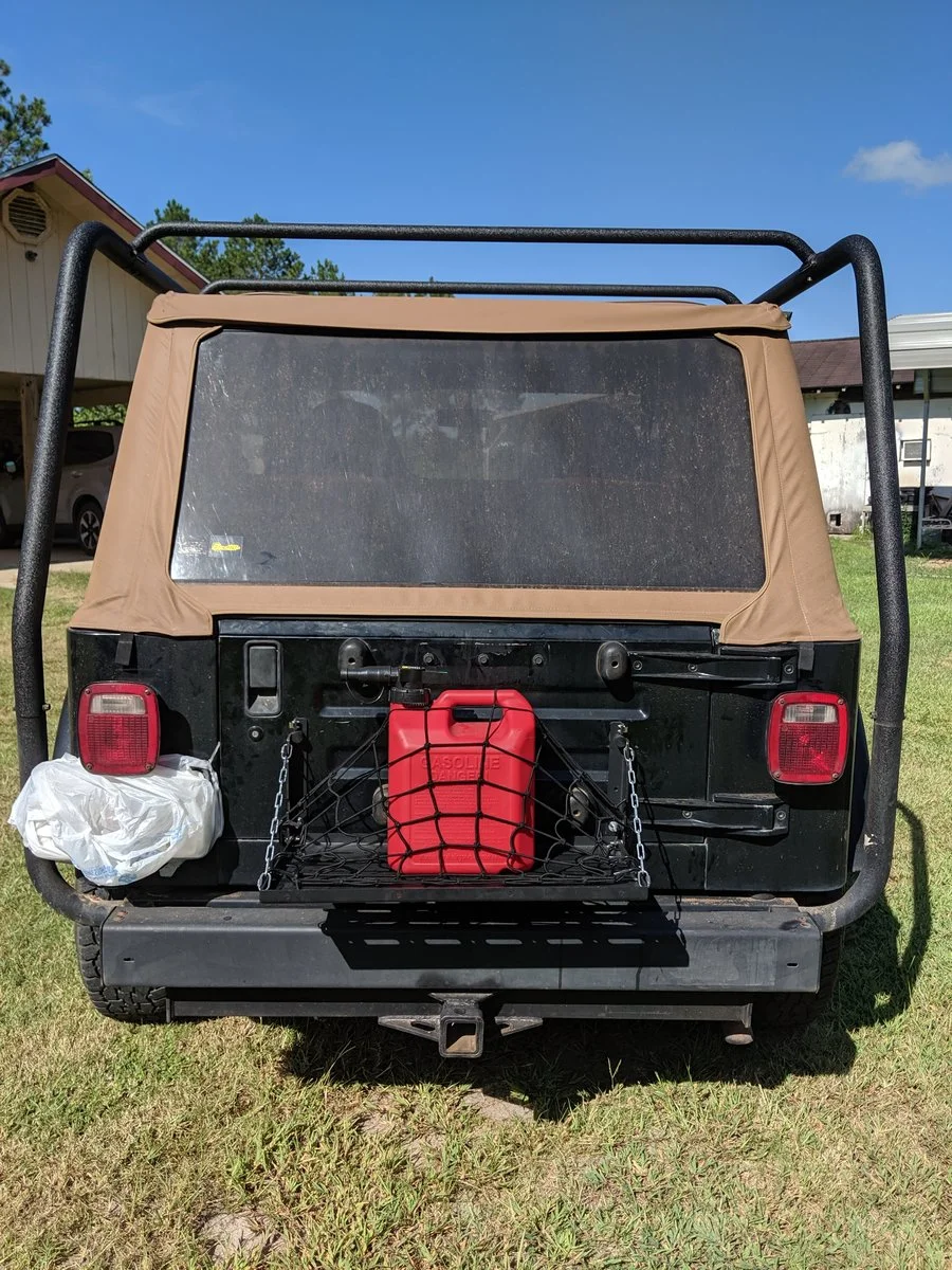

Here's what I did, it's a good down table for inside of tailgate. I replaced the wimpy cables with chain and ran bolts all the way through the tailgate and put fender washers on the inside.

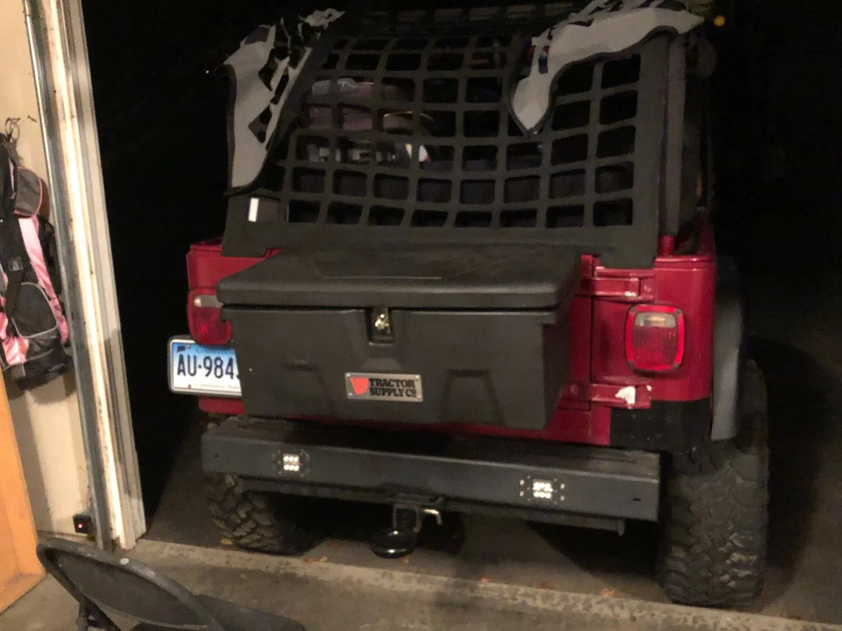

Thanks for the feedback guys. @ranwilrw I actually already have a tailgate table that I made to go on the inside of the tailgate (it's in the video I attached here), but I really like your setup. I ended up having a couple beers and fumbling around Tractor Supply for some inspiration. Here's what I ended up doing - I'll post better pics if there's interest, but got this done late last night and forgot to take more pics.
I have two quick detach options on the outside of the tailgate now. The first is a quick detach X Track rail that I can fasten things to, add hooks, etc. to suit my needs. I mounted Tractor Supply bulldog farm jack mounts on either side of the spare tire footprint using metal screws and a couple anchored bolts. The carriage bolts on the jack mount easily pop through and run into the tracks on the x track rail and it secures with a large washer and wingnut on each side. I did this a few days ago and it holds my bowless soft top and a couple camping bag chairs very well, nice and snug to the tailgate without any loosening or rattling. Super nice and convenient.
I also wanted some storage that locked and for things that are less easy to strap down. camp stove, blutooth speaker, even groceries if I have the boys in the back and need storage - so I started thing ink about mounting a cargo box to the x track system I got set up. This sort of worked but I was worried about the stress that the size and weight of a loaded utility box would put on the mounts I installed. A few more beers and I started eyeing the old spare tire carrier. I mounted the spare carrier to the back of the utility box by drilling three holes in the box, popping the 3 posts for the spare through, and securing with a mending plate and lug nuts. Then, five bolts to stick it on the tailgate where the spare tire mount would fasten from factory, and it is securely in place. I plan on securing a few fastening points to the top of the trunk so that I can attach the chairs, top, popup tent, etc. right on top. Doesn't rattle or seem structurally insecure. Five minutes on and five minutes off and it locks with a padlock. In theory someone could grab a socket and remove and run away with the whole box, but it's big and I don't frequent many places where I'd be concerned about that. The pic makes it look crooked (before I changed to spare tire mount) but in real life it is dead straight now that mounted better (see video). **Also, the pic I posted shows the spare tire brake light still connected, but it is now removed and looks much better. I got this all done late at night and my son's room is right above the garage. Since there was one stubborn bolt that needed either an impact gone or Sawzall to deal with, I saved it for the morning.
When I don't want to run the utility trunk or the x track, all that stays on the jeep are two small jack mounts which blend in and look fine. I'm pretty happy with the outcome. Now we can camp or tailgate with the boys all in the jeep and pack our stuff.

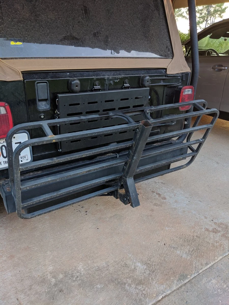

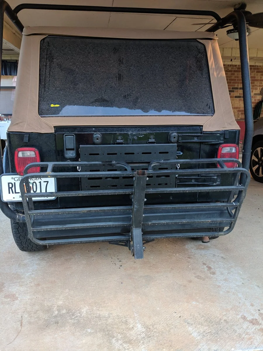

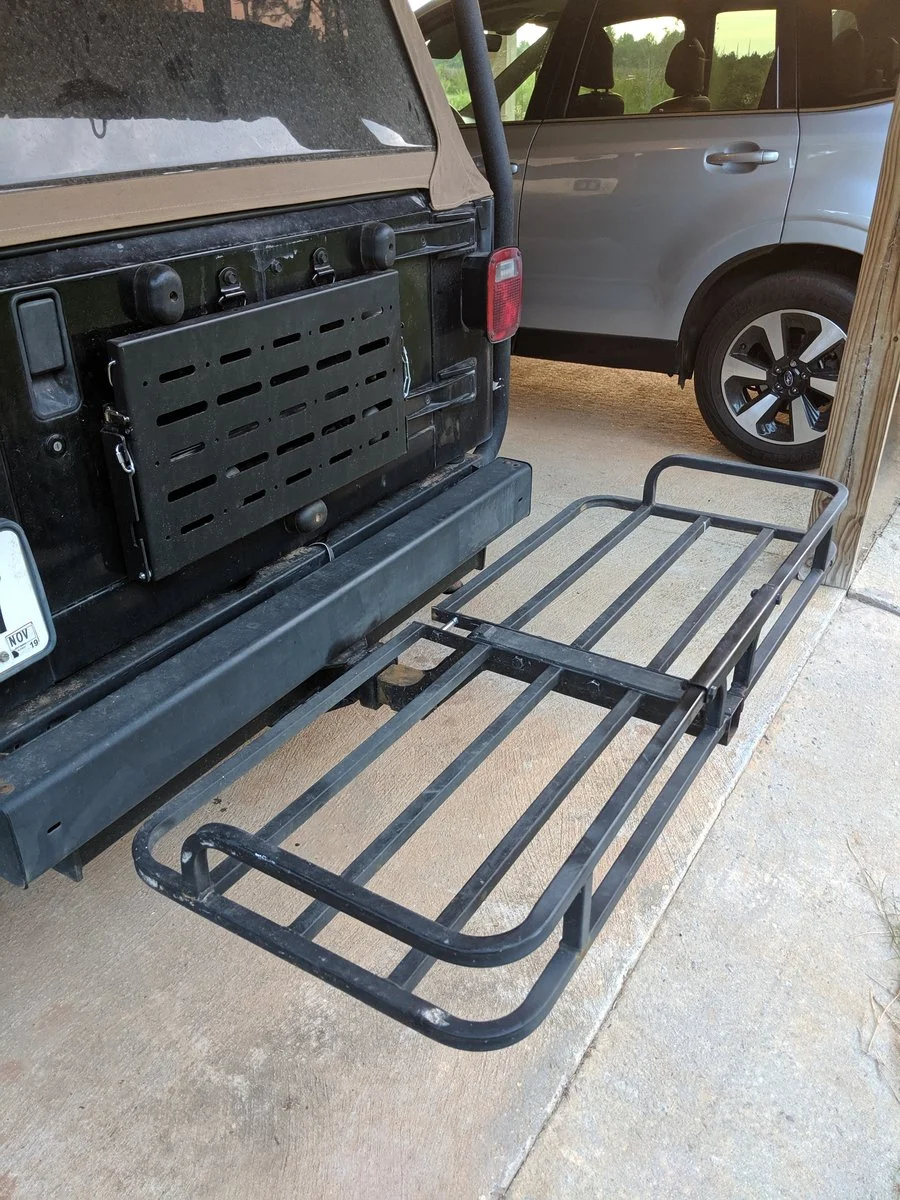

I also have this handy dandy rack, $49.99 at Harbor Freight and has a 300# capacity. It normally does not pivot but just slot 1 of the bolt holes and there you go. I also assembled the platform closer to the bumper to make it even more compact. Google atv rack on h/f website, you'll see it. I guess I like things that fold up out of the way😊. But like you said, you can't open the tailgate with it loaded.

Thanks for the feedback. I had the same though as you after I mocked the box up and added a mending plate inside the box between the plastic and nuts. Then, I realized that I had an extra 2 foot piece of x track that would provide even more structure so replaced the mending plate with that on the inside. now the thing isn't going anywhere. I loaded it with most of my camping stuff and took it out for a pretty rugged dirt road ride and nothing even looked like it thought about pulling or budging. So I think I'm gonna run it until I regret it.
I also have a rack for the hitch receiver that we use with the other vehicles and I;ve used it on the wrangler too. I really wanted an option that allowed me to open and close the tailgate without having to unpack and disassemble everything off the jeep. With the box on the back, I can bring what I need, open the tailgate, use the fold down table to put the camp stove or my beer on (or both) have a little fun and be ready to roll super fast. A good example of when this will be nice is when we're tailgating since I won't have to spend a half hour before going into a game or concert packing up and reassembling. Now I can just throw everything in the box that's valuable, lcok it up, close the tailgate and roll.
