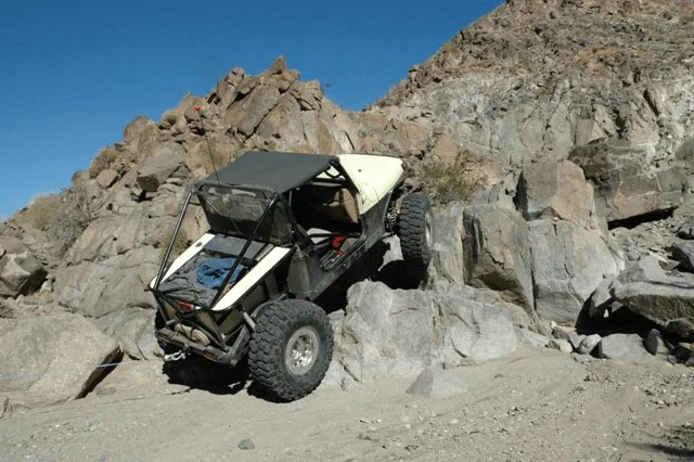

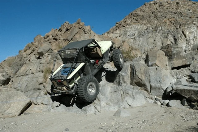

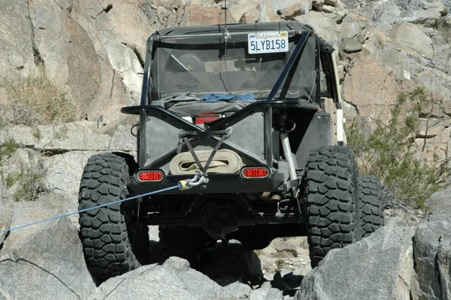

I'm fairly good but I have not figure out how to make winch lines push me up an obstacle yet so it is safe to assume that the line you see in my receiver is attached to something else. That something else was a well built YJ that blew the rear axle halfway through Outer Limits and we decided to go up rather than turn around and go back down. It was a long day with me tugging, towing, yanking and pulling him up every obstacle in 2wd. That sort of recovery of which I had and have done several is why I removed the 231 that was in there for that one and replaced it with the Atlas II. Point being I have been around a lot of chain driven cases in JV and we have never broken one. I don't doubt your experiences, we just don't see them in the TJ and I'm around a lot of folks who have bigger tires than they should have.
