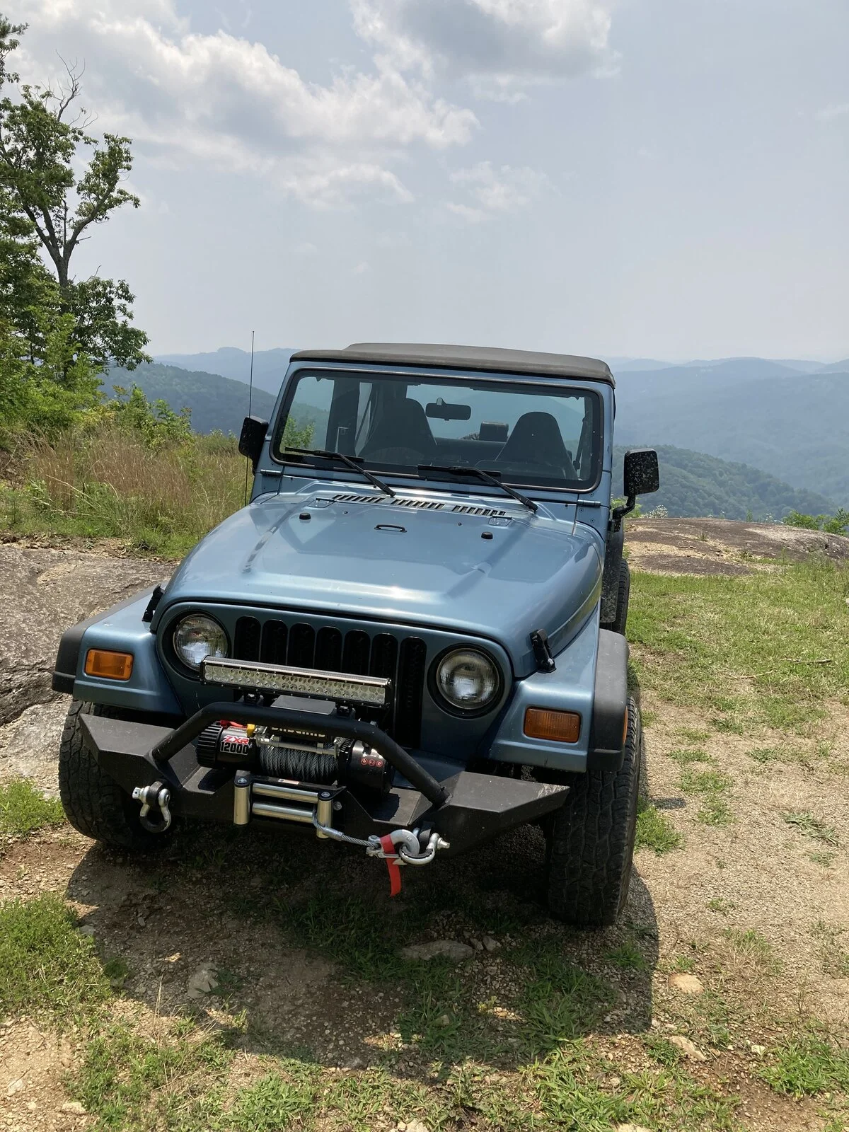

By the way, welcome to the forum! That color is one of my favorites on the TJ!
This 97 is my sixth Jeep I've owned over the years. Bought it from a guy I sold my YJ to 13 years ago, when my kid was born. Told him I'd always be interested in his Jeeps. Got a steal on this one. The YJ got crushed by a telephone pole.
