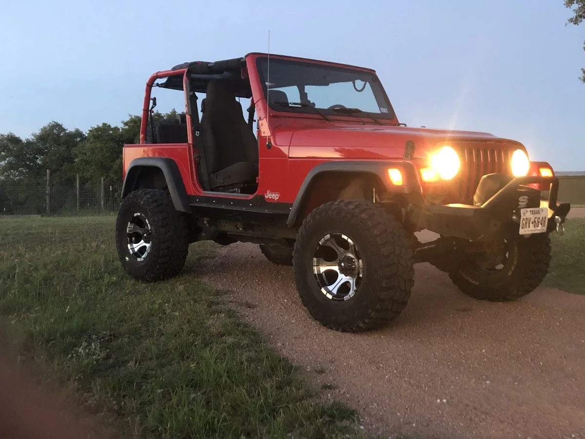

I have the OME with the heavier duty rear springs, RS5000X shocks & 31" BFG AT KO2s
Reactions: JMT
I believe this is exactly what my plan is. How does it go with the soft top? I have both hard and soft top.
I don't own a hard top. And last winter was the first time I'd ever even considered driving a soft top Jeep on any kind of regular basis. It's surprising how well the top does.... no drafts at all, flaps a bit at speeds over 40 or 50 mph, but nothing bad. I love how all the rear panels store up top. And I run it that way all summer long.
The one issue I've had is that I have to be damn sure to put the rear window back in before outside temps drop too far. If I take the rear window out & run it till the outside temps are under like 60 degrees, the zippers are nearly impossible to get rezipped.

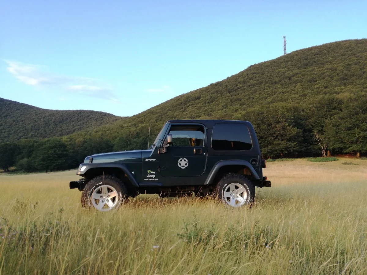

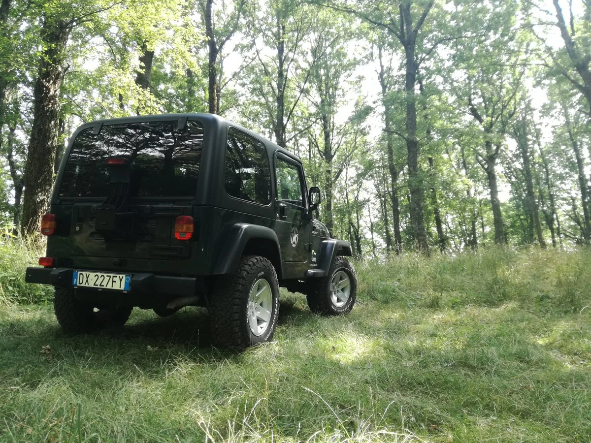

Hi, I've been using my TJ with medium load OME since July. OME 2932 and OME 2941 springs. I have the hard top and in the rear bonnet I fitted a LPG cylinder that weighs about 40kg at full load. They are perfectly leveled between the front and rear, but I do not fit the spare wheel nor reinforced bumpers, nor front winch. I coupled these springs to the Bilstein B8 5100 and I love them, the ride is slightly more braked than the original configuration and I like it a lot. When my LPG cylinder is empty, I notice a certain stiffness more than the rear springs. I run without problems with 265/75/16 and the combination given by the lift and the tires is not bad, but I believe that by mounting something heavier, to stay at the top of 2 it is necessary to mount springs with heavy load.
