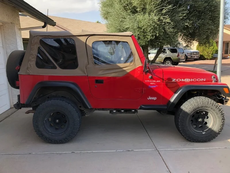

Anyways, while I was out I snapped a photo here is how it looks now:
It still drives great, It is a little firmer in the rear, but now it feels like a Jeep should and less like a car. I did not lower the TC, and now it has a slight vibration shifting into 2nd and giving it gas but it is minor and only at that time. I am going to measure it for a SYE sometime this week, but I really need a break from working on it for a bit. It was 108 degrees today and that is just way too hot.

It looks great, that's for sure. Not like it did when you first installed it. That was one hell of a rake!

yeah thanks, I am pretty sure ARB is right and my Jeep is super heavy in the front and super light in the rear, but since I tow I needed to get to the bottom of it. It rides like a jeep now. And I like to look at it. The next test is to tow with it again, but summer has begun!

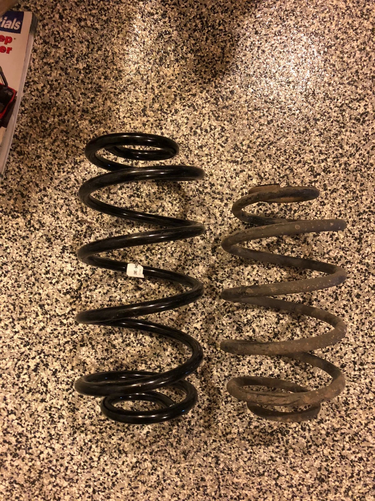

Did you happen to snap any photos of the HD & LD springs side-by-side by any chance? Just curious...

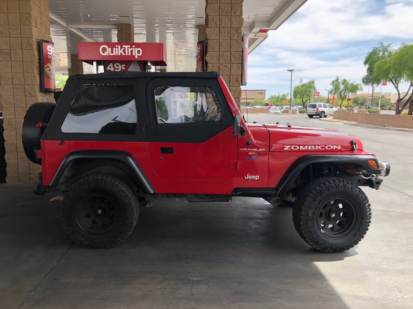

This is what it looked like removing the spacers in the rear and adding the lights:

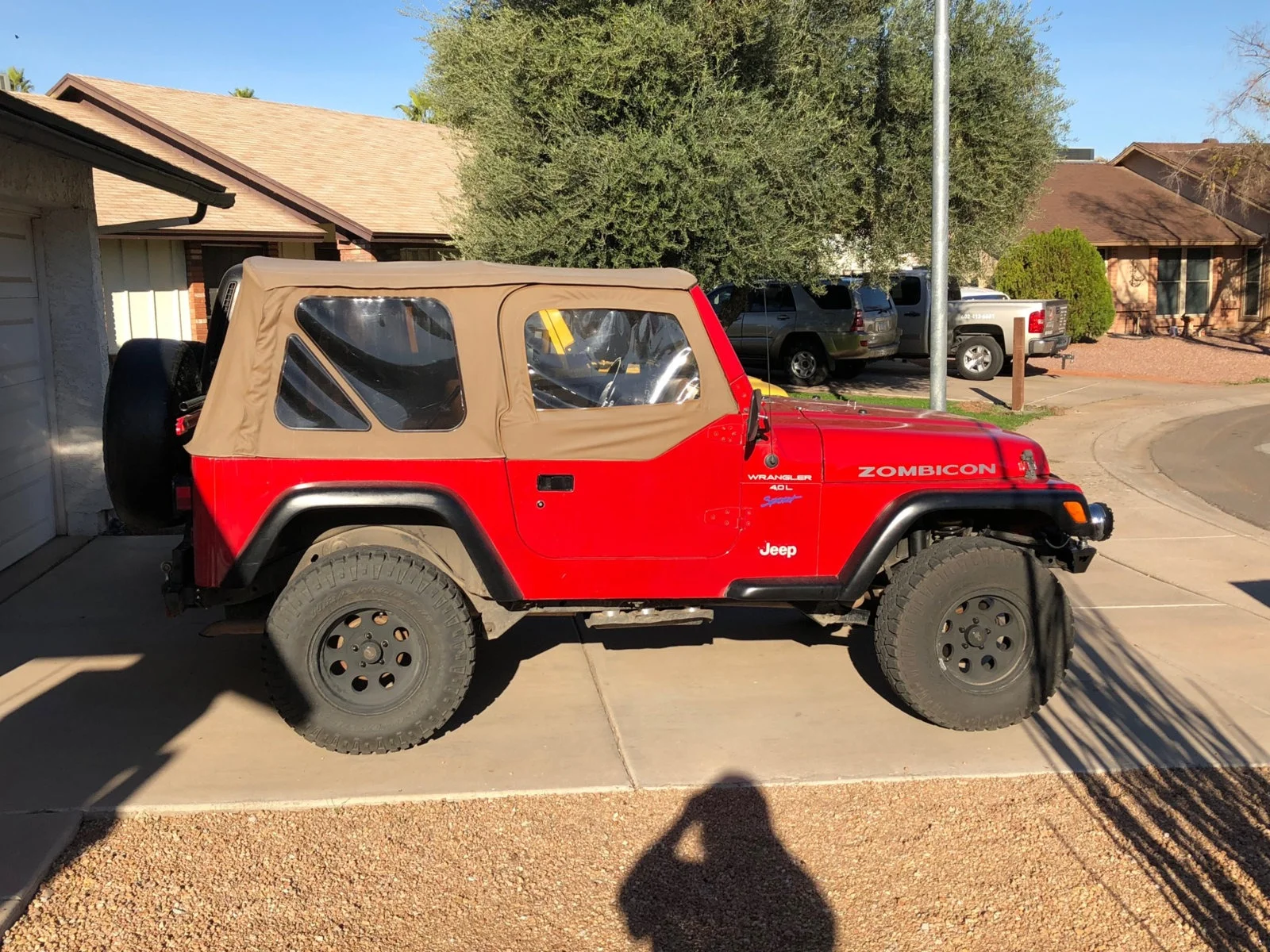

Here is what it looks like now with heavies in the rear and 1.75 spacer in the front:

Thanks for the photos. I was actually hoping you might have a photo of the actual springs, sitting side by side...

The difference in free lengths between the lightest and heaviest 2" OME front coils is about 1.3". The rates vary from 140-160lbs. Longer doesn't necessarily mean more lift.
The rears are about an inch different in length and range from 140-250lbs.

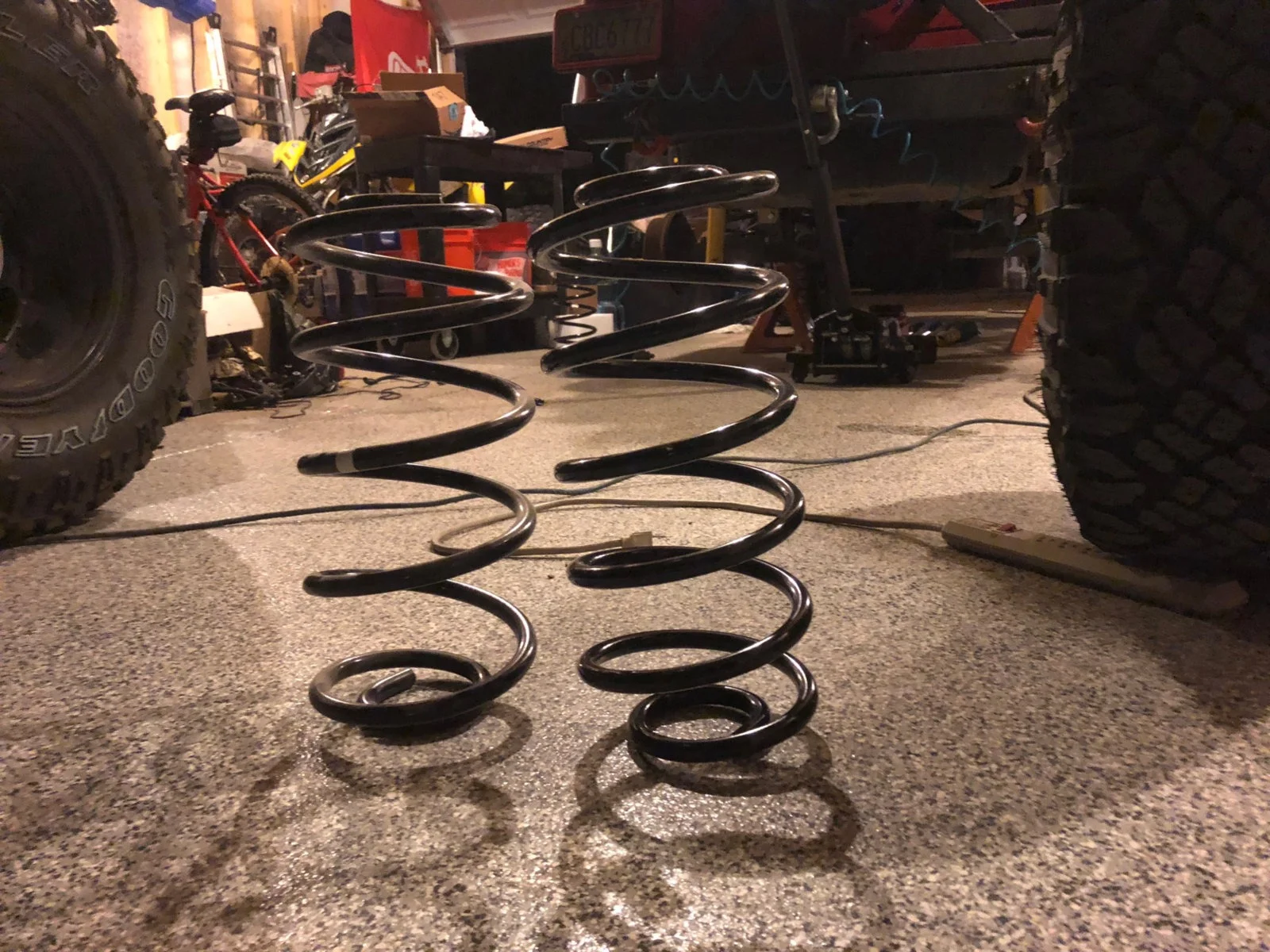

Here is the heavies with the stock rear, that is all I have a picture of.
The lights are thinner and slightly taller, if I remember right. They actually have a one to to more coils but considerably thinner.
Wait I think I found a picture of the lights vs heavies rear:
Perfect, thanks! Just a visual guy, I like seeing the differences. From the ARB website, I knew the LD springs were taller, I just wanted to see how much.
The LD have worked fine on my TJR. The heaviest thing I put on my Jeep is the hard top, and I really can't see any discernible height difference in the rear wheel well between the hard and soft top. The only passengers I ever have in the back seat are my 2 Chihuahuas...
