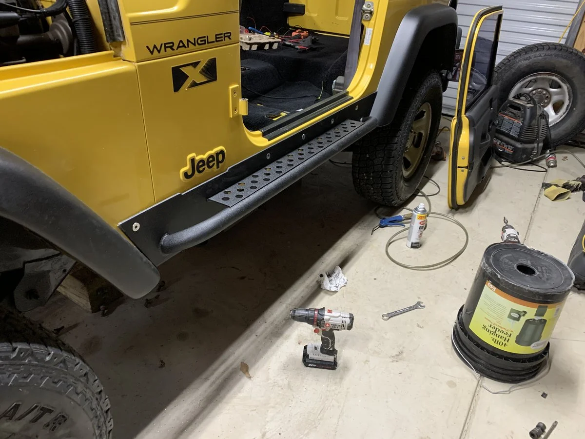

I’m good thanks. The right side is on. Took about 30 minutes. No mods made.

Thanks for everyone’s help whether you like or dislike this product.

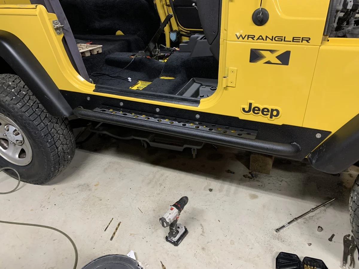

Second side done. About 20 minutes. Life is so much better with an impact wrench!
