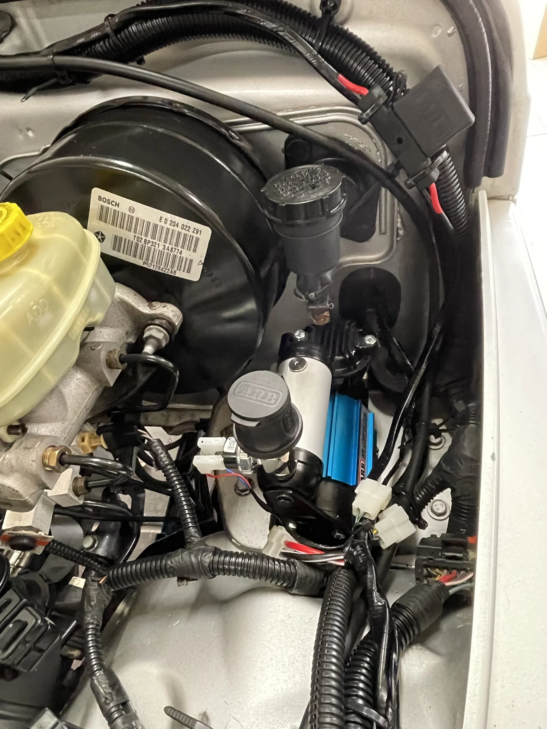

I did the same thing. Set it in there and mark where you want it, then unbolt the tray and pull it out, mount the compressor to it, and bolt the whole thing back in.

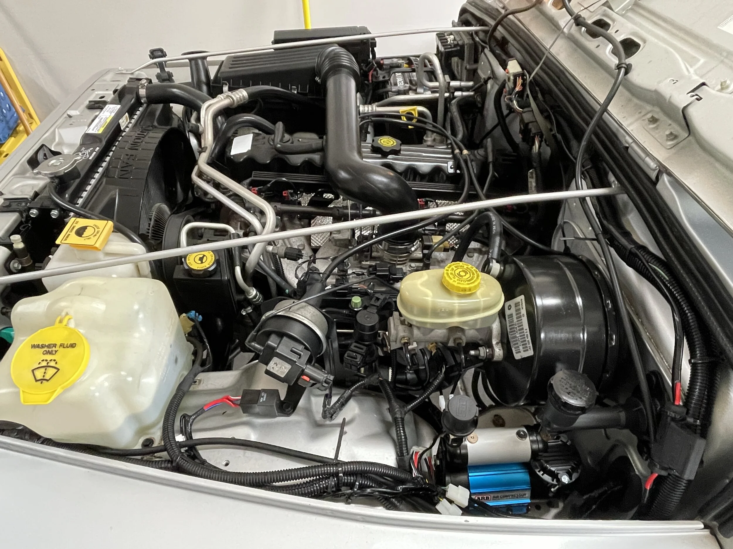

Also, maybe it isn’t a big deal, but I was worried about mud or dirt or water or just any junk getting in the compressor connector since it’s facing up, so I just took an extra end fitting and sealed it with foil tape and leave that in the compressor to keep anything from getting in there. You might be able to see it in the pic I posted.

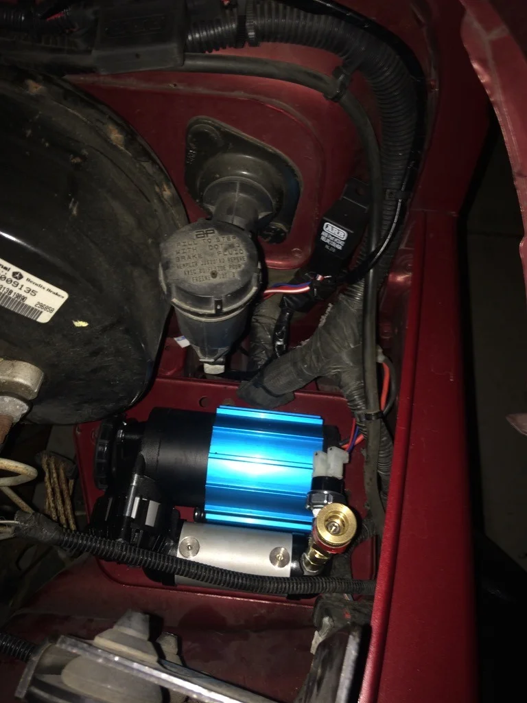

I did the same thing. Mounted the ARB to the empty space below the master cylinder. Remove the plate, drill the holes and mount the unit. At least on my TJ, there's a rubber boot just below the plate where you can fish the switch wires to the interior. The included switch fits neatly to the stock switch blank.

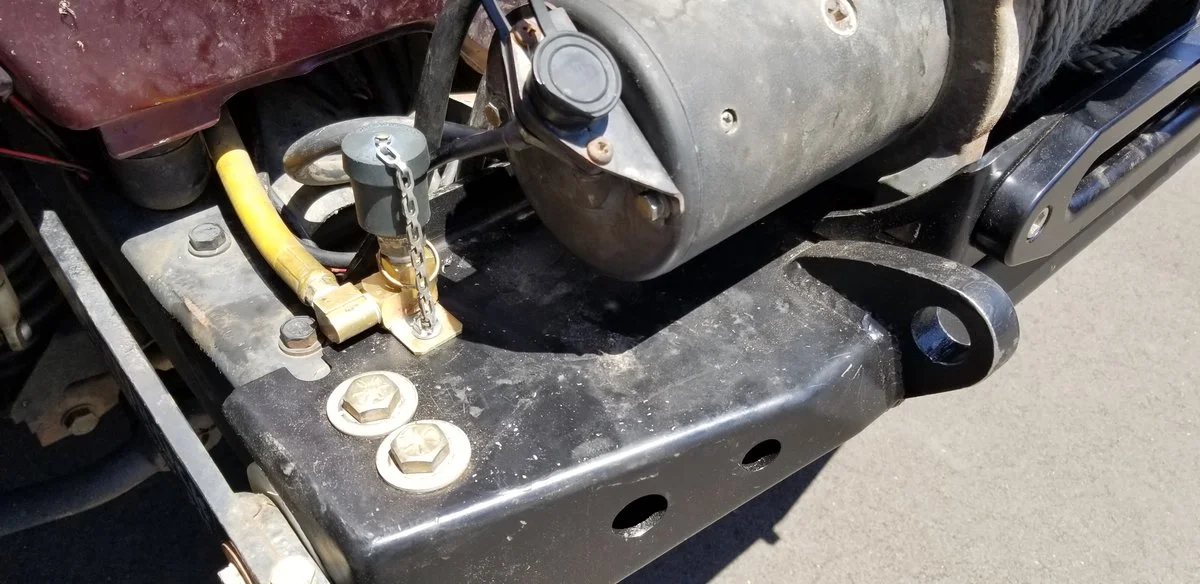

You can make a plug for the air chuck by getting a fitting and capping it off, keep it in the air chuck to keep dirt and dust out while off reading. I have the same set up and it works great.
The tray is the way I went as well. I removed the tray after marking where I wanted the pump to sit. I then drilled holes and bolted the pump down and with the bolts loose on the pump itself I wiggled the tray and pump in. With the bolts loose on the pump rings, it allows things to spin on the pump which gave me the room to get it in there. I then used a piece of vacuum hose to put around the air hose so it wouldn’t rub on things. I did this under the Jeep as well for any areas it may rub on its way to the rear locker. For the hose port, I used the little red hole plug they used during shipping with a little Teflon tape to hold it in place to keep dirt out. It never fell out in the three years it was there. I finally splurged and bought a plug from wits end. ACP-ARB1.

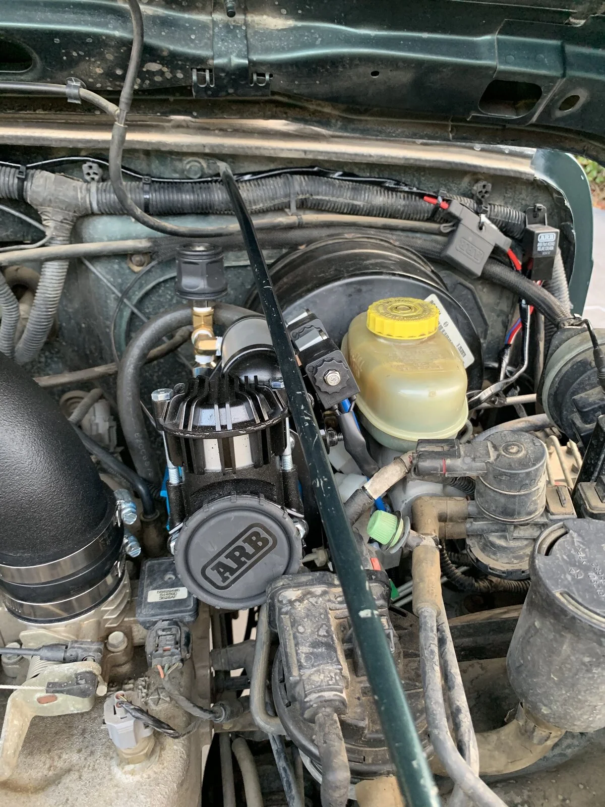

It’s a great solution for me. I can fill my tires from 15 lbs to 30 in about 3 minutes each. Which is good enough for me. I used the switches the pump came with as well as pulling the intake filter into the cab of the Jeep so it would deal with slightly less dirt.

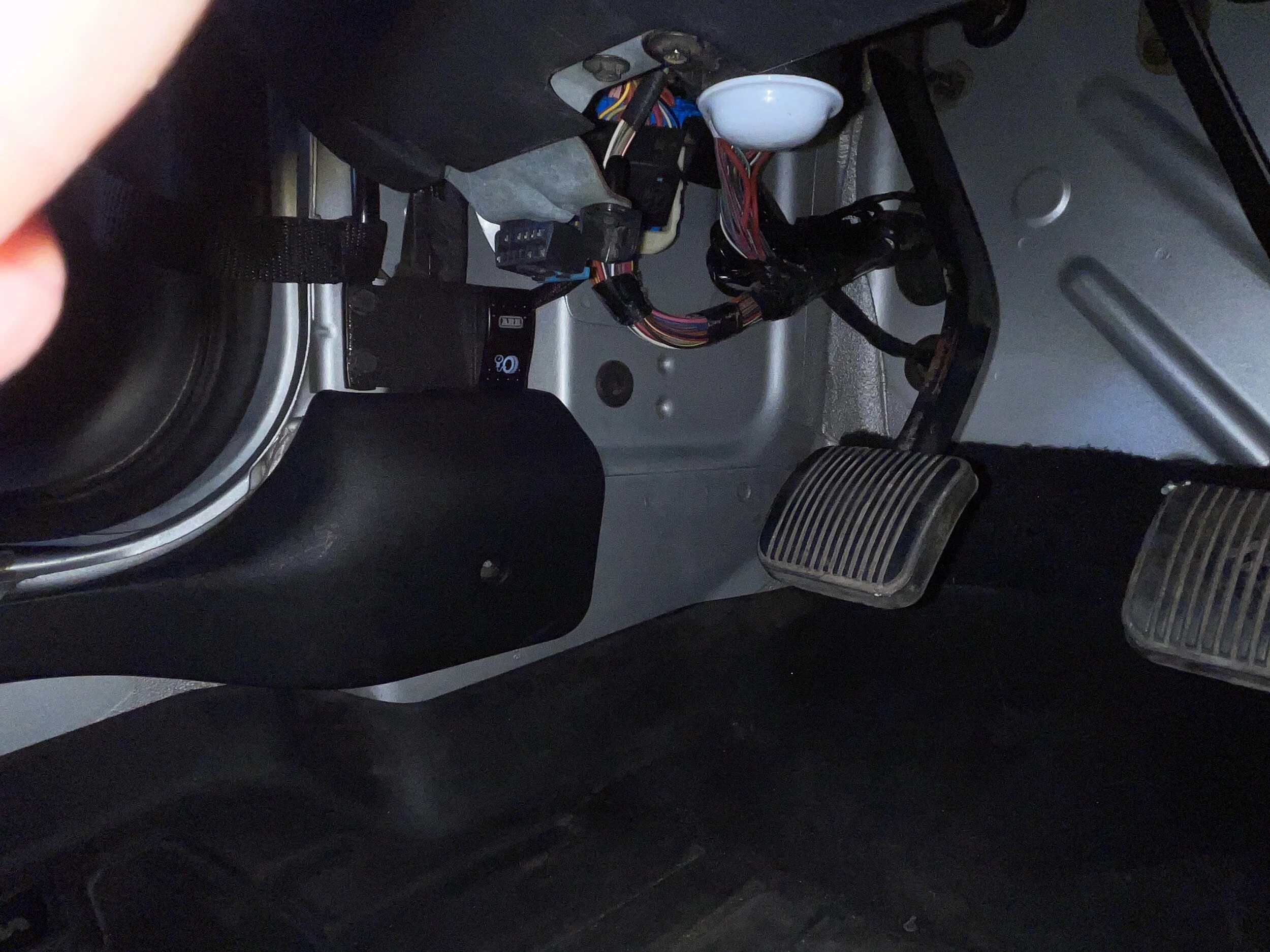

Thought I might add some photos of my single ARB compressor install. I preferred a clean look and a made a plate to hide the switch as to prevent the kids from turning it on. (Reminds me, I need to wire a safety switch for my lockers to prevent the kids from playing with that fun button since overriding the 4LO only use).
