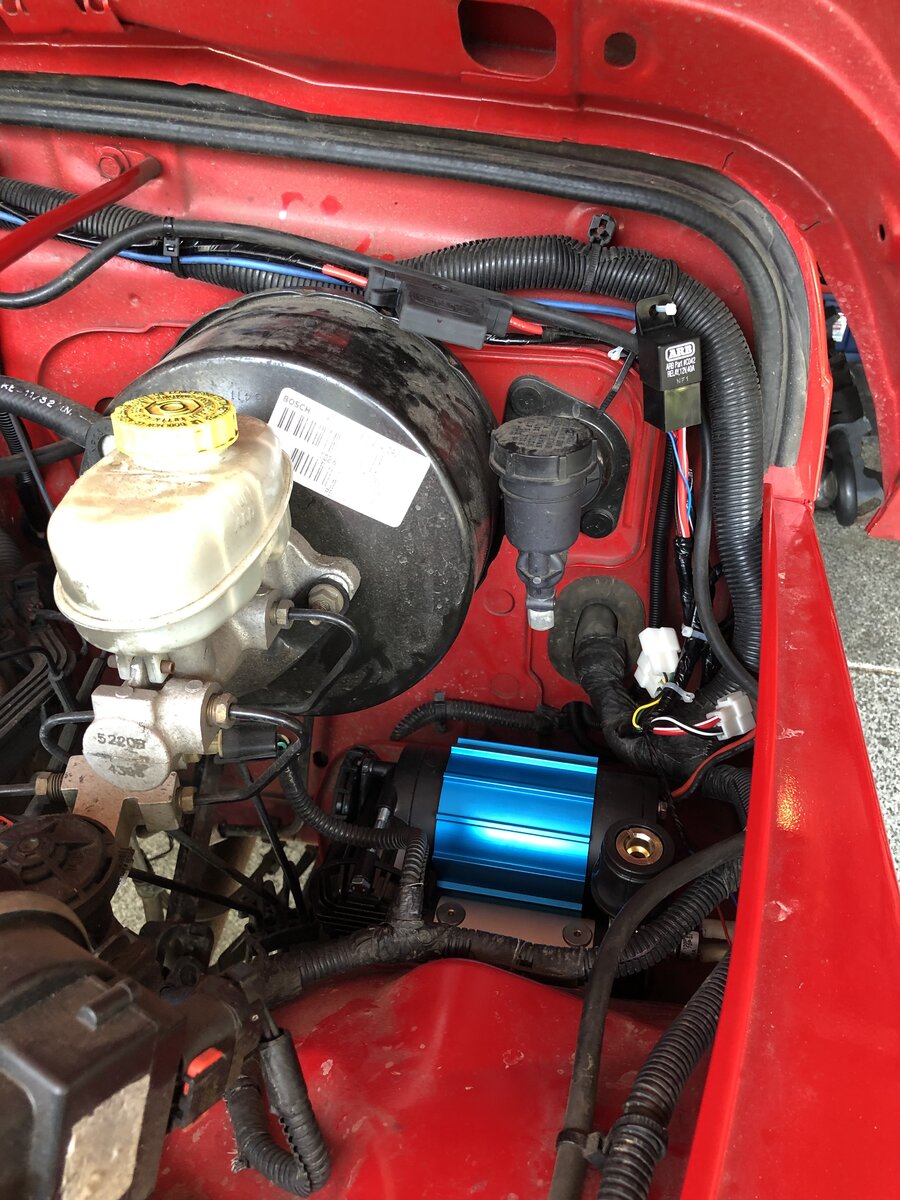

Put the compressor on the tray below the booster. It'll be fine. The air line is easy to route and durable. The wiring for the switches is all wrapped and not a rats nest, it can fit right thru a grommet and fits all behind the dash.

+1 for the ABS Tray for a mounting location:

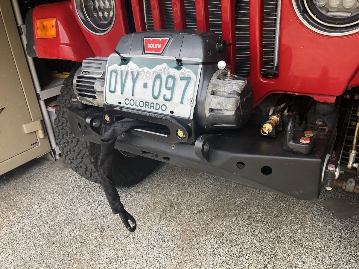

Routing up an air line can go anywhere from here, I put mine to the front bumper

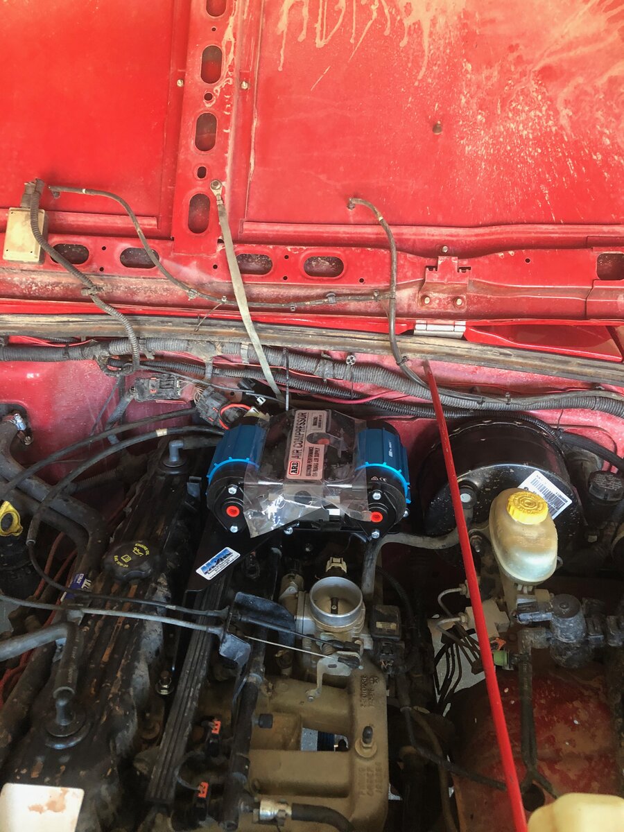

I have mine here there is a custom bracket you can buy to put it here. I bought all of mine in a kit so I don't have a link for the bracket.
That’s cool, was it a hassle to put it on?
It was actually really easy except for I think in the instructions it says it is different for the 97-2000s where you have an extra bracket that comes with it. The bracket bolts on OK but it also bolts on to the main bracket with one nut and bolt. That nut and bold is tricky on the 97-2000's If you have a new TJ then the extra bracket isn't needed and it is a piece of cake. If I ever have to take it apart. I will probably weld the bolt from the bottom of from the second bracket so all I have to worry about is getting the nut on from the top. It would make it cake that way. I am not sure why they just didn't do that from the manufacturer.
To be honest, I left that net and bolt out because there was really no way to get to the bottom of it probably without pulling the throttle Body. So I figured I would just take it back apart and weld the stud on from underneath, but I haven't gotten around to it yet.
Other than that one bolt it was pretty simple. I think a lot more simple than trying to muscle it in under the Brake booster. I am not saying under the brake booster is a bad idea, just that this bolts right on top of the motor and it was pretty simple, and the intakes are a little bit higher.
It is all preference really. Although the down side to my way is I think that bracket was like $100 dollar so that is enough to think about if it is worth it or not.
