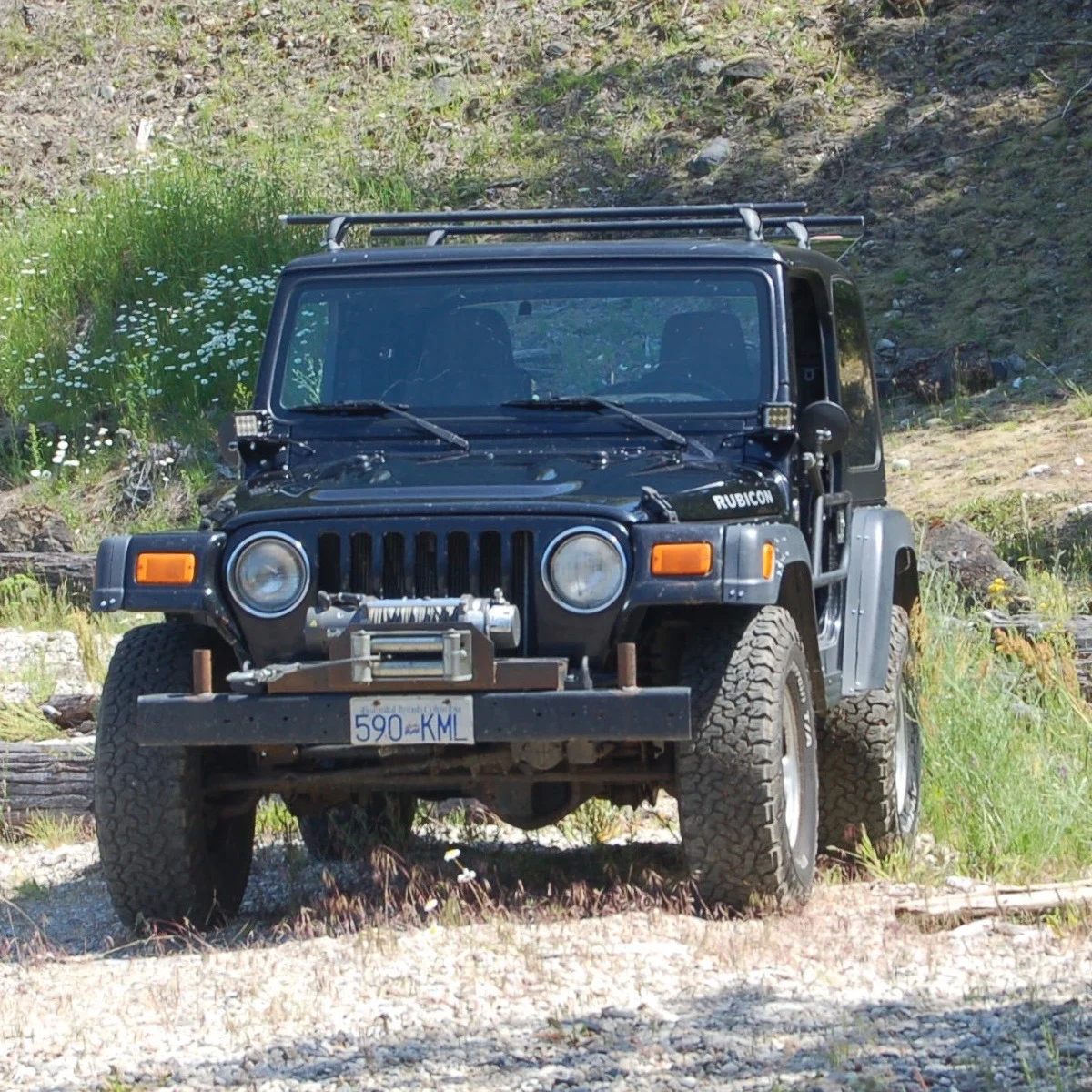

yes, you can..... heres 33x10.50R15 KO2s on 15x7 stock steel spokers. 5.5" backspace and AEV Highline. 4" flares.
Stock suspension, no lift.

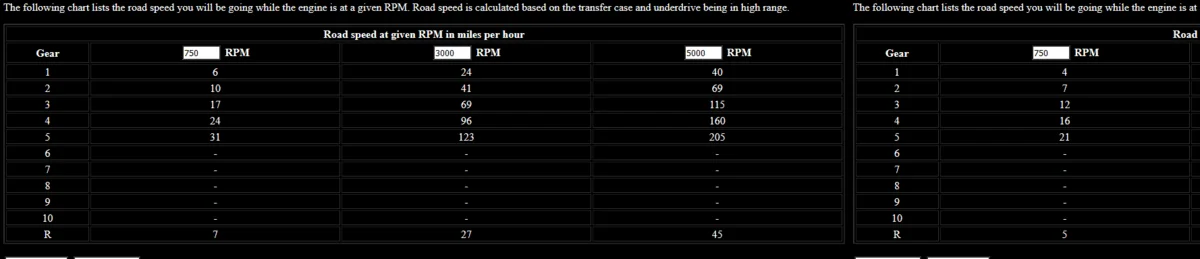

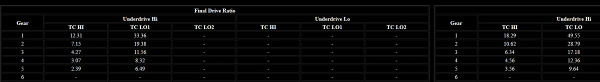

Based on grimm jeeper, 2nd is a little taller than first used to be. (3.07 left, 4.56 right)
