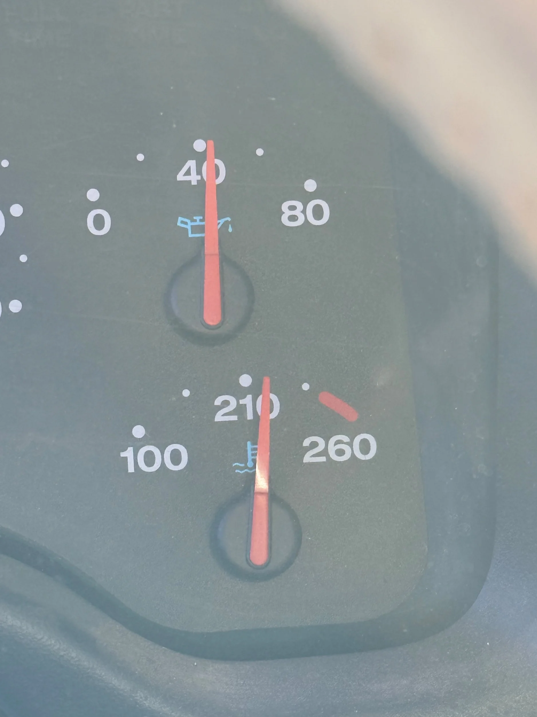

2002 TJ, I put on a new fan clutch, thermostat and housing, new radiator with a flush and new coolant. Jeep runs perfectly fine when driving but when idle for about 15-20 min it will go to about 225. In the summer in Arizona where temps are 110f+ will this cause my jeep to overheat? Pic shows 215 but it goes up to about 225. Thanks
Oil pressure will go up and down... but my 99 tj heat soaks on hot days if i idle too long. My thermostat never goes above 210 though. The heat soak is an issue with my injectors and seals. . It stays dead on. So this could be the beginning of an issue. One simple red neck trick is to use a higher water ratio to your coolant and bleed the cooling system to see if the temperature drops. You would create a small leak in the cooling system. If it doesnt drop. Then it could be a clog in the system flow or a bad sensor. It wont harm the jeep to try this. But you will need to flush it after and refill with 50/50. But higher water is a great steam that wont poison you.
