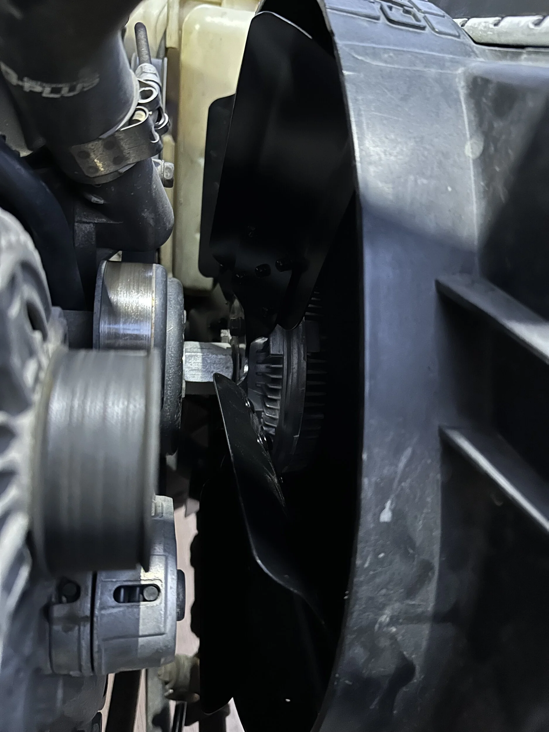

Checkout the last 5 pages of this thread out i used a 19in derale 6 blade fan (17919) and a (22160) usmw fan clutch and have had very good results in temp reduction at idle comparing head to head with the stock fan keep in mind you will need to modify your factory shroud to make sure it doesnt contact the larger fan and its a bit louder. https://wranglertjforum.com/threads/improving-the-cooling-on-our-tjs.63812/page-31#post-1568159
A lot of folks will say 225F is normal. I would say that it is how the stock TJ runs hot in idle, but it can be better.
I am using 6 blade fan with Hayden 2791 fan clutch, the temperature creep in idle is much much less.
