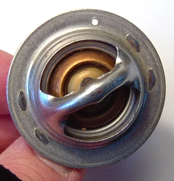

You've got air trapped in the system. Did you drill a vent hole in the thermostat?
From the forum:
20190617_080640-jpg.99797
Yes, most likely there's still air trapped in the cooling system. Drilling a hole into the thermostat's flange like shown below and positioning the hole at the top when installing it will help get rid of the trapped air more quickly. Some thermostats come with a vent hole already, just make sure to position it at the top when installing it.

Ok I definitely did not do that and missed it in the thread. Turns out I believe I was pretty low on radiator fluid and I’ve gotten the level back up and it seems to be hanging out around 210 now.
Do I need to go back in and drill the hole or will the air escape over time on its own?
ETA: Once I saw the fluid leaking and figured out it was the water pump, I parked it. That was about 3 weeks ago so I’m guessing more fluid leaked out than I had imagined.
you probably found your problem then. The hole isn’t mandatory, but it sure helps, and I did it.
But, if you saw that it was low, filled it, and it’s running correctly, you’re most likely good.

It was my understanding that the TJ will self burp over time
Over time maybe, but in this meantime you can get an overheat. This is why one needs to burn with this kit, or burp with using the bleeder valve, or use both. Using both might be the best option.
The level dropped because the air worked its way out. The hole isn't needed now, but this shows why it helps to do it up front.
