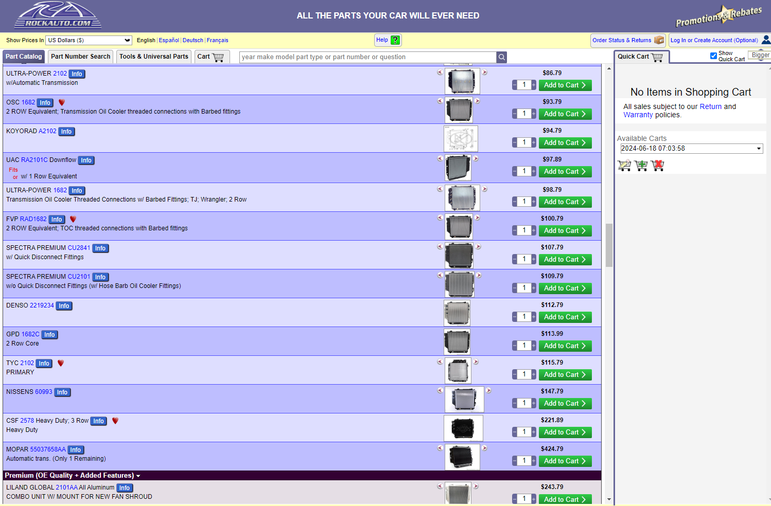

When your Autozone Duralast radiator fails, I'd not take them up on their "lifetime" warranty and replace it with another Duralast. I'd try to find a Mopar, hopefully there will still be some somewhere by then. Duralast is not a good brand and their radiators don't cool as well or have the quality of the Mopar. Don't take their lifetime warranty to mean it has good quality, it just means they'll give you another when it fails. That may not seem like a good business model but it is. By the time most people get around to replacing things like their radiators, water pumps, etc. they typically don't own their cars for long afterward so AutoZone doesn't end up having to replace it again after its first purchase. Us Jeep owners do tend to keep our Jeeps a long time so when replacing critical parts like that it's best to pay a little more to get better quality than Duralast. Mopar if you can find it for critical parts like radiators, water pumps, sensors, etc.
Multiple options...
https://www.rockauto.com/en/catalog/jeep,2004,wrangler,4.0l+l6,1425901,cooling+system,radiator,2172

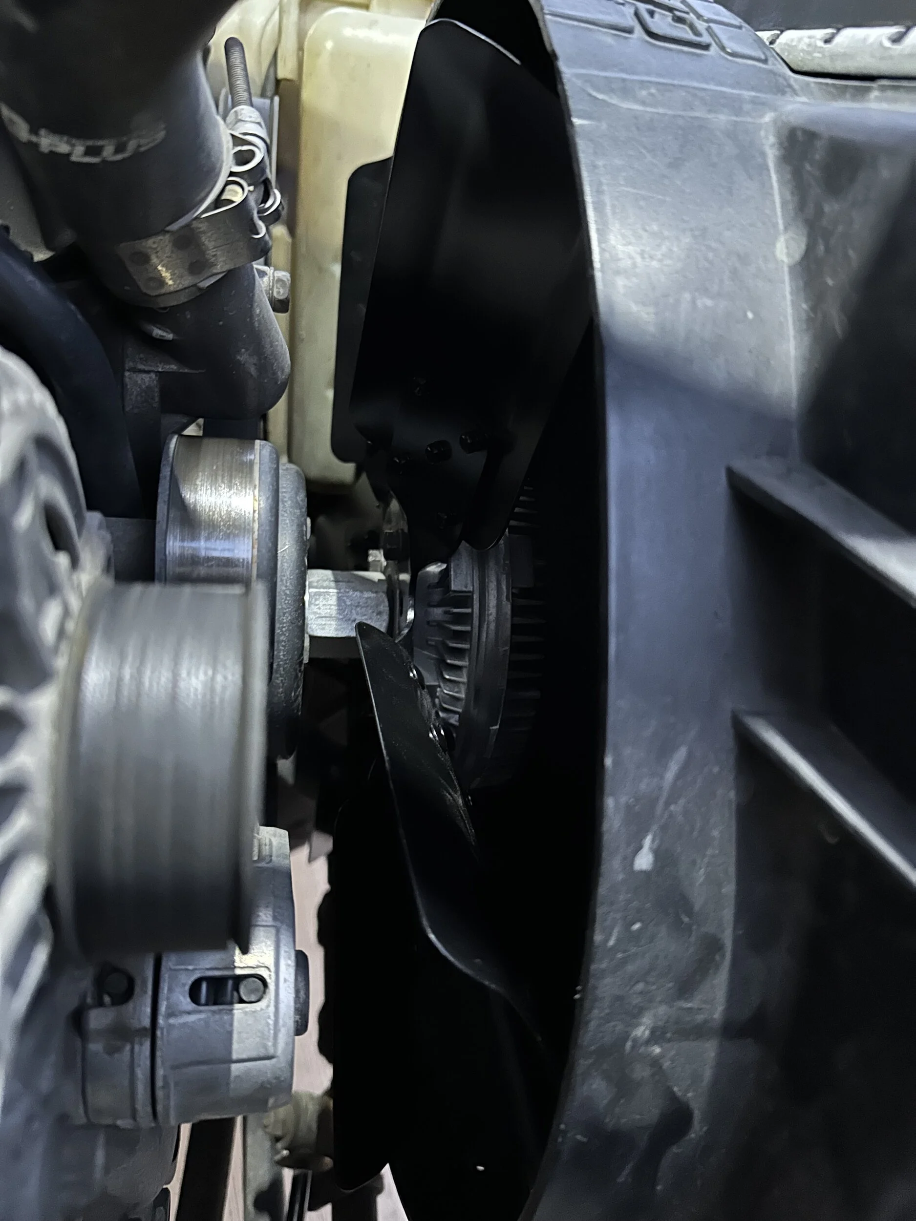

Ok so I took out the 19in 6blade fan fan today to make some direct comparisons to the stock 5 blade fan I measured from 5 different areas in the grill using the same meter the 6 blade fan pulled a 1mph faster avg airflow than the 5 blade at idle 5.63mph to the 6 blades 6.58mph also during my 30min testing intervals the 6 blade fan stayed at 210f while the factory 5 was at 221f with a 90 degree ambient temperature and ac on max needless to say i can confidently recommend this as a solid upgrade to your factory cooling system and happy I found it!

Might that also mean it’s quieter as well? I’d think the 19” is moving slower, that would be a nice secondary benefit.
I might have missed something, where did this fan come from? A Chevy truck? My corvette uses a 19” fan blade but I need a reverse rotation and many folks use TJ fans, but they’re smaller… I found that a newer Chevy truck (1996+ Chevy Truck SBC 350 “vortec”) is a modern plastic blade, reverse rotation (like out TJs) and 19” diameter.
How close is the shroud to the 19” fan?
Reactions: ColoJeep
Ok so I took out the 19in 6blade fan fan today to make some direct comparisons to the stock 5 blade fan on average using the same meter the 6 blade fan pulls 1mph faster airflow than the 5 blade at idle 5.4mph to the 6 blades 6.4mph also during my testing interval the 6 blade fan stayed at 210f while the factory 5 was at 221f needless to say i can confidently recommend this as a solid upgrade to your factory cooling system and happy I found it!
Cheers!
It’s around 1/2-3/4 of an inch it hasn’t contacted anything so far it a derale 17919 fan and I’d say it similar in noise but a much higher arguably worse pitch it’s higher and more whiny but worth the performance improvement for me I also had to re drill the shroud to make sure it was centered correctly otherwise it definitely would hit somewhere.
