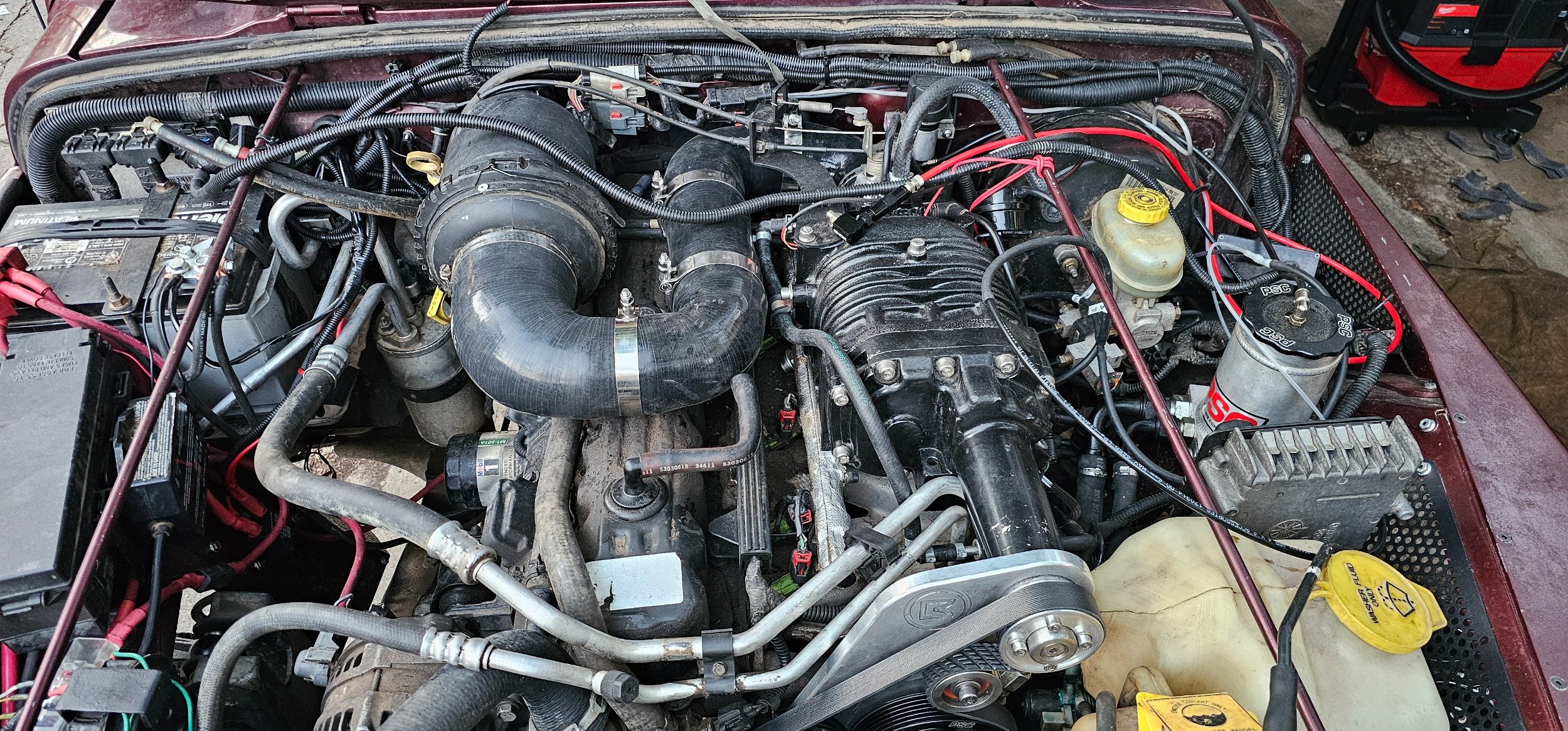

My recollection is that the header tape I used on the Windstar canister and the remaining factory intake tube decreased the IAT temps about 10°F. The later addition of hood louvers decreased those temps another ~10°F.
Both of these were in addition to the sizable decrease in IAT temps from the Windstar cowl intake all by itself. The big tell from those early days was that I could no longer cook burritos on the intake manifold and the hood stopped getting uncomfortably hot to touch.
It don’t take me long to realize that my hood got scolding hot to the touch. Installing the hood louver took care of that problem.
The louver helped drop my IATs as well, but my numbers aren’t useful since they were in the 170-250* range at that time.
The PO of my turbo had expensive thermotac wrap on the intake tubing and hot side charge pipe. None of that made sense since I was pulling in hot air from the engine bay and the compressed air going through the hot side of the charge pipe was hotter than the engine temp.
I later realized why wrapping your CAI made sense…because it’s a CAI and you also don’t have hot compressed air flowing through a lengthy tube in the engine bay. (I should have noticed that right away but I didn’t understand your SC setup).
