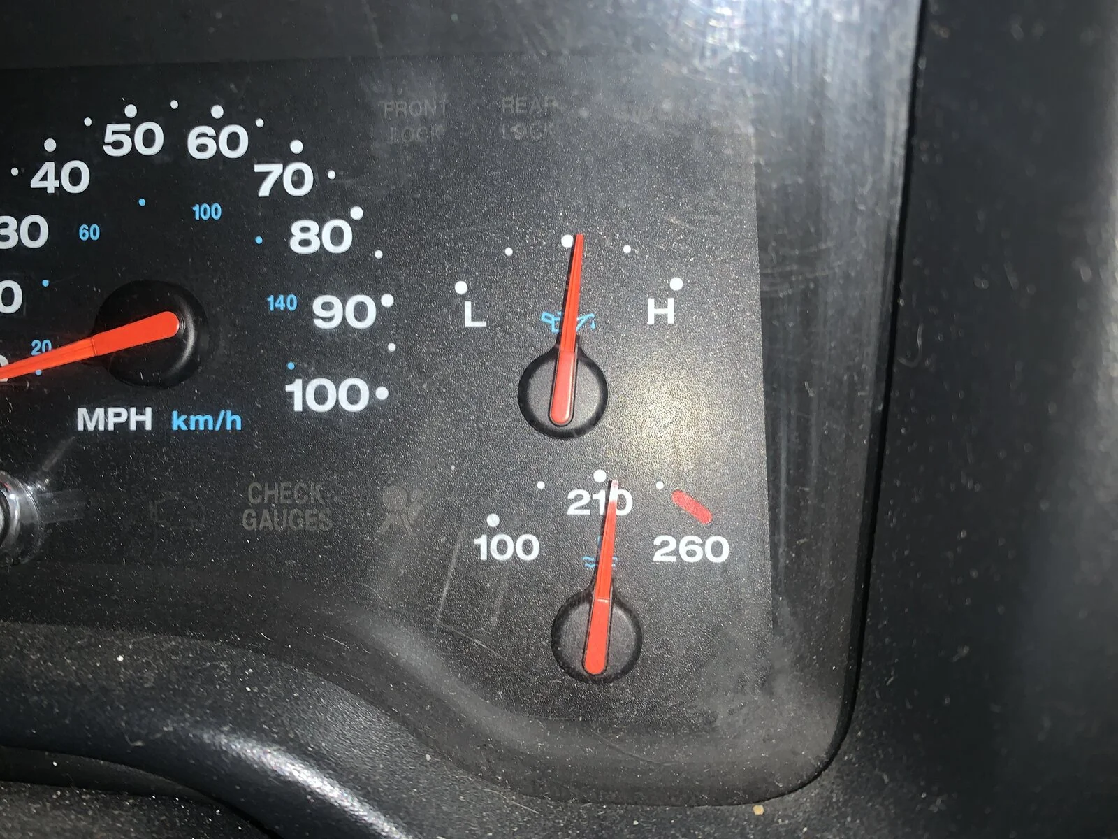

deal fellow TJers, I am looking into my TJ (4.0,42RLE) in which I am running new radiator, new coolant, new Hayden fan clutch, with properly working AC, and a winch mounted in the front. Thermostat and water pump seems to operate as expected, so don’t believe that I need to replace them.
What I see is that in stop and go traffic it gets always beyond 210, the same when parked in idle, even at the evening, with 87F outside.
I am in Houston area, so temperatures here easily reach 100F during the day. Also, as we all know the summers are getting hotter, so I am thinking about how to improve the cooling.

Aside from cooling the transmission (which you should do), you’re trying to solve a problem that doesn’t exist.
Your TJ was designed to operate just fine in the Texas heat. As long as your cooling system is maintained then you’re just fine.
Again, trying to solve a problem that doesn’t exist. That may not be what you want to hear, but it’s the truth.
As for louvers, I like they way they look and they did slightly drop the temps under the hood, but it wasn’t anything revolutionary.
The temp gauge in your photo is 100% normal for this time of the year in traffic.

For some reason I thought that it should never go beyond 210F and that it will blow up in a minute.
How do you identify potential overheat then? Is it when the temperature goes further from 210F?

As Chris posted above; the factory cooling system is designed to operate is a variety of temperatures WHEN the system is operating properly.
IF that is the operating temperature of the engine even when the outside air temperature is 87* as you posted above; then there is something that is not performing properly.
When you replaced ALL the parts listed above; did you use a chemical cleaner when you flushed the engine?
Take another look at the cooling system parts that you didn't replace previously.
I would recommend replacing the thermostat with a quality part such as STANT; ensure there is a pop it valve in the thermostat body or drill a 1/16" hole in the flat section of the body to assist in the system burp after refilling the coolant. You do not need to drain the system when replacing the thermostat; only lower the coolant level in the radiator (about 2 quarts) below the upper radiator hose.
Check into replacing the temperature sensor on the thermostat housing with a OEM Mopar sensor.
