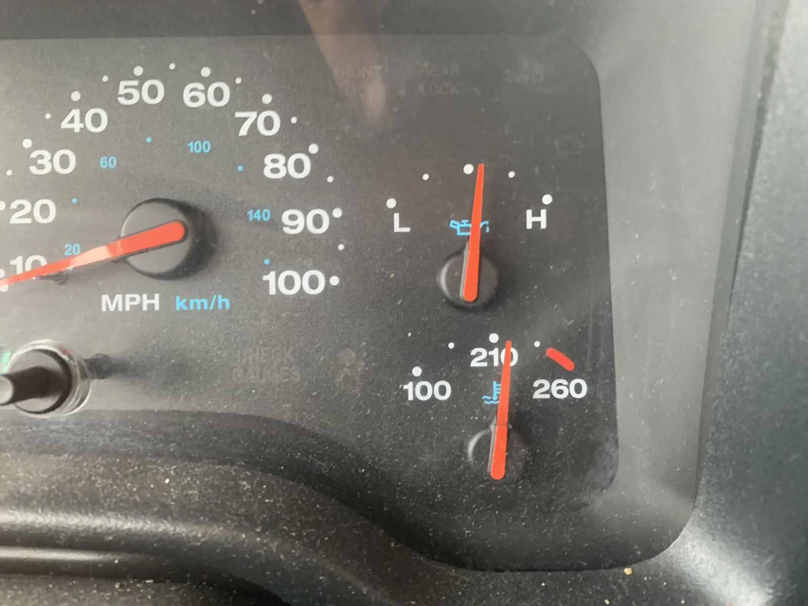

This is where it reaches in idle with AC on.
AC off improves the situation.
If I activate the heating in t he cabin full blast, it puts the temperature into the normal range.
As was said, this is perfectly normal. I've cleaned my cooling system, used a Mopar radiator and waterpump, and replaced the fan clutch and all other cooling system parts. In 97 degree heat, bumper to bumper traffic, and the A/C blasting, that's where mine sits. I'm not in the least bit worried!

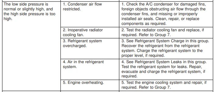

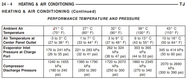

If you go into the FSM (https://wranglertjforum.com/threads...ice-manuals-fsm-technical-documentation.4618/), it lists the expected AC performance.
I am using manifold to measure AC hi and low pressure, thermometer to measure ambient air inlet on radiator grill, and small autozone thermometer for AC vent outlet.
I have verified that when engine is not too hot (right on spot with 210F or lower), the AC hits the precise performance metrics.
The moment that it starts getting hotter, it is unable to hit the relevant metrics.
Checking the pressure in the manifold, I see that we go into the territory of low side pressure as expected, and high side pressure too high (out of spec).
I have excluded the overcharging, as i know the quantity of freon that I have added, and I have been tracking the pressures when adding freon.
Judging from the FSM's definition for AC performance, the cooling system is not operating as expected in the attached picture, as it is unable to move away the heat from evaporator.

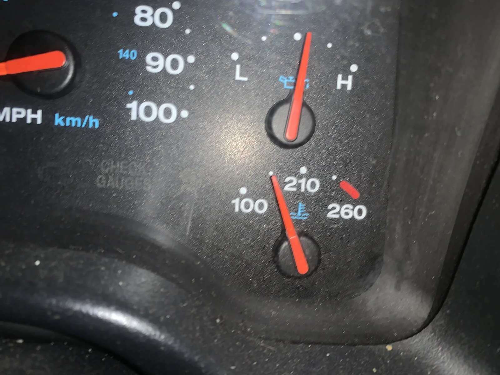

Right now I am doing a flush. For sake of experiment, I have removed the thermostat, and running distilled water only. Need to run it like 10 minutes for flush purposes. The temperature does not even cross 150 of thermostat is removed.
My understanding from this is that the thermostat was messed up.

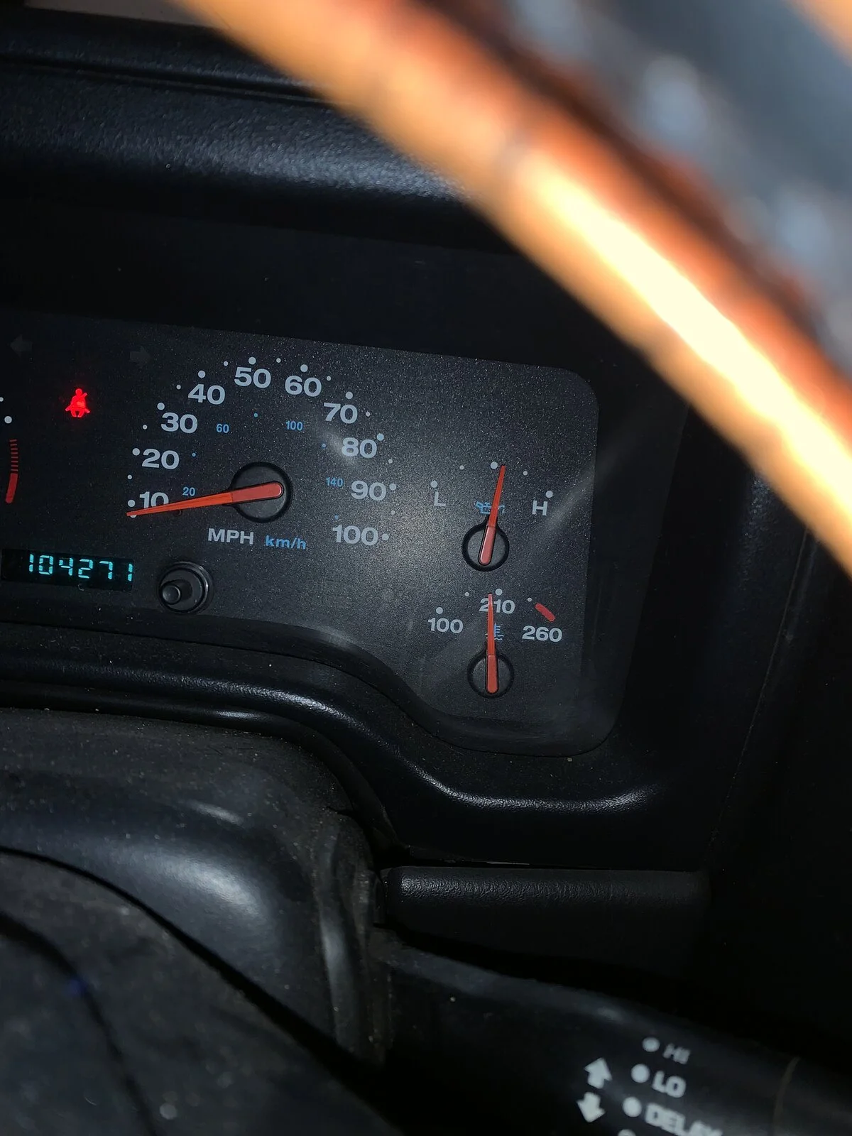

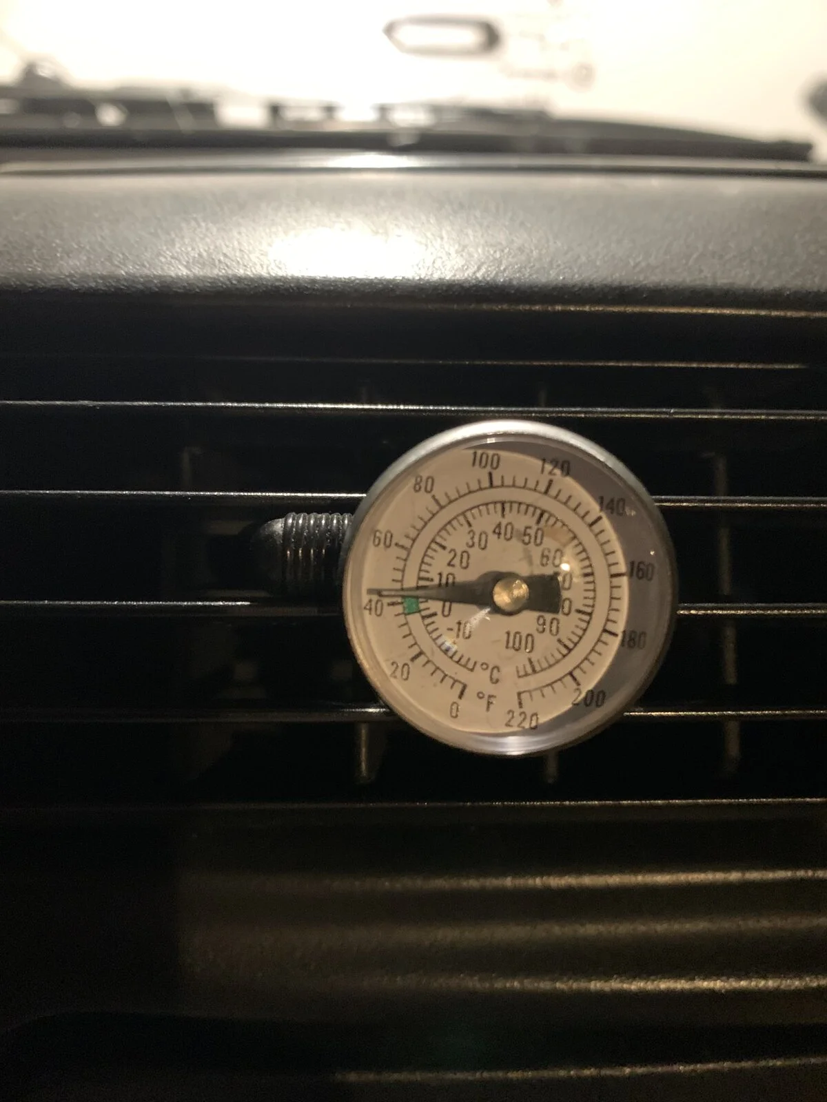

And now,. With full AC on, blasting 100%, max cold, hood open, the AC temperature is in the spec range, as cold as it should be, hi and low pressure are where they should be.
If with removed thermostat this thing can cool itself inside my garage ( the garage is open, but it is still very hot over here), maintain the AC temperature by the spec, and also the engine temperature under 210F, this definitely points to thermostat.

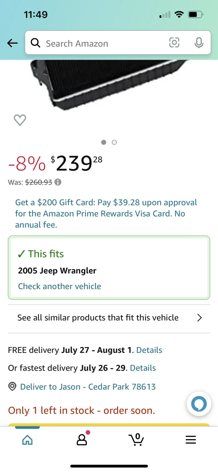

I’m going to be a jerk here. One site or two listing “discontinued” doesn’t mean they aren’t out there. Literally Amazon has a listing with 1 left in stock right now.
You have to search a little. I’m sure eBay has some, I’m not going to look there too, but if you want your Jeep to work right, I’d get on it asap.
DB04RedJeep
Jun 22, 2022
91
Worcester, MA
As @cpwolf said they are available. Ordered one on Tuesday night from Amazon (manual transmission) and it was at my door Friday mid day in a factory unopened box brand new.
Damn, that's some cold A/C! I can never get mine below 57-58* this time of year,
