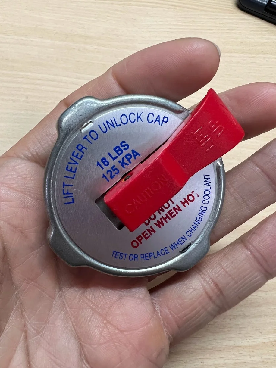

So last night, on a hunch from a fellow Jeeper I decided to swap out my radiator cap for an old spare I had in my parts bin. Guess what...THE LEAK STOPPED!
I've driven the Jeep over 25 miles since then on highways, and through stop and go traffic, and to my surprise it hasn't leaked a single drop of coolant! :oops:
Could the excessive pressure I had in the system, which blew up my radiator have been due to a blocked cap? If so, is it possible that after I replaced my 20 year old radiator the pressure then moved on to my non-MOPAR water pump and gasket which were the next weakest link? It's crazy but I haven't even changed the gasket yet, and its holding with the new cap.

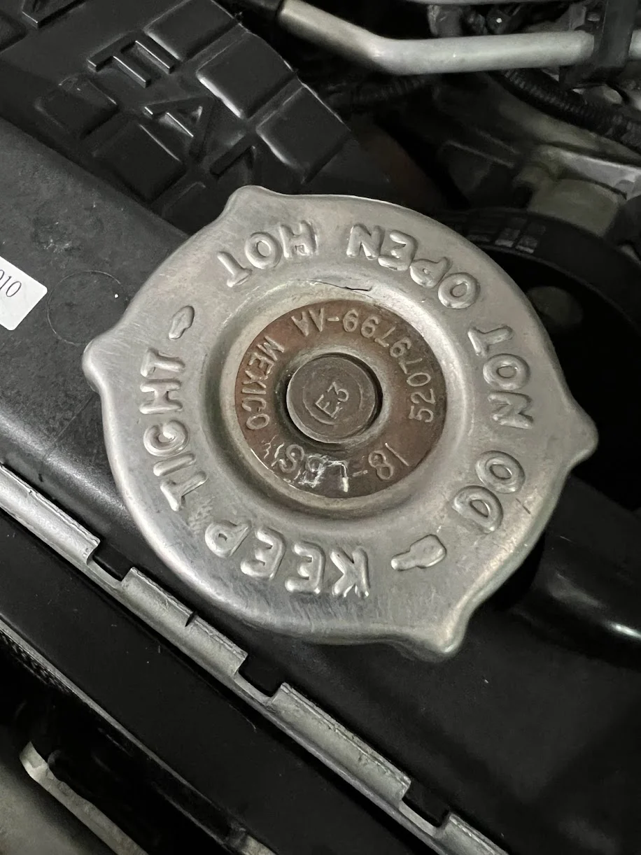

Here's the cap I installed about a year ago.
And here's the spare cap I put on last night.
