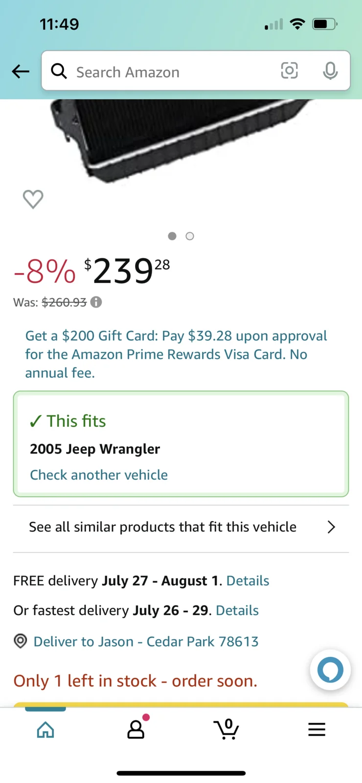

I’m going to be a jerk here. One site or two listing “discontinued” doesn’t mean they aren’t out there. Literally Amazon has a listing with 1 left in stock right now.
You have to search a little. I’m sure eBay has some, I’m not going to look there too, but if you want your Jeep to work right, I’d get on it asap.
Thanks a lot. I kinda missed the part that when Mopar discontinues, some still have stock.

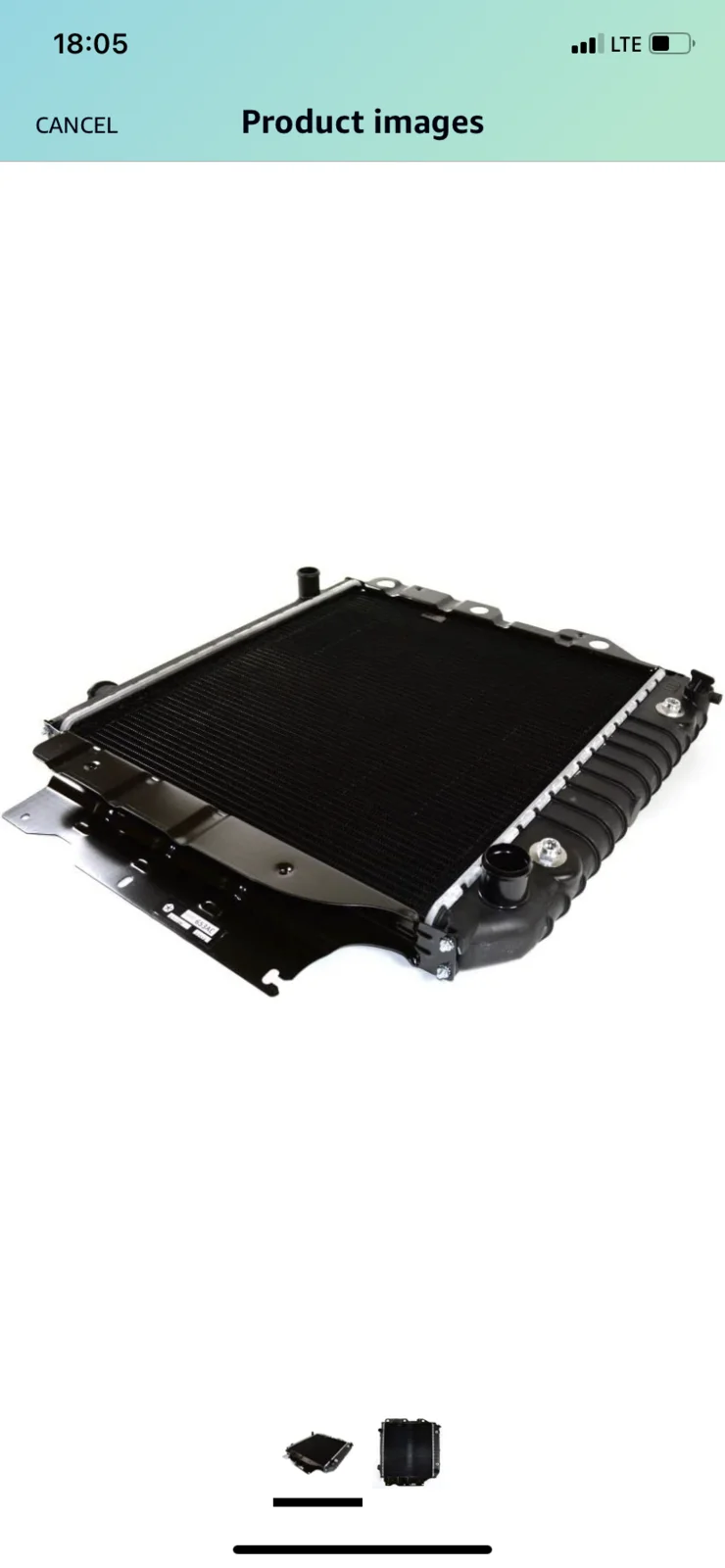

Just bought this guy on Amazon:
55037653AC​
It is for 2005 automatic, but as you advised, I will adapt the transmission cooling lines.
