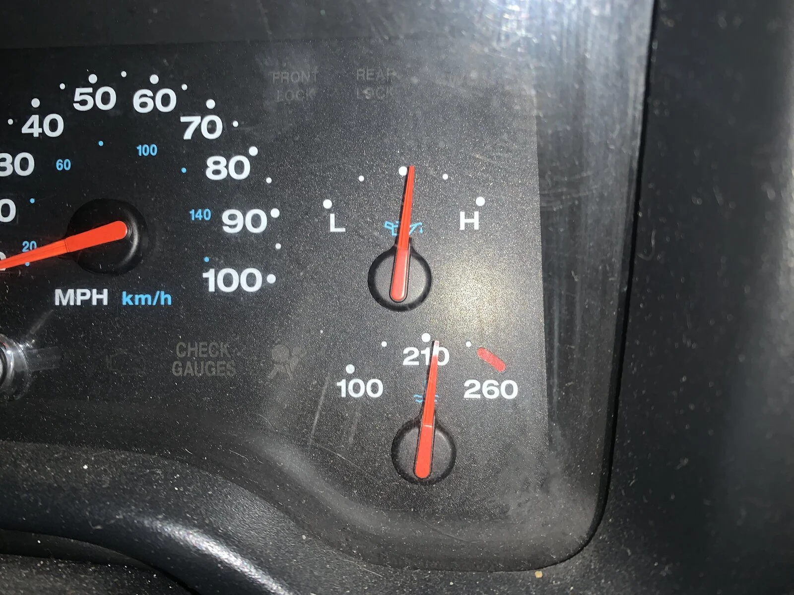

deal fellow TJers, I am looking into my TJ (4.0,42RLE) in which I am running new radiator, new coolant, new Hayden fan clutch, with properly working AC, and a winch mounted in the front. Thermostat and water pump seems to operate as expected, so don’t believe that I need to replace them.
What I see is that in stop and go traffic it gets always beyond 210, the same when parked in idle, even at the evening, with 87F outside.
I am in Houston area, so temperatures here easily reach 100F during the day. Also, as we all know the summers are getting hotter, so I am thinking about how to improve the cooling.
I have one step already on my schedule,. Which is adding Derale cooler for 42RLE, which will prevent the 42RLE from overheating.
Other step that is planned is to install louver (Poison Spyder), that will help to reduce the heat soak and heat buildup in the engine bay.

I know newer model fords would turn on the cooling fan at 221 degrees. If you are really concerned about it, look into evens cooling system fluid. I know people who have used it and were happy with it. It is a major undertaking all the water must be removed for it to function properly.

At this point my plan is flushing the engine with prestone and thermocure, Mopar radiator and Thermostat, stay with Hayden 2771 clutch, not to change the water pump (it works fine, tested the flow), exhaust gases in coolant tests, then drain it completely (engine block drain as well), pressure test positive and negative, and then to suck in the coolant through the tube. This is how factory fills coolant, will do the same, this is the best method to verify that there is no air in the system.
The lover also goes in. If it does not cool well after all all this, exhaust back pressure test, if still not then small auxiliary electric radiator (found a heater core for YJ with 6 inch electric fan to cover for idle.

Have you verified the gauge?
