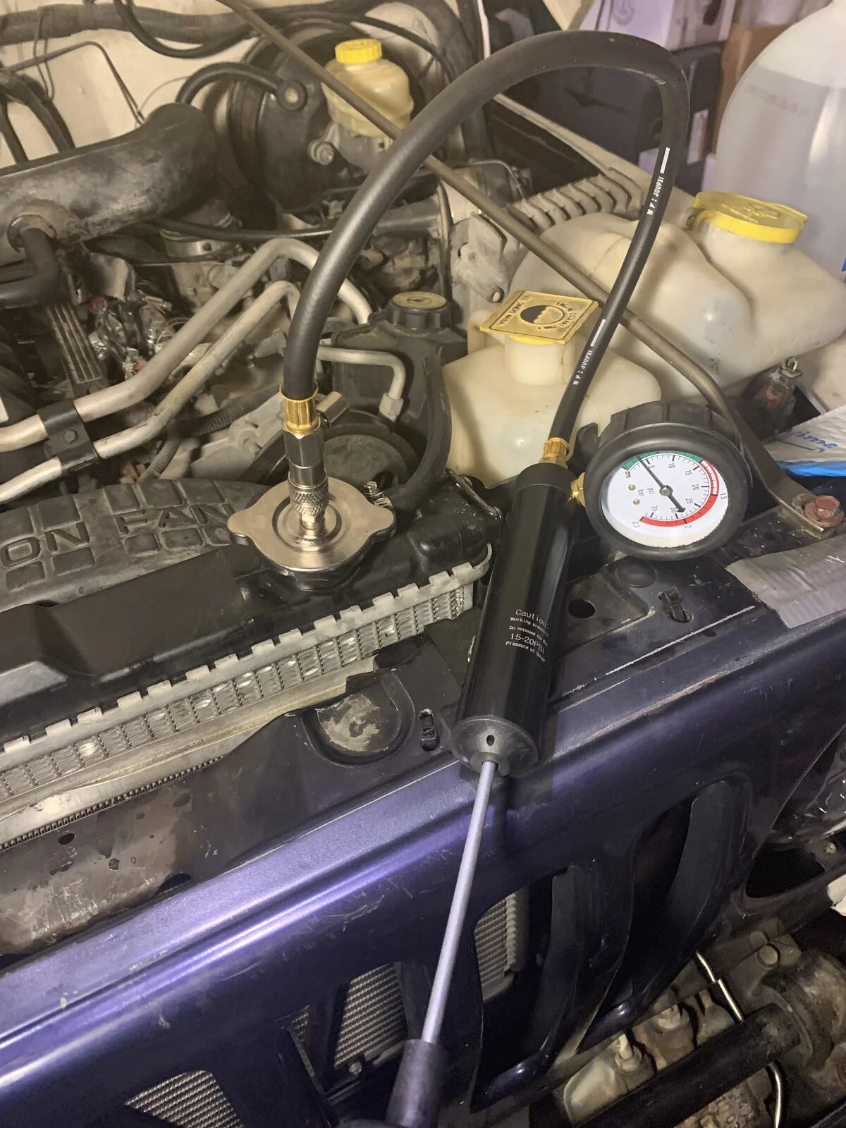

I think that I have found the root cause for my overheat problems.
I bought this kit for 90$, OIMERRY 28PCS Universal Radiator Pressure Tester for Vehicles, Vacuum Type Coolant System Pressure Leak Tester Kit https://a.co/d/5d7w88n
And ran positive pressure test. At around 13 PSI, I see that the coolant started to leak from the heater core.
I am currently running distilled water with thermocure, so my cabin stinks of thermocure, with this thing mainly pouring under the Jeep from the tube that is supposed to be for condensed water from AC.
With leaking heater core, it is not able to build proper pressure of coolant, and this brings air into the system.
I wish I had run this test before I replaced the fan clutch, before replacing a thermostat and before ordering a new Mopar radiator.
My lessons learned - always run exhaust in coolant (which I didn’t run yet) and positive pressure test. If any of these fails, no point in replacing half of the cooling system.

Were you having to add coolant when you initially started trying to get your engine to run cooler or could you have possibly busted your heater core with your new toy? I have seen people over pressure cooling systems and cause problems they didn't have before.
The original problem was potential overheat. In idle it would start overheating with AC, and also when running on highway, under load if would star going beyond 210.
Took out the thermostat, and started flushing. When flushing, I saw the bubbles never disappear. Coolant small in the cabin was present, but was not really strong.
Then I drained everything, including the block, and filled with distilled water and thermocure. Bubbles never stopped.
Started to feel the stink of the thermocure in the cabin, and suspected the leak.
When the I opened the radiator it was missing maybe half quart of coolant.
Investigated in the cabin, and found the coolant on the carpet in the passenger side.
Positive pressure test reached 13PSI and started to see the leak from heater core.
I think that coolant system is expected to hold pressure up to like 15PSI. This happens when radiator cap blocks the radiator and the coolant still tries to expand. The goal of keeping the pressure is to prevent the coolant from boiling, as increased pressure makes it less likely to boil.

As for the positive pressure test:
This is how it is done (not my video):
He was losing 3 PSI, I was losing it in couple of minutes.

Finally got my heater core delete kit. Will install it and will rerun t he positive pressure test with 13 PSI to verify that nothing else is leaking

Installer the heater core bypass and rerun the pressure test. Now I see that I have a tiny leak from the thermostat housing (I am running flush w/o thermostat so didn’t bother to install it properly.
You can hear the whistle from thermostat housing
