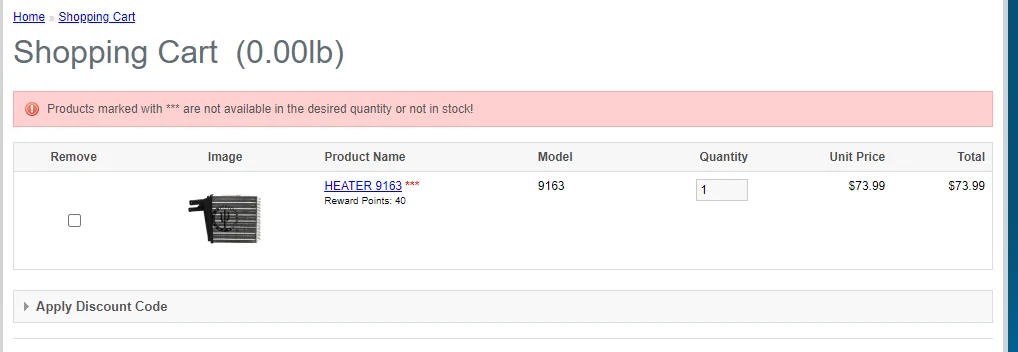

Performance radiator shows the later model tj heater core back in stock.
https://shop.performanceradiator.co...ath=1_22310_22822_22874_22876&product_id=8045
it shows in stock on the main page but then it's out of stock once it's in the cart.

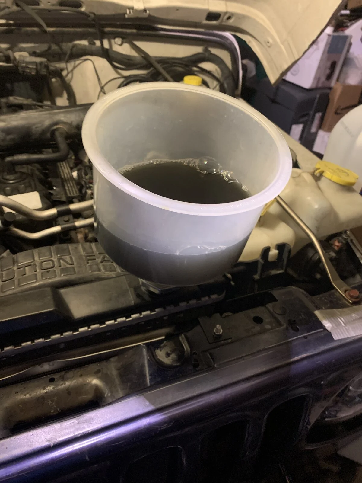

When folks told me that I might need a flush, I initially ran 3 sessions on blue devil. It didn’t really change a lot.
Now i am running thermocure. This is my first run, 3 days in total, with like 3 hours of running in total. The mix of distilled water and thermocure looks like this.
Thermocure responds to rust, and it seems like I had a plenty of it. Just look at how black it became.

Put 3 oz of water soluble oil in the radiator.
You will not have a rust problem in your cooling system again.
Thermocure looks like the water I would see after pouring muriatic acid and water into a barrel.
Then running it thur raw water cooled marine engines to knock out rust and salt.

Finished the first session of thermocure.
Kept it in for almost 5 days (didn’t have time to drain).
Mix of distilled water and thermocure simply turned black.
