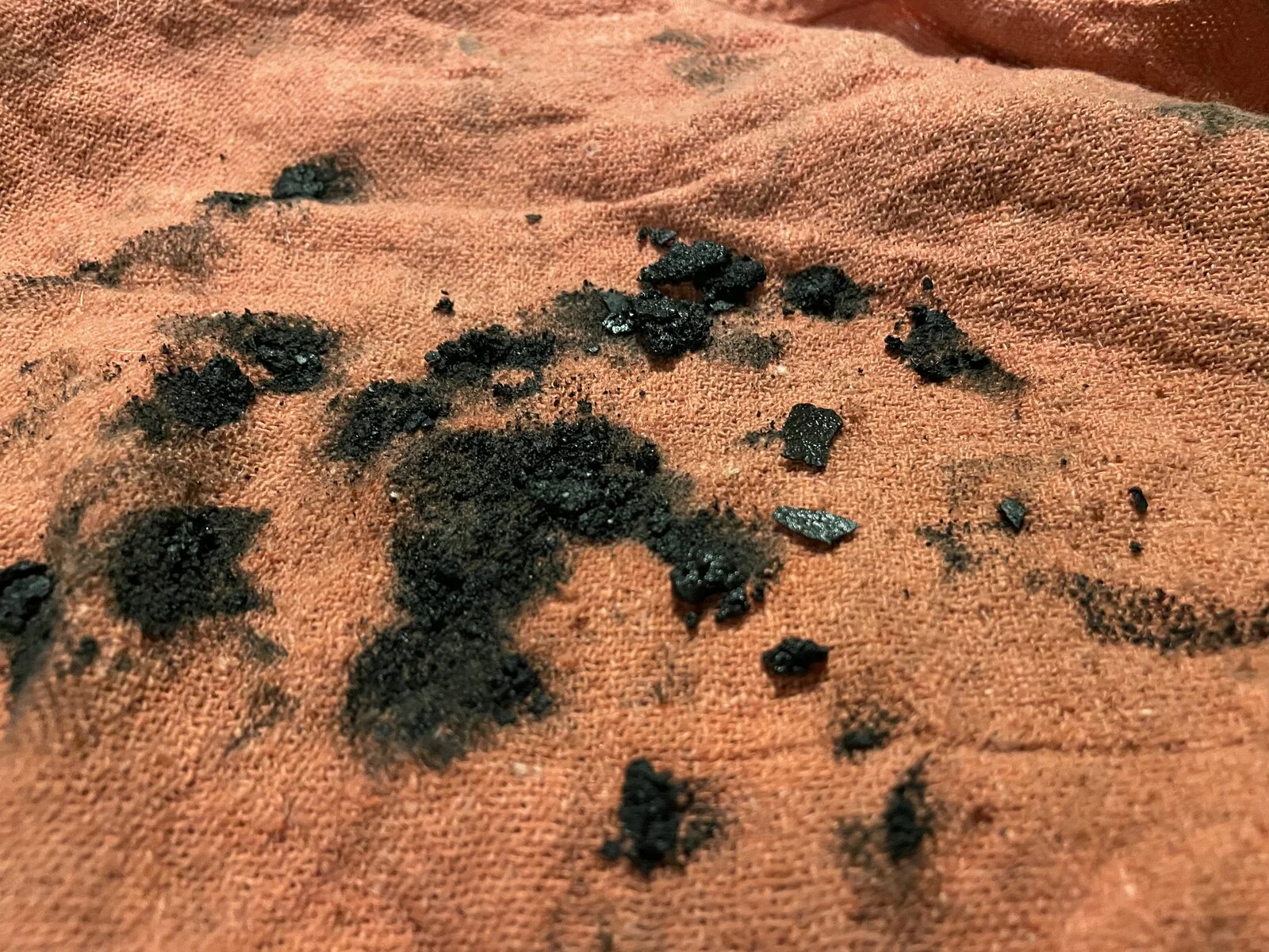

Pulled my drain plug and nothing happened at first. Odd.
Then I see something is blocking the flow, so I push whatever it is in with my 8mm socket.
After the flow stops, I stick a magnetic extender in the hole and I get gobs of ferrous material.
Any idea where this metal could come from?
Is it the water jackets rusting away?

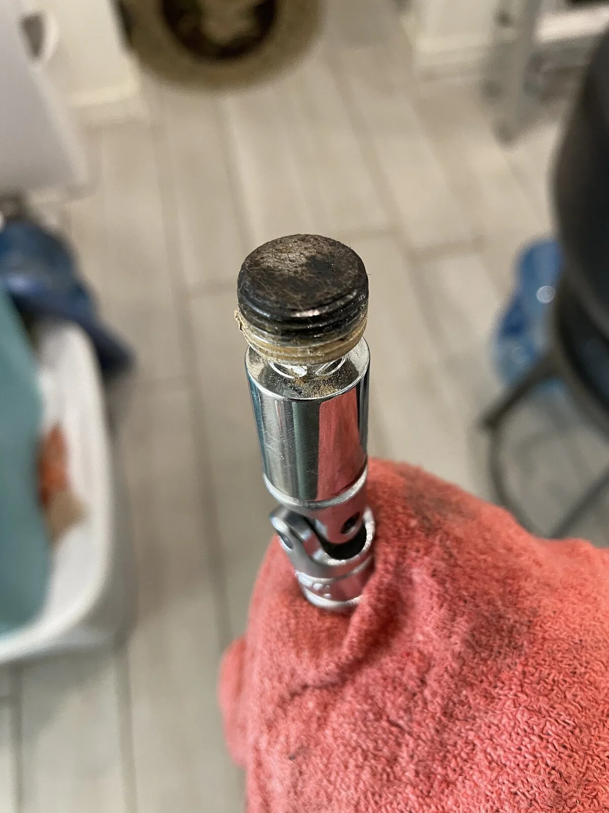

This looks horrible. No pieces of metal are supposed to come out. I didn’t get any. Do you have a picture of the thermostat housing as well? Do you have a picture of how the inside of drain plug looked like?
Probably just many years of rust built up and it finally broke loose. This was from the engine block drain?
Looks like a good time to do a thorough Thermocure flush.
Yes, from the engine block drain.
