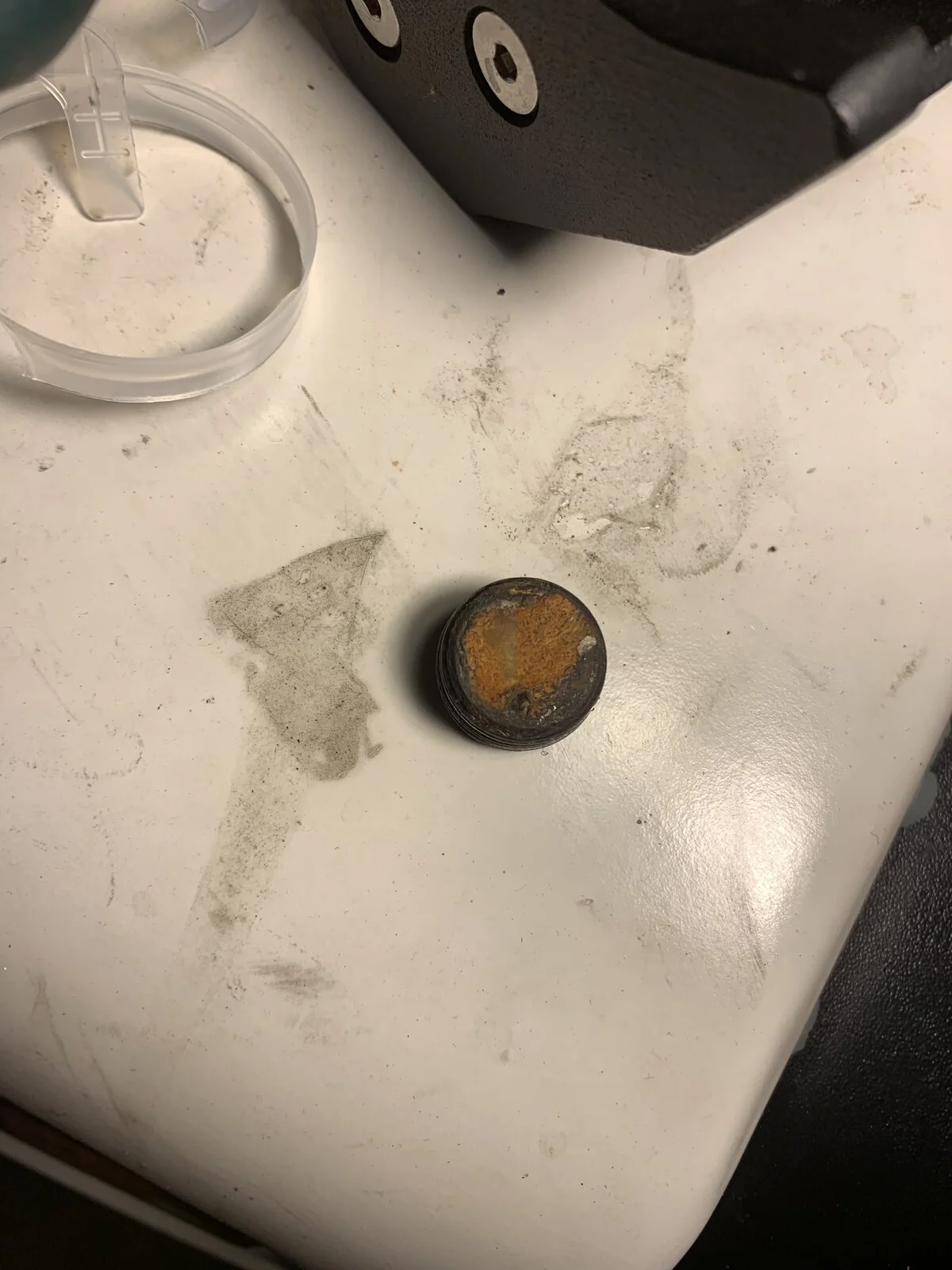

I started to deal with all my cooling system because my Jeep was running hotter that it should in my opinion.
In the process I found that I have a leaking heater core, Ton of rust inside the block etc.
in my opinion running good flush is always a healthy idea. Take into account that Thermocure removes only rust. You need something else to remove other deposits, I used BlueDevil.
When you remove the engine block drain plug , you can check how much rust you have on the inside. In my case I had quite a lot and thermocure removed all of it

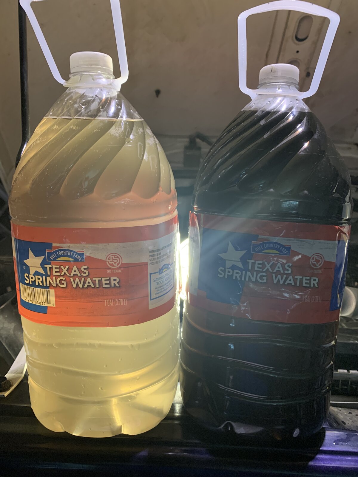

Thermocure is fertilizer and salt.
The Diammonium Phosphate is why the coolant is coming out black
Here is the MSDS
[/URL]
[/URL]
The issue is that if there is no rust, it does not turn black. Some of the folks here did 3 consecutive flushes with thermocure and in the second one the mix of water and thermocure came without any significant blackening.

difference between the 2 thermocure flushes. The first one on the right and the second one on the left. You can see that that the second there was almost rust,. So it didn’t turn too black.
