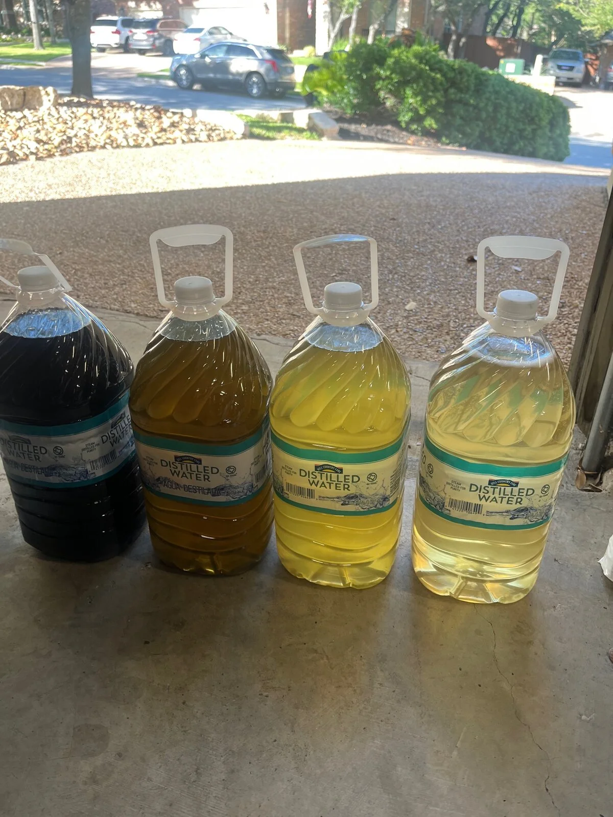

I ran so far 3 flushed with BlueDevil, it didn’t seem to matter too much, as the color of the distilled water that I used in flush didn’t really change. I poured in Thermocure, and it it started to get black really fast. Are we expected to flush with thermocure till the coolant stays the same, and does not turn into dark black stinky thing?
This is the water after Thermocure. Left after first, and so on. Far right is probably good to go, but I drained one more and didn’t take a pic, was slightly clearer.

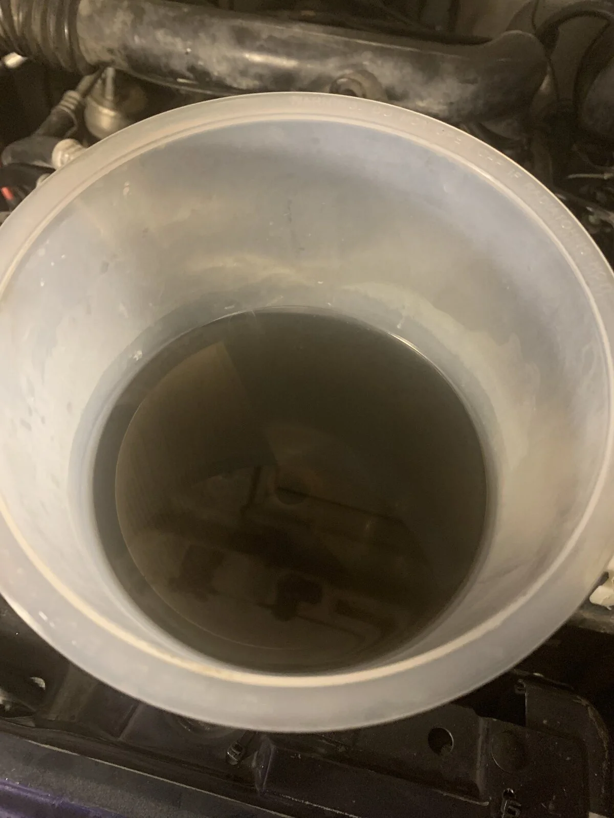

I just ran thermocouple for like 20 minutes, to burp the air.
And this is what I get:
I ran thermocouple for 1 1/2 days. Not saying I did it right, but this stuff reacts to rust. I’ve cleaned a lot of parts and BBQ smoker parts with Vinegar, and a few others that are more expensive, it takes 12 hours to a couple days to get a serious cleaning. I thought the bottle said 3 hours up to 3 days, but I don’t recall exactly. It obviously got some, but it was obvious to me that the stuff worked on it after a few days. Stunk to high heaven as well.
