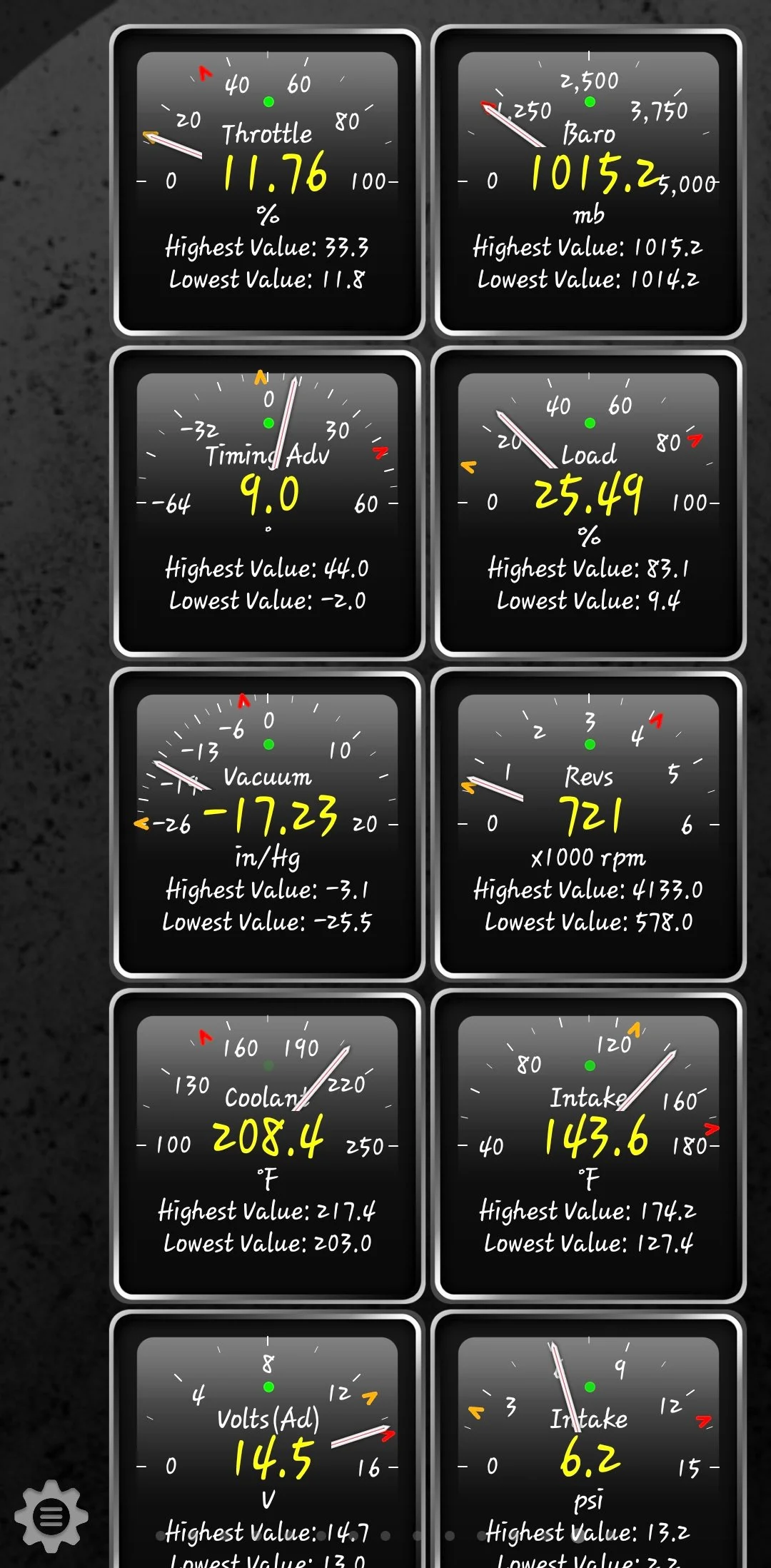

Yesterday, my ECTs were 212* doing 93 mph on the highway with ambient temp at 92*...with Thermocure and distilled water in the system. I flushed the radiator and heater core again yesterday after dropping the Thermocure. I then added an in-line coolant screen after finding an option and configuration that works well for me.
I flushed the radiator a bunch more today because bad stuff kept coming out using the flush gun, then Thermocured it again I then dropped the Thermocure by running about 20 gallons of distilled water through the system.
My hope is that the ECTs will be pretty nice and sustainable moving forward.
Things are looking pretty good right now.

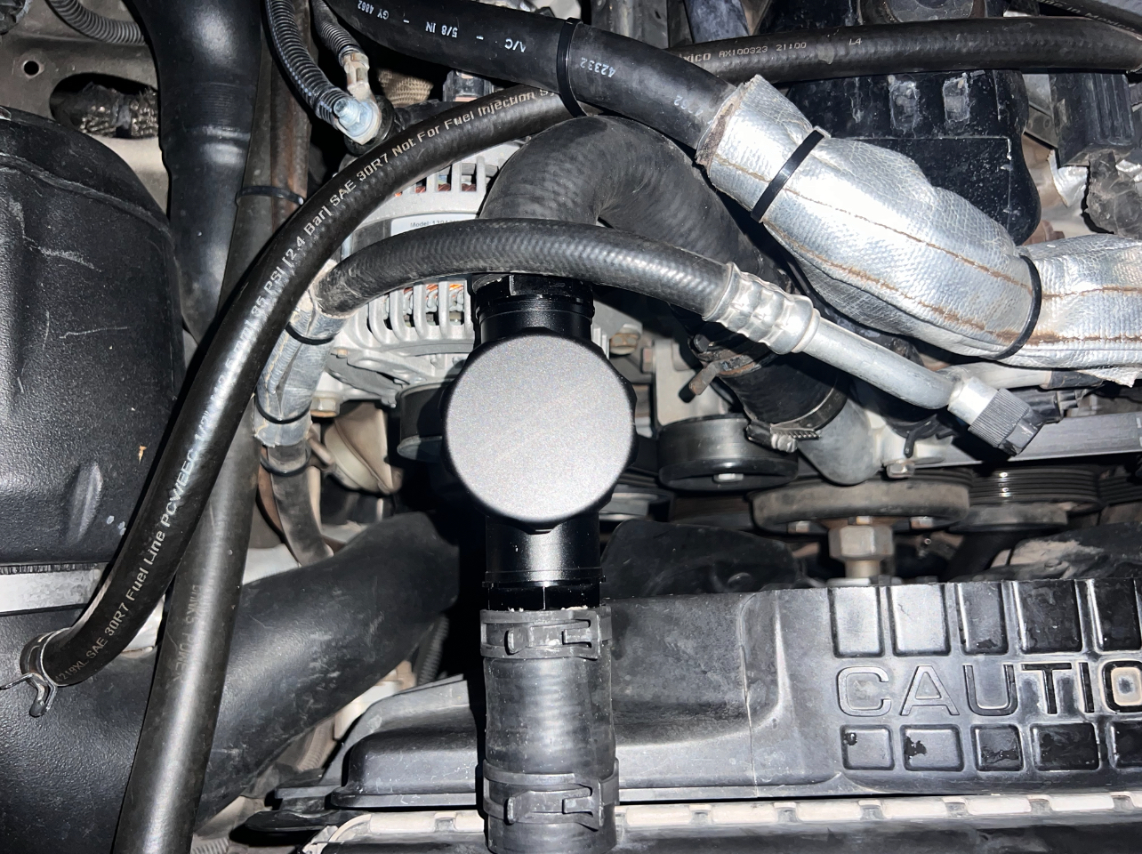

The coolant screen makes the water & coolant filling process much nicer because opening up the cap lets bad stuff out and helps reduce the air gap. Reducing the air gap results in the thermostat opening up way sooner, so there's no need for me to pull the thermostat to speed up the process when doing many flushes.

I originally planned to run 1.25" barb fittings at the upper radiator hose, but it was too long and I didn't want to stress the top port on the radiator.
These are the -16 ORB-to-3/4" barb fittings I went with.
