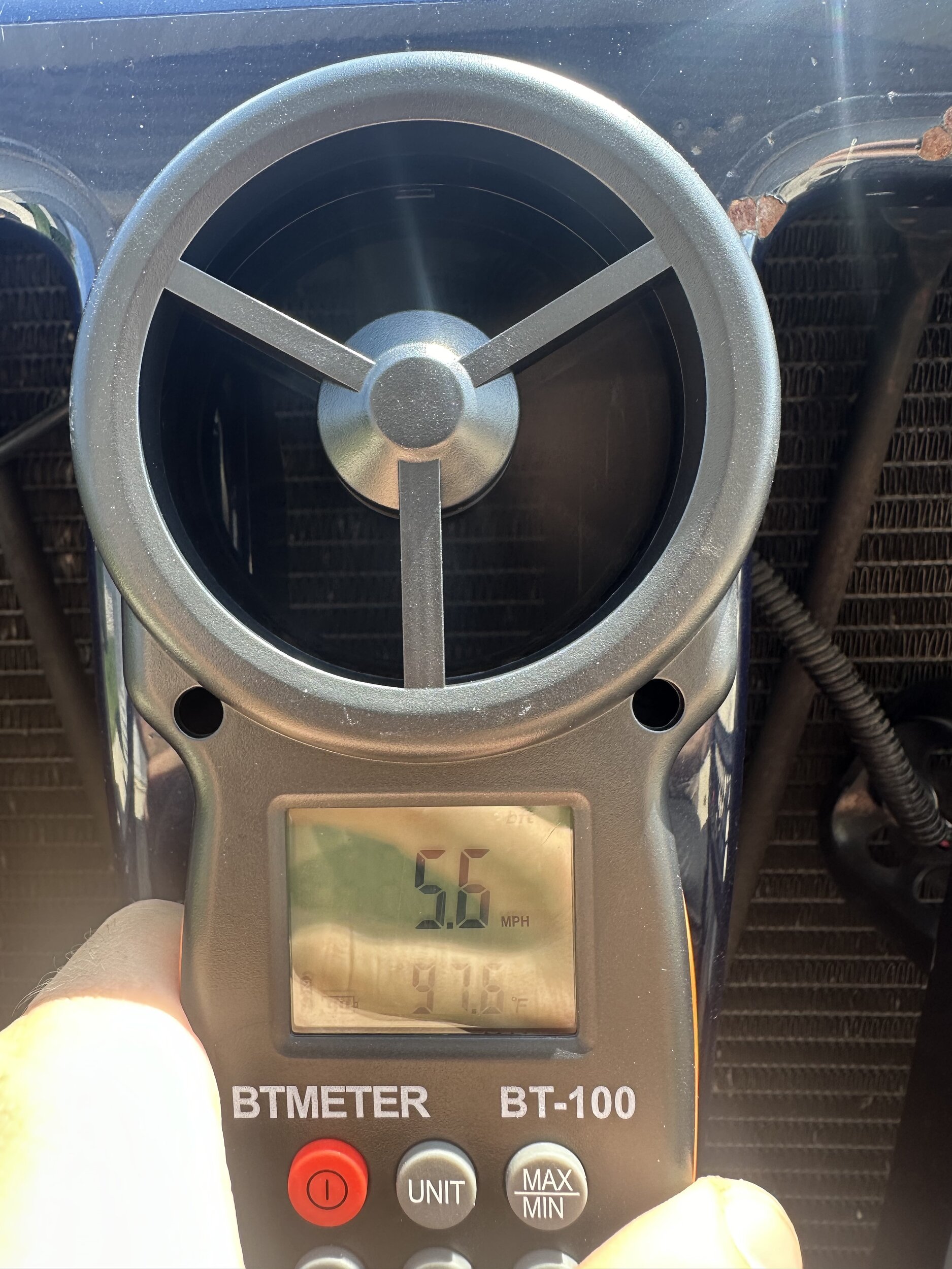

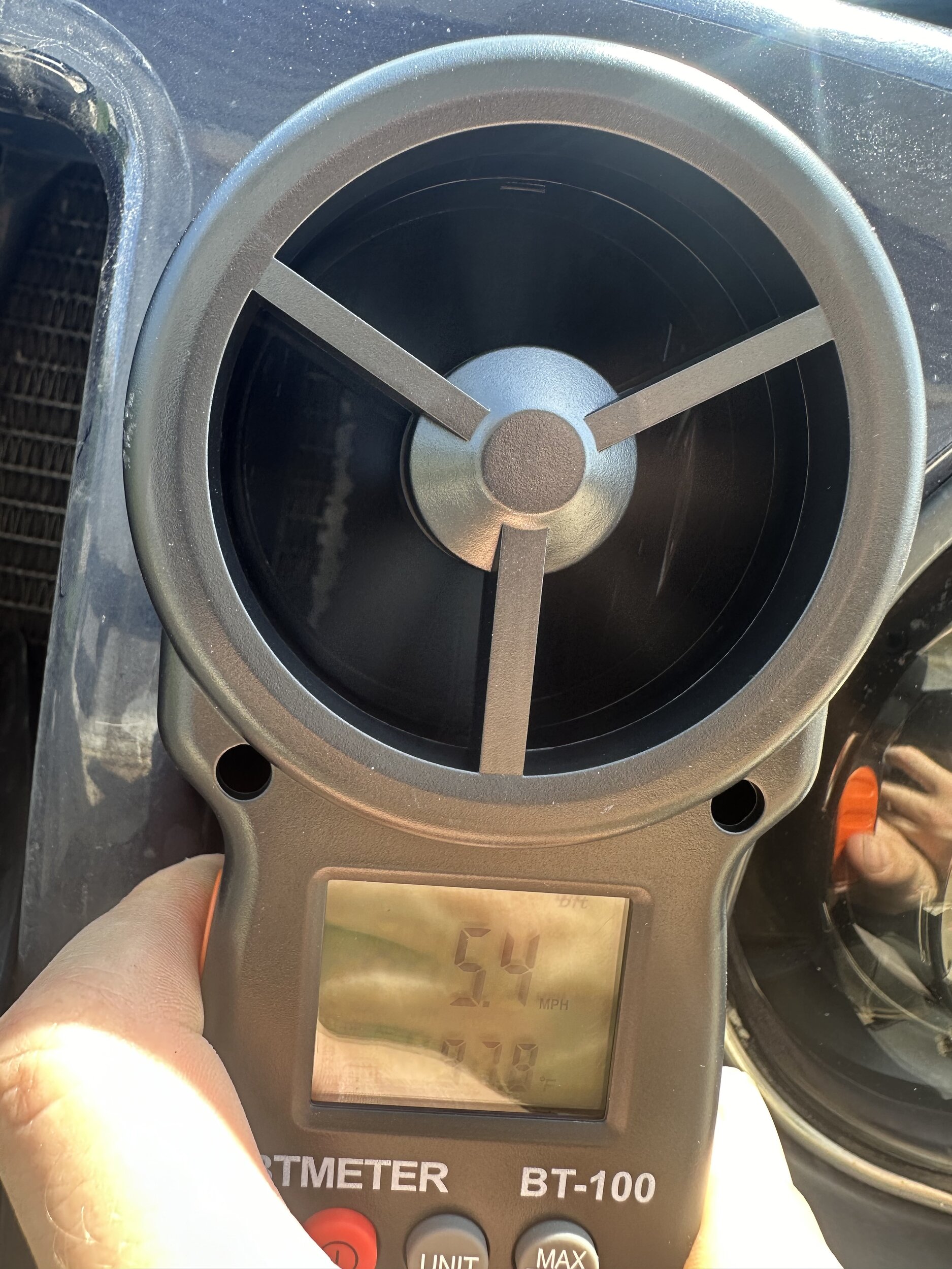

These are the wind speed numbers I got on the meter lmk what you think. I had the meter against the grill meter shows 97f as the temperature of ambient air those numbers were also pretty consistent across the whole grill from 5-6 mph this was after heat soaking the system and ac full blast idling for 30mins ect at 215f

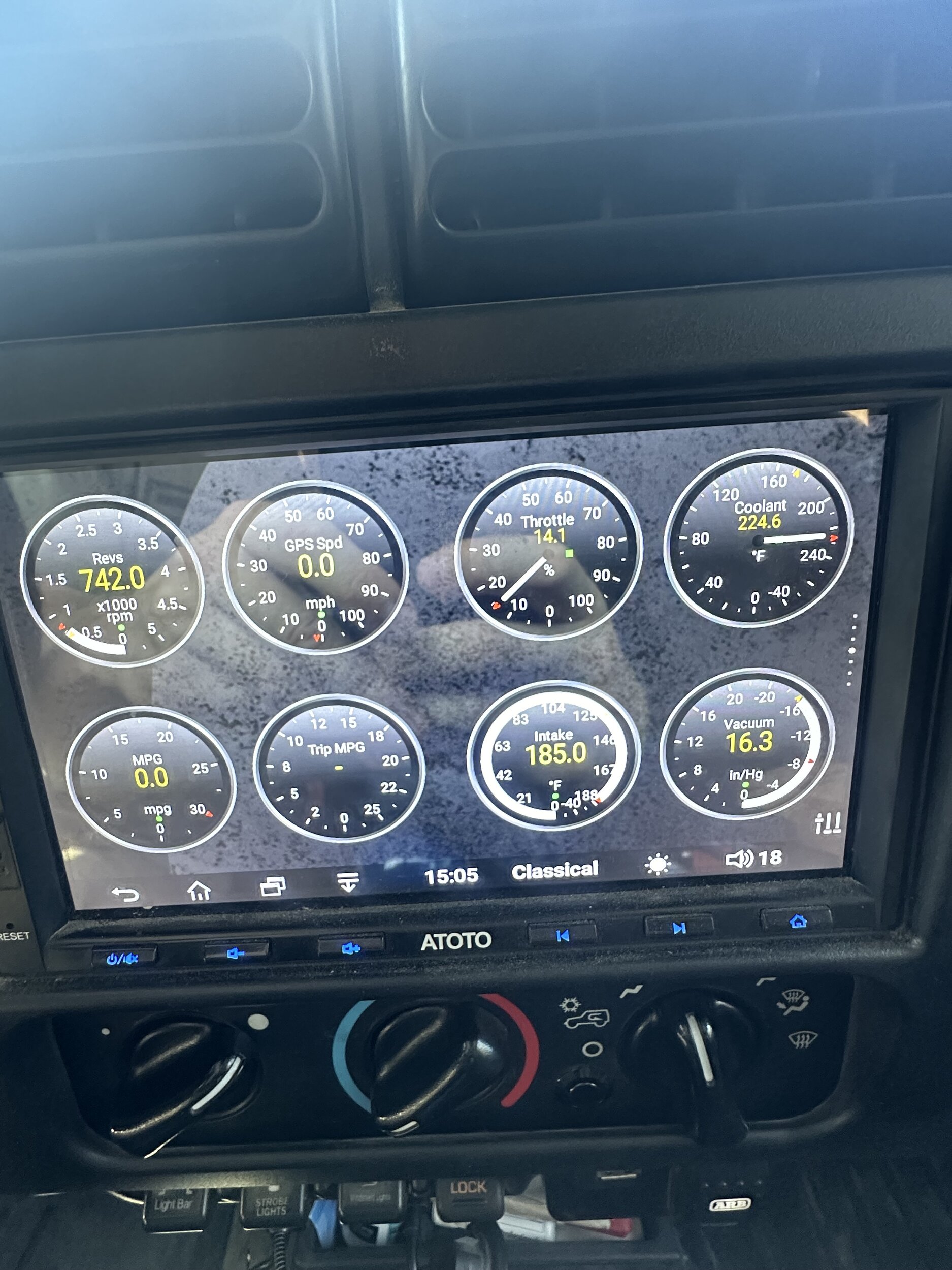

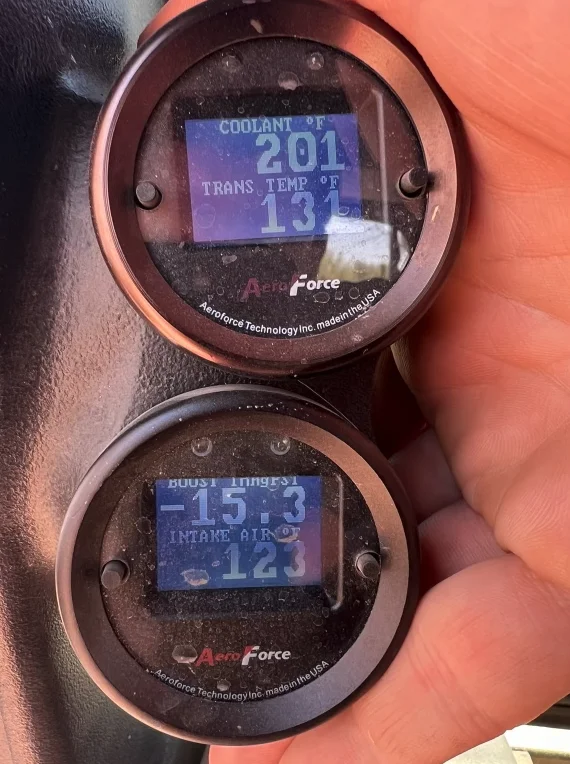

Sounds good to me let’s keep this scientific as possible guys I get that many of your jeeps cool fine but bring actual data to compare not just (my gauge say so) plug in a scanner read the actual temps tell us what your jeeps cooling system is don’t lie to try to make your look better that helps nobody but your ego I’m trying to build a reference for all Tj owners.

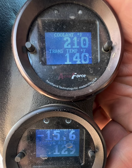

I have enough inout from the stock gauge, I know the gauge isn’t accurate and I know they apply a bell curve to make it stay near “normal” but I been looking at these gauges for 18 years, I know what’s warming up, normal, warmer than normal, I can characterize when the thermostat is full open. Also, AC performance is affected by things such as fan performance (clutch and blades) as well as radiator heat saturation, a cooler radiator helps the AC get I bit cooler.
Accurate numbers from a legit gauge don't lie. I'll take them over your guessing and less useful pattern awareness (bc the gauge is all over the place and has latency built into it).

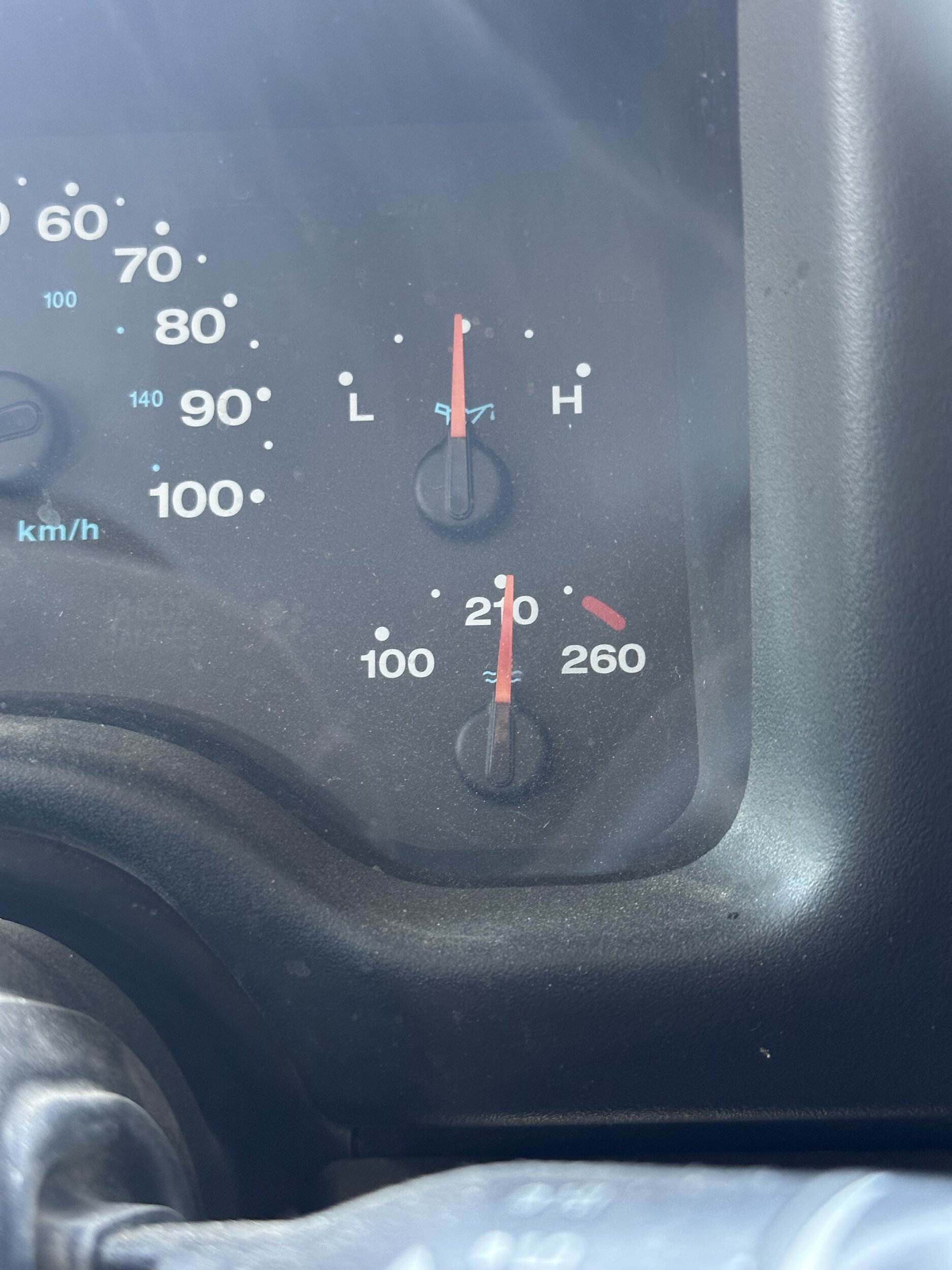

The issue is that I've seen my temps on the gauge look very different than what the stock gauge reports. There's no pattern to it bc the needle both under & over reports depending on the moment. Sounds ridiculous, but I've personally seen it many times.
I consider the stock guage to be a "things appear to be ok" gauge. Which is great for folks on the road who need to know that they are good. But not so good when comparing TJ to TJ performance because we are all seeing different patterns unless our gauges are accurate.

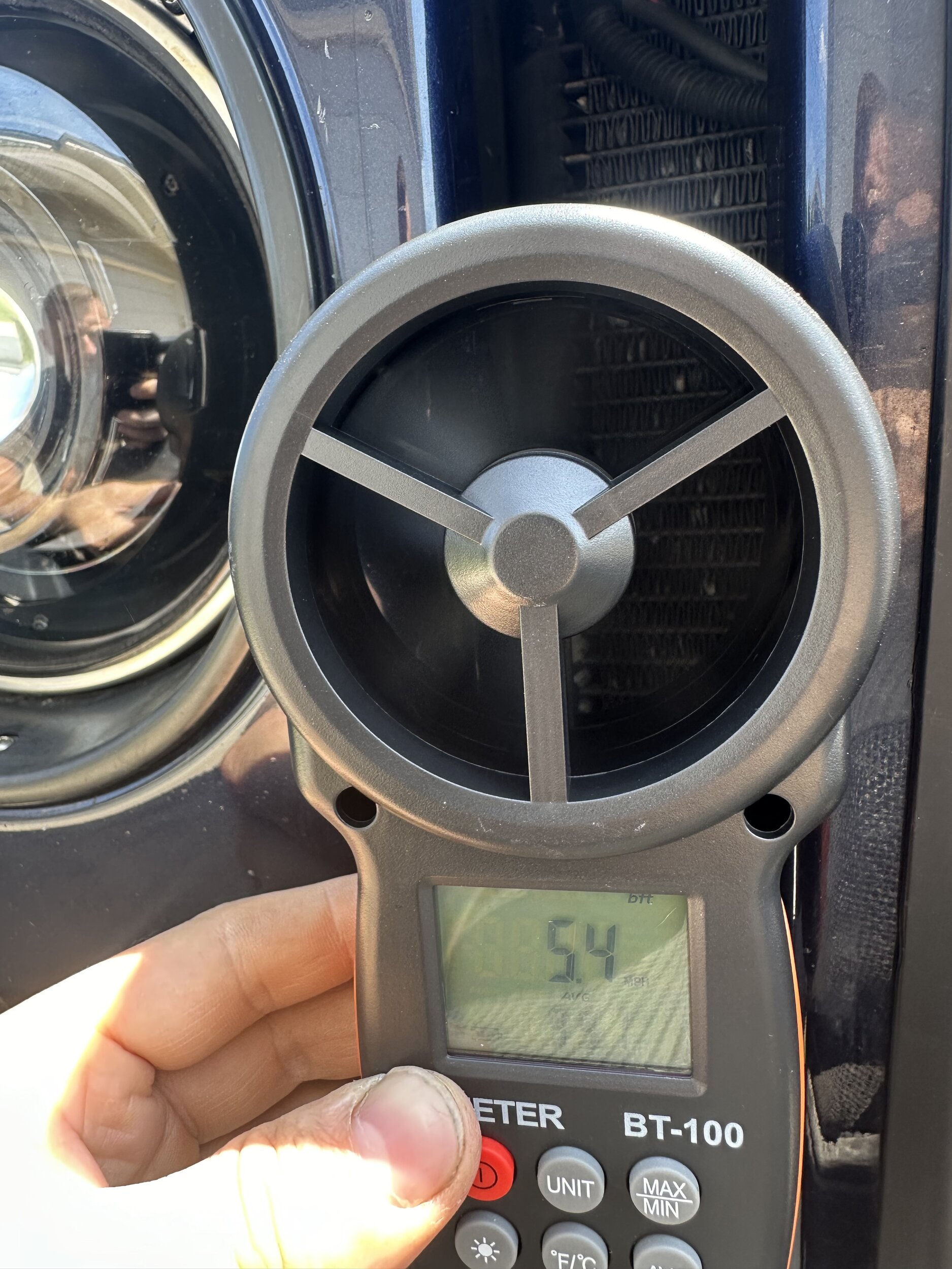

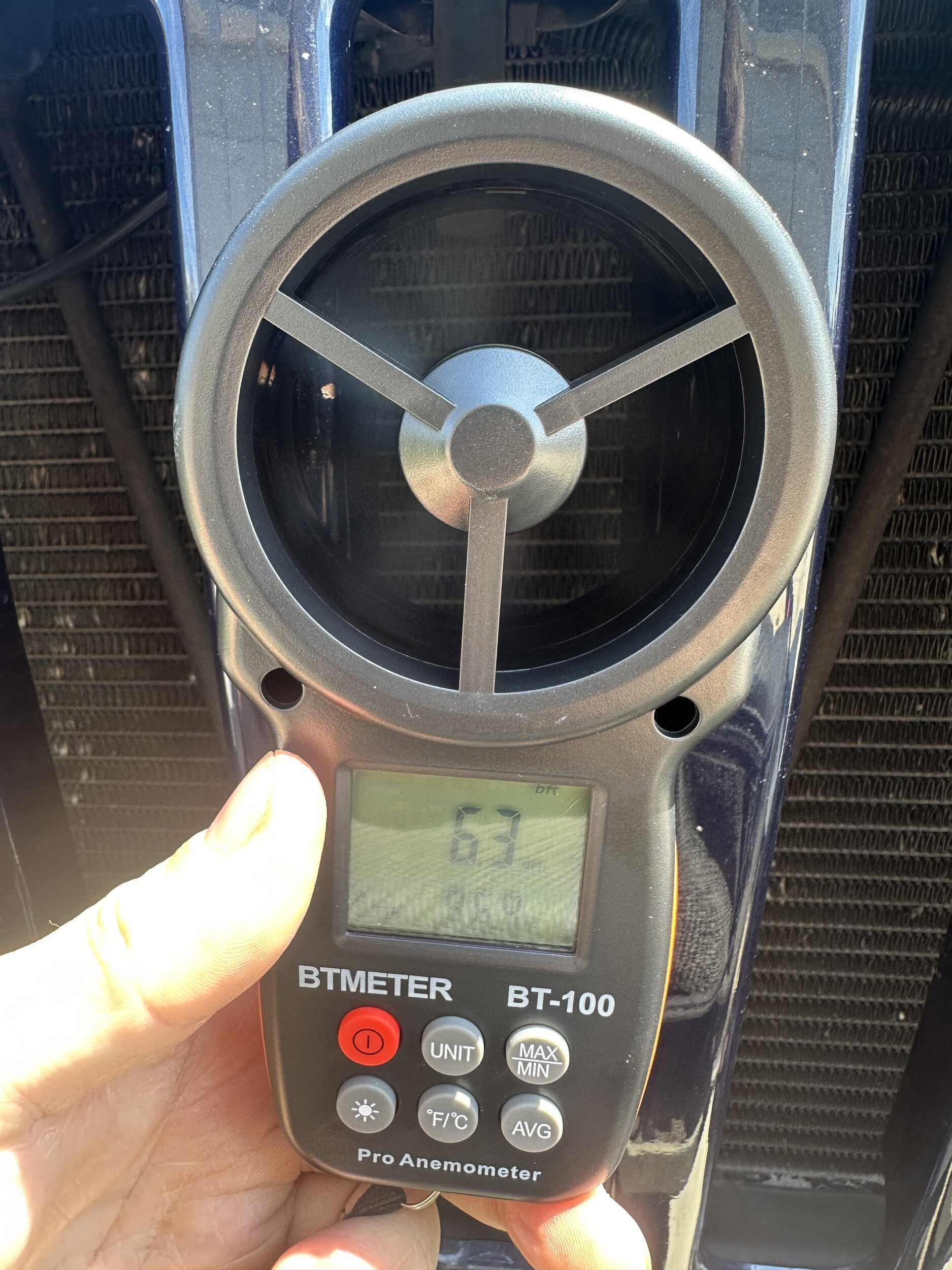

Ok 1 hour of idling a heat soaked system now here is what I have 224 on the digital gauge 97f outside temp on the meter and 6.3 mph reading on grill opening

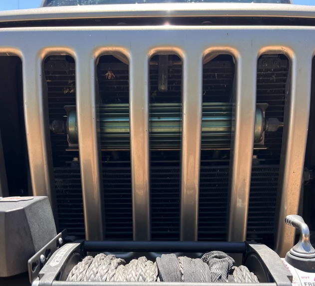

Measure from top of grill slots also all my data is at a 720-750 rpm idle
I have a steering cooler in that area, so I measured from in front of my finned cooler.
Note: I went back and measured from the top where you measured from and the numbers were the exact same compared to the numbers I pulled from lower in the grill.
Keep in mind that we are using different devices, I have two coolers in the grill, and it's 105* and sunny where I am.
I'm using a Mopar fan and Hayden 2791 fan clutch.

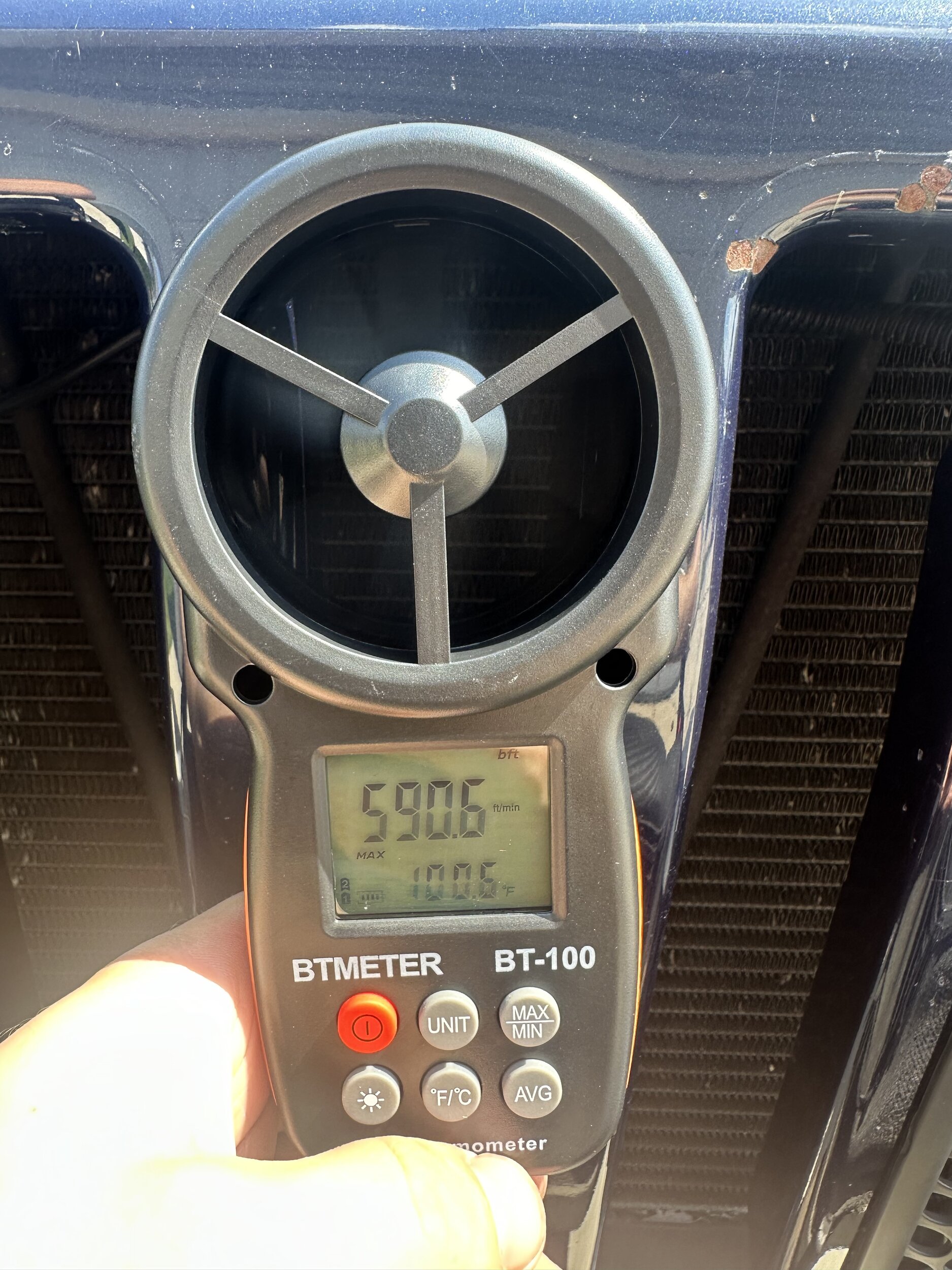

Engine cold: 4.88 mph / 4569 CFM (grill)
Engine cold: 4.88 mph / 4994 CFM (engine bay)
195* Idle: 4.53 mph / 3913-4241 CFM (grill)
195* Idle: 4.53 mph / 3913-4241 CFM (engine bay)
210* Idle w/ AC: 4.53 mph / 3913 CFM (grill)
210* Idle w/ AC: 4.83 mph / 3913 CFM (engine bay)

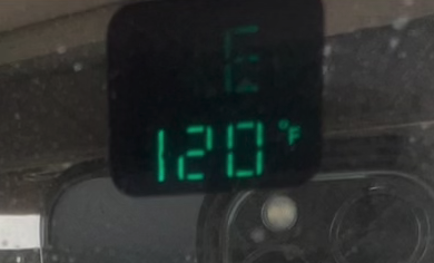

The weather app says it's 105* outside, but the Jeep says otherwise.
