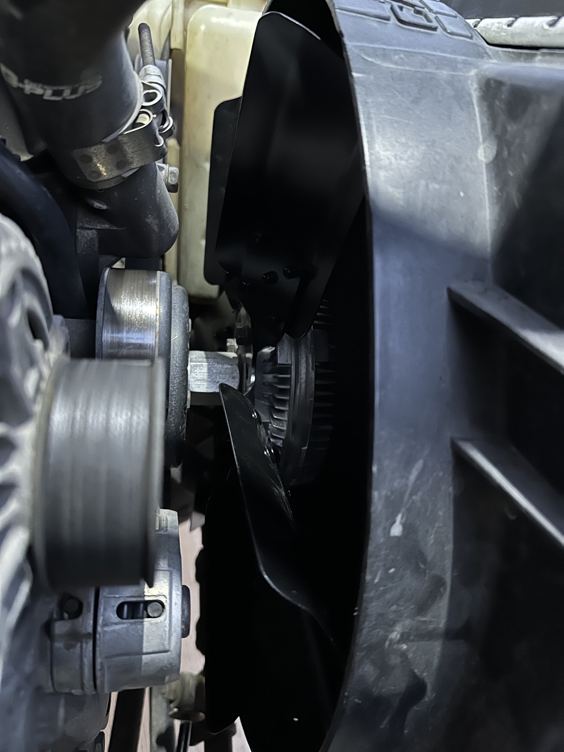

Interesting I did some of my own testing today around 90 degree ambient temp outside. I then idled my jeep for about 45mins after reaching operating temperature with the ac running at full blast I used my obd scanner to measure engine coolant at 226 degrees using a oem radiator and water pump and a Derale 17918 fan and usmw 22159 fan clutch. This might seem high to some but the temp always creeps over time on my jeep at idle and usually into the 230s. As of right now I would say there is minor improvement with this 6 blade fan but I find the it has less turbulent flow but also takes longer to disengage the fan clutch in normal driving situations. Maybe it do to be symmetrical? I ordered a 17919 fan for testing I think with minor fan shroud modifications (shifting mounts to center the fan in it) it will fit without interference and not only provide more surface area for airflow but tighter tolerances at the shoulders of the fan blades resulting in a more efficient setup overall I will report back with more information as I get it.
I install the 19in fan today it fits but I did have to redrill the shroud mounting holes pulls a noticeable amount of air at idle I will update with more testing later.

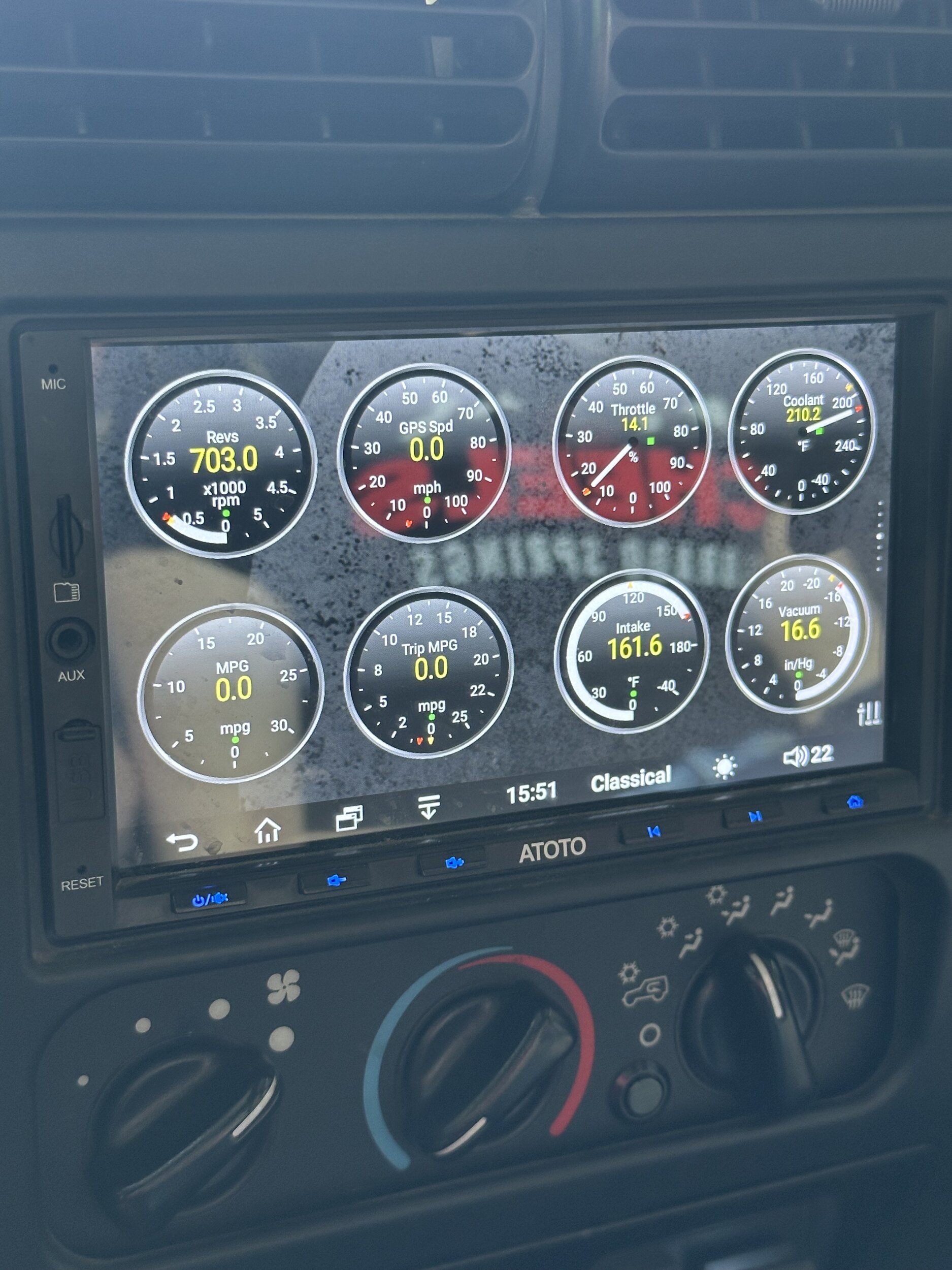

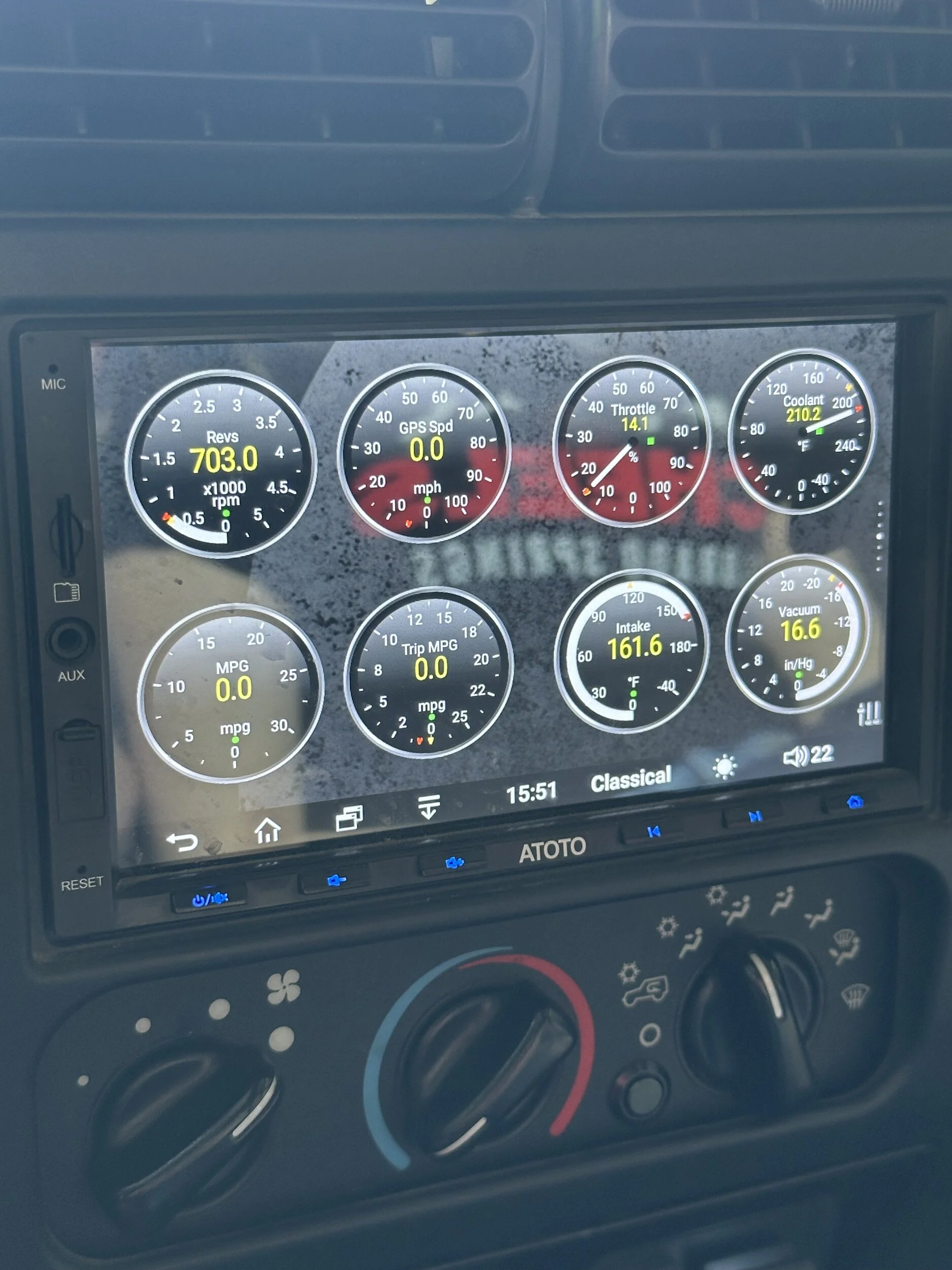

Did some testing today at 85f with the 19in fan and usmw 22160 fan clutch after 45 mins of idling and the ac on full blast she topped out at 210! Massive improvement! so far this is looking promising! Tomorrow will be in the 90s I will post again with this results. Cheers!
85 is not a challenge for a properly operating cooling system.
Did you have poor results at that temp on the stock blades?
Yes on a 90+ day idling with the ac on for extended periods of over 30min I could see temps over 230 I’m not talking about the gauge in the jeep it barely ticks over 210 at that temp also I have all new oem cooling components so not sure where all this extra heat is coming from but it’s definitely there🙃
